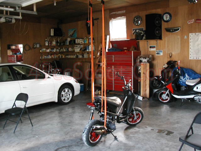

The first step to changing a tire is to get the wheel and tire off of the scooter. You'll need to start by getting the tire you need to change off of the ground at least enough that it spins freely. I am changing a rear tire in this how to, so I hoisted the rear of my scooter slightly off the ground. You may just be able to use the centerstand. You can hoist your scooter up, use a jack and jackstands, or whatever method works best for you. Always make sure the scooter is secured and stable before attempting to work on it.

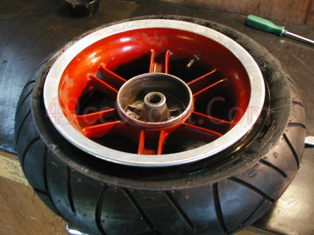

Insert the whell into the tire as far as you can get it. Remember to note the direction.
Use tire irons to work the bead over the rim of the wheel.

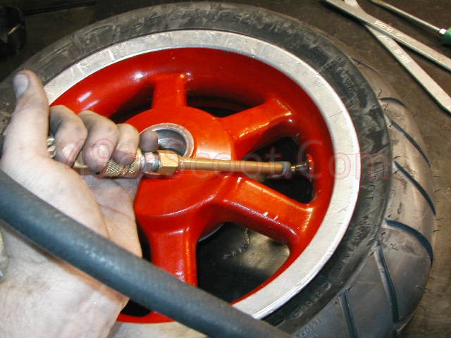

Even though the tire is on the wheel, the bead still needs to be seated. Use an air compressor to pump up the tire with the vavle stem still out. The tire should move to the outer edge of the wheel and seat itself. You'll probably hear a few pops as the tire seats.

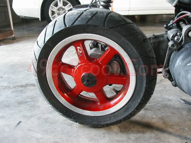

Reinstall the wheel and tire and anything you had to remove to get the tire off.
