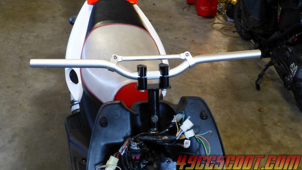

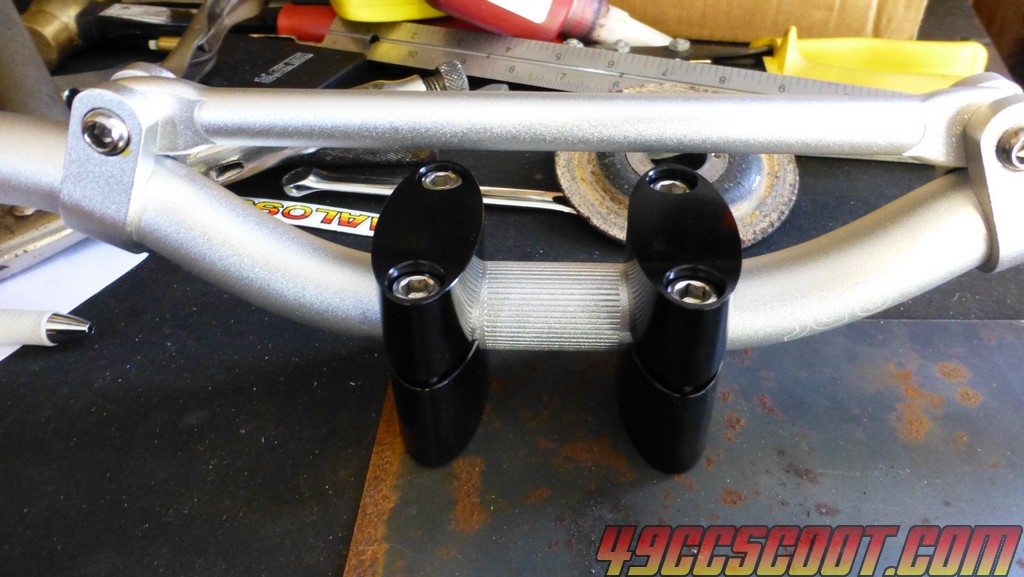

My plan was to use the stock handlebar base/stem as part of a new mount. I thought about buying some tubing to use, but this way would save a little money. I put one of the risers on the new bars so I could get an idea of how high they would sit and where I wanted to cut the stock bars. I decided to leave the stock stem as long as I could. Even with it full length, the new bars would be lower.

I planned to use 1/8" steel as the mount for the risers. I had it around. It seemed a bit thin, but I looked at my Keeway Venus that has a similar setup stock and it's plate is only 1/8" thick. The Venus' plate is stamped with some bends for brackets which would make it a bit stronger though. I may have been better off moving up to 3/16", but I figured I'd try this out and if it feels like there's any flex in it I could add another 1/8" plate. UPDATED INFO : The 1/8" plate has been working without issue, but I would still use something slightly thicker if I were doing it again for peace of mind.
I mounted the bars in the risers where I wanted them, and used that to figure out where to cut the steel. I cut it out with a reciprocating saw, rounded the corners quickly on a grinder, and then marked and drilled holes for the riser bolts to go through.

I then mounted the risers and marked the plate so I could grind away a bit more of the corners. It was a quick job, but still better than it was IMO.
