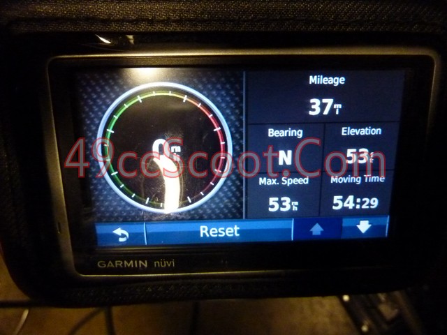

For the first try, I wanted to leave the carb just as I got it. I was definitely thinking the 78 main jet was too small, but it seemed like a good idea to see just how close it may be by doing nothing but transferring the 49cc carb and exhaust onto a 90cc engine. Again, thinking this may be useful for folks attempting a swap of their own. Besides, I knew I had someone to call with a truck for the worst case scenario. As the video and pic will show, I got it up to 51MPH GPS. I believe it could have gone just slightly faster, maybe 1-2MPH, but it was too lean and would begin to drop off after WOT or close for much time. One cool thing is that I did get a soft seize on video for the folks that have never experienced this, or have but didn't know what it was. It was very mild and restarted easily. Sorry the camera gets kinda wild at times, I hang it from the zipper of my jacket so you can see the gauges a bit.  I should also note, I realize it's not the best idea to push it after even a very mild soft seize. As I said though, I knew there was someone with a truck if I needed it, and I never gave it much gas till I was very near my house. I also tried to keep it as brief as I could. For those that don't know, you are likely to have at least some scarring of the piston, rings, and cylinder walls every time the engine seizes, even when it seems so minor like in the video. Heat is causing the aluminum piston to expand more than the iron cylinder, and with enough heat and expansion the friction is just too much and the engine will die out as you saw there. For comparison, a seize or hard seize is when the piston won't budge in the cylinder again, even after the engine completely cools. A hard seize will require engine disassembly and inspection. At very least, you will usually see rather severe scarring. Here's a pic of this cylinder after soft seizing.  Max RPM on that ride was 8,160. I was pleasantly surprised that the CVT setup was reasonably well in tune for stock.

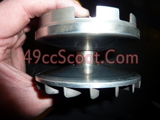

The CVT seems pretty well in tune, as far as weights and the contra spring. That doesn't mean I can't still try to improve the way it feels and acts though. In particular, I had belt travel on my mind for this next mod. This first picture shows how much marker is left on the variator after running the scoot at it's max speed of 51MPH. 5.81mm is a good bit of variator being put to no use on the top end of the gearing.  This next image shows how close the two halves of the front pulley could potentially get, assuming the rest of the CVT tune and engine power allows it. Just shy of 16mm. If you are thinking, "but my belt is 17mm stock", you don't actually have to grab the whole belt when it's at full travel for max performance. On some of my other scoots I've had the outer edge of the belt beyond the outer edge of the variator. Also, in reality most 17mm belts are shy of that be 0.5mm or more sometimes when new. After the belt is worn it can easily get to 15mm, less if you allow it. For these, you should be replacing the belt around 15mm however.  The other side of gearing is your "first gear", or the initial position of the belt that gets you off the line. The easiest way I know of to show you where the belt is at that point is to show you how far up it rides in the rear pulley. Showing how far down the belt travels in the front would be nice, but it's harder to get a picture of. Here's the belt in the rear pulley with everything stock. I've seen worse, but there is definitely room for improvement.  Here's a look at the front pulley in stock form, all the way open.  My first plan of attack involves this little lip built into the variator fan, or fixed half of the variator. As you can see it's roughly 1mm deep.   My thought is that by removing this lip the front pulley can not only open wider, but also close roughly 1mm tighter than before. In theory, that should allow for the belt to ride lower in the front pulley and therefor higher in the rear pulley for an improved "first gear". One would also think that closing the front pulley a little more should allow the belt to ride farther out in it's max "high gear" to increase potential for top speed. The lip can be easily filed off and then sanded to remove deep gouges if you use very rough files. You could also use sandpaper and glass ( as described here) to accomplish the same thing. A lathe, a belt sander, there are all sorts of ways to do it. Just be sure to keep it even so your pulley isn't lopsided. I cheated and used another stock fixed half that I had done in the past... kinda like how the TV chefs pull a dish already cooked from the oven. ;D  Here's a shot of the pulley all the way open after filing the lip off. A little more room now for the belt to start off lower, closer to the drive boss.  Once it was all installed, you can see that the belt is riding higher in the rear pulley.  This image shows that the front pulley will close roughly 1mm more than before for it's max top gear. From 16mm initially, to 15mm now.  Here's a video of the first test pass. Initial launch is slightly improved. It seemed to be struggling a little more with the speed above 43-44 though. The leftover marker now shows 6.6mm of unused space on the front pulley, more than before, but I was not that concerned. For max speed and belt travel, I usually tuck down as far as I can and give the scooter plenty of time to stretch it's legs on flat ground. During the day, when there's usually no one else around to watch my grandmother, I won't go very far at all on a test pass so if I do breakdown I can get back fairly quickly pushing the scooter. I generally get out at night when there's no traffic and no time limit to stretch it out as much as it will go.  Even without any increase in top speed yet, I still felt like I was on the right track and I did see some improvement in acceleration from a stop. The fixed half is not the only part of the front pulley with a little excess material that can keep the belt from getting all the way down in the front pulley or from closing as tight as possible. As you can see here, the movable half has roughly 2mm of aluminum protruding past the brass guide for the drive boss.  I began by filing the center down.  Before filing and periodically during filing, I kept check on the ramp plate and guides on the rear of the variator. You can sit the variator face down on a flat surface. Then put the drive boss in place and sit the ramp plate on top of that. You want to make sure that you don't file so much of the variator's face away that the ramp plate will clear the guides. Try to leave a little extra room, not just right on the edge, to be safe. If the variator and ramp plate separate so much that they are able to move freely from one another, they may not line back up on deceleration easily or at all. I've done this before and ended up with variators that constantly break the plastic guides on the ramp plate and damage rollers and at times even stuck in high gear.  I went a little farther than just filing the face flat. When the center of the face is flattened out, sometimes you end up with an odd spot in early acceleration. Flat filing creates a very abrupt transition from flat to angled surfaces. I sanded and filed to smooth out that transition better so there's less of an obvious ridge on the face.  I left a bit of a lip, but not much. As I noted earlier, trying to stay on the safe side and keep the vari and ramp plate in line with each other.  While I was at it, I opted to smooth out the transition on the fixed half as well.  You can see there is even more room for the belt to get low in the front pulley.  This is even more clearly demonstrated by how far out the belt can ride now in the rear pulley.  Now the two halves can close up within a bit over 14mm of each other.  With the variator marked again, I went for a second quick test pass. The video didn't turn out so great, but you aren't missing much vs the first one here. Takeoff was improved slightly more. Top speed was 48MPH this time. Upon disassembly, I found that I had still less belt travel than last time, even though I was going a little over 1MPH faster. Seems a little counterintuitive, but that's the result.  Once I could get out for a few minutes more, I took a very brief ride so I could try full tuck for a slightly longer distance. Once again, I saw the 51MPH top speed that I'm getting very accustomed to. Max RPM showed 8,800.  Belt travel increased a bit from my shorter run, but it's still a little over 1mm less travel that I got before modding.  When I took the last ride, I placed the GPS and the GoPro under the seat together. I thought maybe I could get a video of the GPS recording the speed to show you, and I for that matter (can't see my speedometer at night), how it was doing. Seemed like a good idea, but the video turned out to be horrible. The camera was moving all over the place, probably because I hung it from that "rubber band" that attaches to the bottom side of the seat so it bounced and such. Definitely not good enough that I wanted to post it. It did at least allow me to see, in a bouncy blur, my speeds creeping up. It's not terrible, but it has lost a little acceleration from about 45MPH to max.  To sum this modding segment up, if you go back and look at the pics of the belt in the rear pulley at start and finish, you can clearly see that I made an improvement in the "first gear" ratio for the better. The more free feeling caused by the belt not binding as much at a stop or on launch also makes it feel a little better to pilot. You can also see that I clearly have made the front pulley's potential for closing greater, however I have not recognized this potential. In fact, I have made the actual belt travel less in top gear. Even given that, I managed to retain the exact same top speed. The only unfortunate part being that the last few MPH are a little harder to come by. For real world riding, most people won't be full tuck for very long, so I feel this to be only a minor setback. Even though the results don't show any great progress, I do feel like this mod is a good one. I have done this same type of mod, mostly on aftermarket variators however, in the past with much better results. I believe the reason I have not seen really positive results on the top end in comparison to past endeavors is the difference in engine power of this project and final drive gearing vs the others I have tried. I generally have started off by getting the engine tuned where I want it, and then moving on to fine tuning the CVT. For my own projects, I know where I want to be and I take the fastest path there. In this project I am trying to take some steps as I feel others may and wanted to try this early on because it is a free mod assuming you have a file and some sandpaper. My theory is that the scooter in stock form simply doesn't have the power to pull these gears with my weight significantly faster on flat ground. I do believe it's possible to go faster with the stock horsepower and gearing, but not by a great margin. The potential is there to go faster based on what we've seen here. One bright point is that I did the same top speed with 1mm less of belt travel. The CVT is operating in the proper RPM range for the stock engine. I think those facts support my thoughts.

Before I even get started, I am sorry for the sound in some of the videos. It is out of sync in certain vids. I spent a lot of time on them and really wanted a good product. I'm disappointed to say the least. I viewed them numerous times before exporting the files. It seems PowerDirector9 has some sort of output issues with synchronizing sound and video. Again, I apologize. I have swapped out the audio on the worst of them. Rollers, Sliders, And ModsIn this segment, I'm testing roller weights against slider weights as well as seeing how the stock variator stacks up against the previously modded one. I did all of the swaps below and made all of the test rides in a very short time period on exactly the same stretch of road. This was done in an effort to keep results as accurate as I could by reducing variances in ambient temperature, wind speed, etc... Hope it helps! The videos in this segment are edited in the best way I could think of to really show the effects of each weight change or modification. It's sort of like watching the scooter race itself. Take note of landmarks along the way for an even better idea of which setups work best. You may notice that some of the quicker or faster setups at the end aren't winning the race all the way through. Roller Weight ComparisonThese runs were made to show the differences in light and heavy roller weights. I actually did these runs last, after realizing it won't do much good to show sliding weights with nothing to compare to. I only tried 5g and 7g rollers, because I was flat out of time to work and ride at that point. The lighter 5g rollers clearly have an advantage in early acceleration, but as you can see, the heavier rollers do start to catch up a little, exhibiting the same max speed over the distance, and I feel that they would prevail in a longer race over a flat surface if I stayed tucked down. I have been using 6g rollers, which I feel was the right choice. They provided good upper MPH performance as well as good starting acceleration. Sliding Weight ComparisonFor these tests, I'm using Dr Pulley sliding roller weights (sliders). Other manufacturer's do make sliders. I have a set of non-Dr Pulley sliders and they function much the same. The main difference I have witnessed is longevity. Dr Pulley sliders seem to be more resilient to abuse than the off-brand units. The image below shows the difference in a roller (left) and a slider (right). The specialized shape of the slider allows it to provide both increased acceleration and top speed potential.  For those of you unfamiliar with installing sliders, these pictures should show you how they are to be installed. It is very important to install sliders properly. Degraded performance or possibly even damage to the sliders or other components could occur if they are not correctly installed.    I only have 5 gram and 7 gram sliders at this point. The weights were staggered, as shown below, to achieve the effect of 6 gram sliders.   The testing... The 5g and 6g sliders are pretty clear winners here. Excellent acceleration and the same top speed. Again, as with the rollers, I feel that the heaviest sliders may show a slight advantage over a long flat stretch. The lighter sliders will function much better for daily use, providing quicker starts and more ability to maintain speed on hills and against the wind. Rollers vs SlidersNow that we have an idea of which sliders and rollers perform the best, we can compare their performance. It seems to me that you can make rollers accelerate off the line as well as sliders or perform at speed as well as sliders, but not both at the same time. The design of slider weights give them a definite advantage. There's not a huge difference in the two, but I'd say that's a decent difference for the cost of sliders. I paid about $25 shipped per set on eBay for these 15x12 sliders. To their benefit, roller weights can be had at much lower prices. Due to the lower cost of rollers, they can be a great tuning tool. Rather than buy many sets of sliders at $25 or so a set, you can usually find a "tuning set" of roller for just a little more that includes a wide range of weights. Once you get the weight dialed in with rollers, the slider you'll want to use will probably be the same weight or possibly up to 20% heavier I'd guess. The great advantage that sliders have over rollers that you can't see in these vids is that they tend to greatly outlast roller weights. I've used the smae sliders seemingly forever in some of my scoots without issue. Rollers tend to flat spot over time, which severely degrades performance. If you ask me, sliders are a clear winner. Variator ModsWhile I was testing, I wanted to sort of revisit the previous mods that I did to the variator and fan. For more detail on the variator mods shown and tested, see my previous update. I marked the variator with a Sharpie before every test. Below are the results of how much belt travel was left on the variator after each pass as well as the MPH achieved as shown on my GPS. Fixed face = variator fan. Movable face = variator. Description | Remaining Marker | Max Speed | Stock Fixed + Movable, 5g Rollers | 6.97mm | 49MPH | Stock Fixed + Movable, 7g Rollers | 6.50mm | 49MPH | Stock Fixed + Movable, 5g Sliders | 6.33mm | 50MPH | Stock Fixed + Movable, 6g Sliders | 5.44mm | 50MPH | Stock Fixed + Movable, 7g Sliders | 5.30mm | 50MPH | Filed Fixed + Stock Movable, 5g Sliders | 5.81mm | 50MPH | Stock Fixed + Filed Movable, 5g Sliders | 5.49mm | 51MPH | Filed Fixed + Filed Movable, 5g Sliders | 5.39mm | 51MPH |
One thing that the vid or the numbers don't illustrate is belt slip. I found that using the better performing 5 or 6 gram sliders along with the modified drive faces added belt slip. This did not appear to be a problem with the roller weights. In addition to the videos show here, I tried 6g and 7g sliders with the modified parts as well. It was less apparent with the 7g sliders, but belt slip was present with all of them at certain points. You can actually see right where it happens in the image below. Notice the area polished by the belt slipping as it transitioned from the flatter center section into the outer portion of the face. I believe this could be remedied with more time and effort exerted in blending the angles of the fixed and movable halves.  Here is a quick video where you can clearly hear the afore mentioned belt slip. This was with 6g sliders and both filed faces. Another thing that you can't see in the videos or the figures is the feel of the transmission with the modified faces. At idle and lower RPM, until the clutch engages, the engine is free revving with the modified drive faces. With the stock parts, the belt sort of binds in the variator so you don't get the full feeling of effect of later engaging clutch springs. Conclusion / My ChoiceSo out of all of the things tested, which did I decide to stick with? I chose to go with the stock variator and fan and 6 gram Dr Pulley sliders. Yes, a couple of setups showed a 1MPH gain over this one. Yes, I recorded more belt travel with a few other setups. Overall though, the 6g sliders coupled with the stock front pulley parts were as quick as any other setup under the tested conditions. Also remember that I took a 7 mile ride with each of those setups. All over the exact same course. The 6g sliding weights and stock parts performed on par with any other setup under those conditions. It was a very close call between the 5g and 6g sliders though. As you can see in the mod video, I was initially planning on using the 5g sliders. I feel that the 5g sliders would be a good choice if I were in a hillier area. The 5g sliders also show a benefit against the wind. The 6g sliders keep the cruise and max RPM just a tiny bit lower though. I felt like that may translate to very slightly improved fuel economy and engine life as well as possibly a higher max speed if I were to stay tucked for a long time or catch a tailwind while riding. If I had the option, I'd go with 5.5g sliders. The main deciding factor for choosing the stock parts vs filed was belt slip. While not drastic, I felt it may have a negative effect on drive belt life without showing any significant gains. Of course each rider must choose the combination that works best for them. Some riders will sacrifice more top speed for more top end. Others will be willing to give up some acceleration if it nets another MPH or two. Rider weight, engine horsepower and torque, CVT setup, gearing, tire size, and other variables will all change what works best for each scooter. I can show you how these things work for me, but only time tuning and learning what you like will allow you to choose the best setup for you. After swapping back to the stock variator and 6g sliders, I took the scooter for a ride to get a gas mileage figure. I filled up at 32.31 miles with 0.793 gallons of fuel, which is 40.74MPG. I have seen 45MPG in the past. I was riding just before a storm blew in and I believe fighting wind associated with the storm led to the drop in economy. It should be about the same as before, around 45MPH if I had to use less throttle without the wind. It reached 51MPH with me tucked, once again. I feel like I just need more power and it will easily give me more speed at this point. This seems like a good time to make a note about RPM. Unfortunately I kept forgetting to read the max RPM that the tach displays after the ignition is shut off to provide that data. What I can tell you after making so many trips with all sorts of weights is where the engine performs the best. With my current setup, best power is found from 6,000-8,000RPM with the absolute peak being from 6,800-7,800RPM. It will make power over 8,000RPM to help reach higher speeds, but those are the peak figures as best I can tell without the use of a dyno.

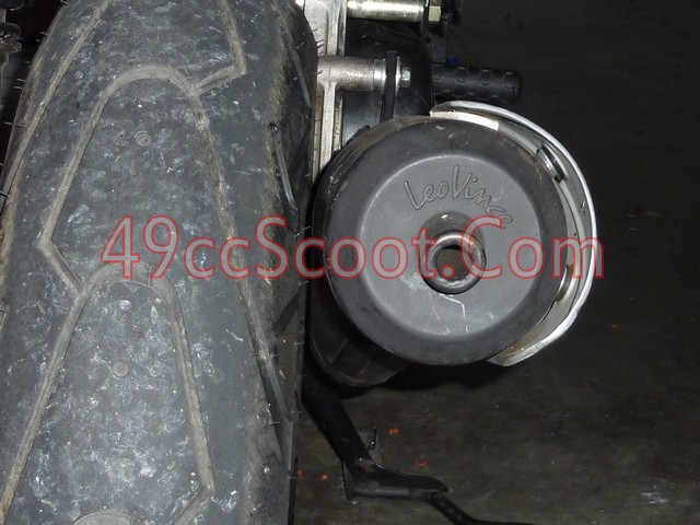

Leo Vince ZXNext up, I installed my Leo Vince ZX exhaust. This pipe was purchased for a 100cc Yamaha Aerox. It is not the more common 50-70cc version. I have removed all restrictions, and then some. Details on the modifications to this pipe can be seen HERE.  This exhaust only needed a few washers stacked up to space it out. Otherwise installation is pretty simple.  Here's a vid with the sound revving and riding. The silencer has been repacked, but it's pretty similar to original in sound right now. The volume level is much louder than stock or the Phongeer, but not obnoxious. It definitely attracts more attention though, which can be good and bad. I increased the main jet to a 92, just one size up from what the Phongeer exhaust liked. Otherwise it was good to go. I kept the 5g sliders in place, knowing this exhaust has a higher powerband. I went for a 50 mile ride to evaluate the change and enjoy a bit of nice weather this afternoon. Acceleration is noticeably slower than with the Phongeer pipe, but still greatly improved over stock. Normally I would try to fix that with lighter rollers or sliders, but read on. Cruising speeds are good, in the upper 40s. Here's the bit that surprised me. Max speed was 53MPH. That's right, exactly the same as with the Phongeer pipe. Unlike the PG pipe, I had to wait a little longer for the last 3MPH. It got to 50MPH easily and would even cruise right around there at times. Max RPM was somewhere around 8,700-8,800. I know that this pipe makes it's max power nearly 1,000RPM higher. The reason that I didn't try to get the revs up is that I just don't think this engine likes to rev that high. The stock port durations are so mild that I don't believe it can make the best use of what the ZX exhaust has to offer at this point. With any exhaust, the power drops off above 8,500-8,600RPM. Unfortunately this mismatch and the higher powerband of the ZX makes it less pleasant to use than the Phongeer pipe which has a much broader range and is better suited to the mild cylinder. I have used this pipe on other motors, so I know it's got potential, but I think we're just seeing the importance of matched components rather than random part swapping for what is the "better" part. Fuel economy on this ride was 41.5MPG. I was quite hard on the throttle and dealing with crosswinds for a bit though.  So, disappointing as it may be, this pipe didn't function as well as the Phongeer. On top of falling short on power, the additional noise seems unnecessary when you don't have the horsepower to back it up. This can be a good pipe, but it's not if the cylinder is as mild as this one. That said, it's still a great improvement over stock.
