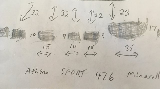

Athena Sport Port map Numbers next to ports are height of ports

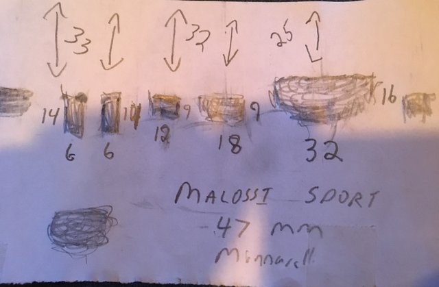

Malossi Sport Raised exhaust port just over 1 mm 9500 -9600 rpm peak
