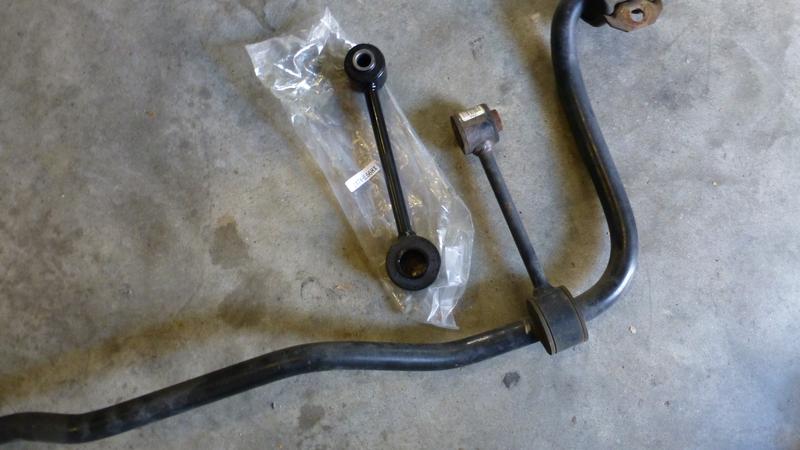

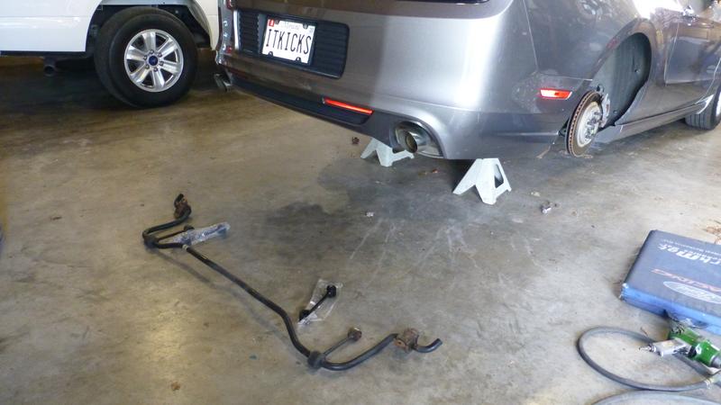

Crawled around under my mother's Mustang. It has had a knocking noise on bumps for a while. I thought it was probably exhaust hitting something. Looks like it's the rear sway bar bushings. If it were a GT I could get an Energy Suspension kit for $40 shipped or so. Being a v6 with a 22mm sway bar, I guess I'll end up at a dealer parts counter. Didn't even see them listed on AutoZone's site for the smaller sway bar.

Finally replaced the stabilizer bar links on my mother's Mustang. No more knock. I ran it up to the speed limiter and took a turn at about 90 strictly for test purposes. Had a farmer pull out of a driveway in front of me at over 100. Checked the brakes for her too. I like to be thorough. This is all made up of course. I would never actually drive in such a manner. Turn those reds and blues off.

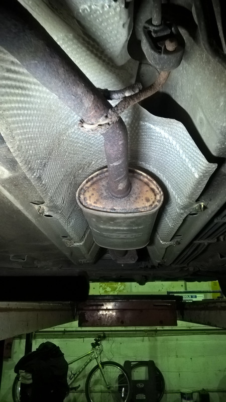

Today I bodged some clips on the heat shield after it had driven me mad rattling all the time from when I went through a big puddle in the floods. I should have known it was there as the river always bursts its bank where it bend 3 ft from the road , wont forget again in the future.
