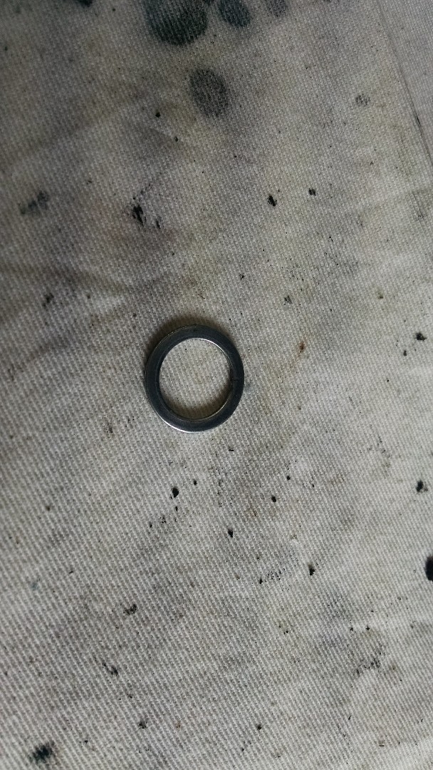

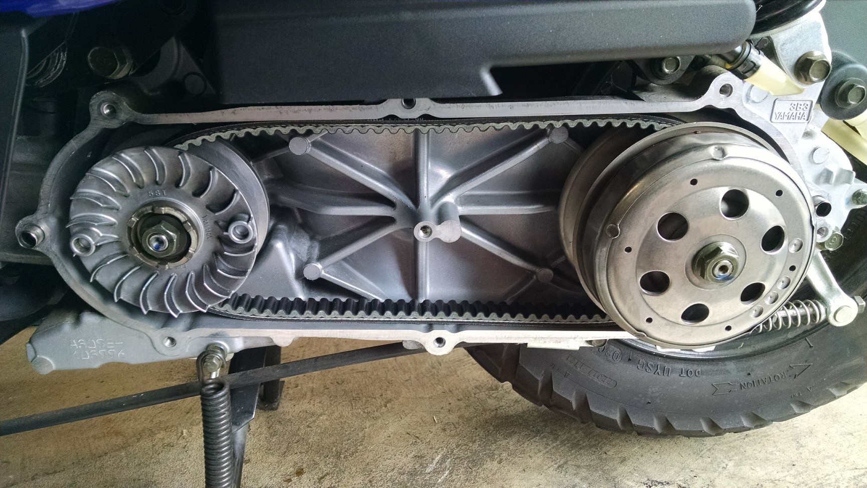

Today, I cracked open the variator cover and found quite a bit of belt dust. I was figuring on replacing the belt anyway since it is over ten years old. While I was in there, I cleaned everything up, replaced the belt, greased the secondary sheave according to the service manual, removed the restrictor washer, and put in a set of Dr. Pulley 5 gram slider weights. I noticed that the outer edges of the front pulley halves were kind of rough and sharp, so I knocked that down with some real fine sandpaper and a scotchbrite pad. I took a stab in the dark with the 5 gram sliders, I'll see how they do as they break in, and probably experiment some more with it later. I gained about 3 Mph for a new top speed of 43.2 according to my GPS. Actually, I got it up to 45.9 with a good downhill run, but had to let up for a curve. I don't think I hit the rev limiter for either of those, I used to be riding the rev limiter at just a little over 40 mph. It would be nice to see a bit more oomph in the middle of the range. I can never seem to remember to take pictures as I am doing things, so this is a bit light on detail. Getting ready to take the clutch assembly apart, I kept envisioning a foot slipping off and having the clutch hit me in the face 🤕... Got rid of the restrictor washer... Everything reassembled and torqued to spec, left the cover off for the test ride... Dammit, I forgot that those locating pins were still in there when I went or the test ride and lost one.
Post by Happypancake! on Jul 15, 2018 16:24:14 GMT -5
Watch out when torquing down the variator w/ the washer removed as you can mess up the crank splines. I move the washer to the outside just under the nut to prevent this.
Pull off the metal grid of the air filter. It will give it a bit more.
GET a tach. I makes tuning easier.
When u can, GET rid of the knobby tires, I put Michelin Boppers on 130/90 rear. 45 psig.

Thanks. I'm going back out there right now and put the washer behind the nut before I forget about it. The air filter is one of the things on my short list, was kind of thinking that the metal screen didn't need to be there. Will look into getting a tach, need to study up some more on variator and clutch tuning before I go any farther on that front.

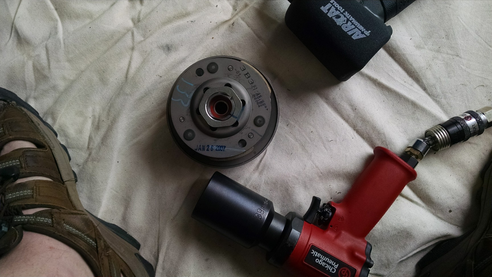

Oh I nearly forgot that air gun I see in your garage !!! smashing for wheels and truck,s scoots need a little more finess we have to many stripped cranks to list thanks to those beasts.
Post by bbrins on Jun 5, 2022 10:59:04 GMT -5
I only use the impact for disassembly, and only on the middle setting(or lower) for something small like a scooter, if it needs more oomph than that, I use hand tools. I do use it some for assembly too, but only after starting fasteners by hand, and then just use it to run it down to snug something up while holding things together with my other hand, not torquing anything down with it, on a scooter anyway. On something like a scooter, I'm only using it to remove things like a variator nut, clutch nut, for removing wheels, things with larger hardware. I wouldn't dare use it on some of the other bitty hardware holding these things together. If your stripping crank threads on disassembly, it's most likely from someone hamfisting the previous assembly, probably from cranking crap down with an air gun, or just over-torquing with hand tools and galling the threads.
