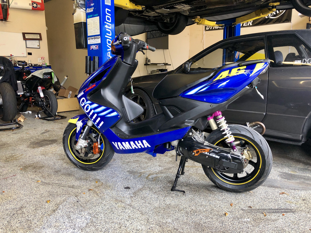

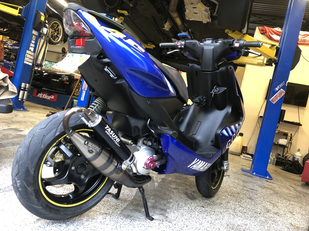

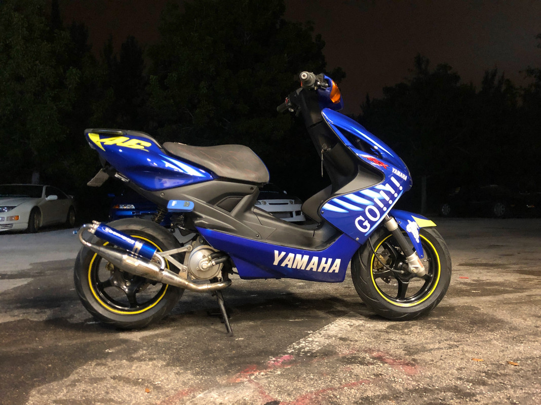

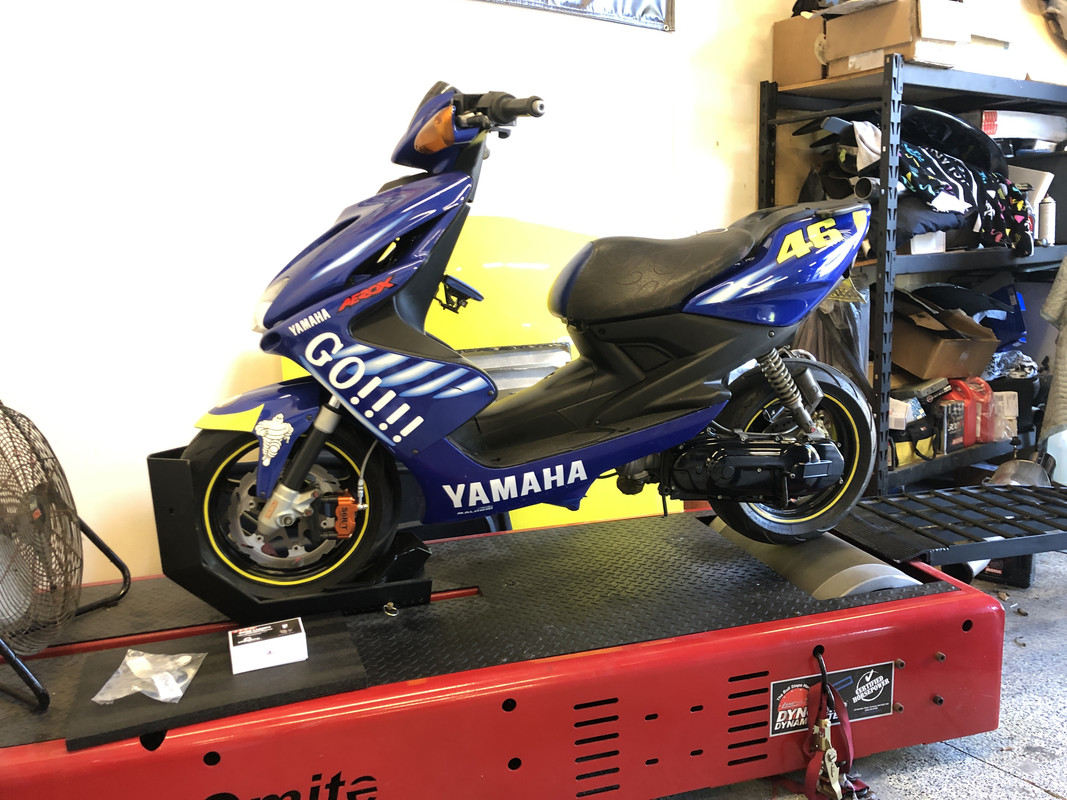

well....... I GOT AN AEROX!.....in the USA!. heres some pics....I will be sticking to a circuit oriented build with this one as i already have a drag scoot. check it out! already started modding with a nice exhaust detail and cvt tuning on the dyno.....its a 70cc Metrakit pumping 12whp at this point.

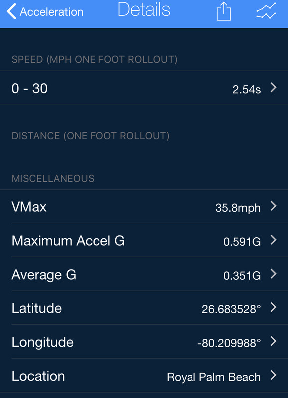

Yasuni City16 pipe installed! Back on the Dyno and hit 16hp!! Very happy with this setup. 0-30mph In 2.5 seconds! Now we are getting somewhere.

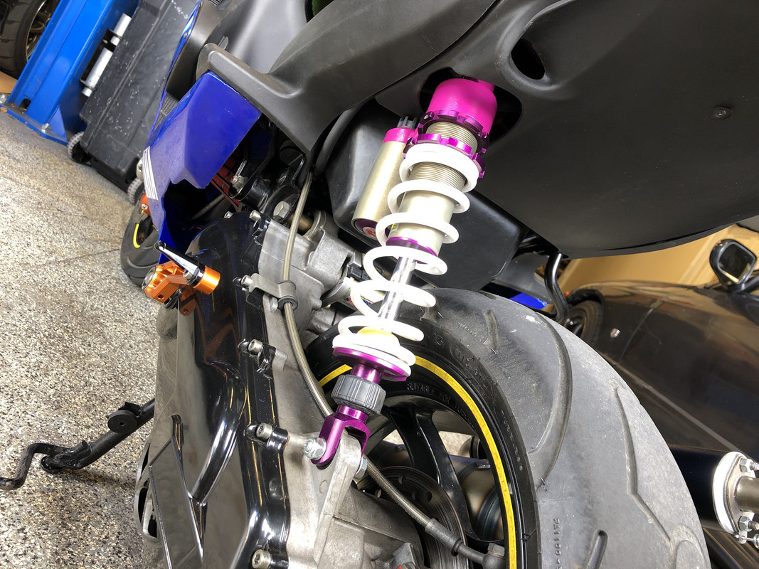

New rear shock from Malossi came today! No more pogo stick!!
