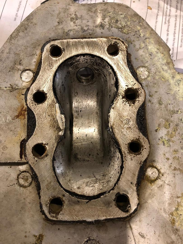

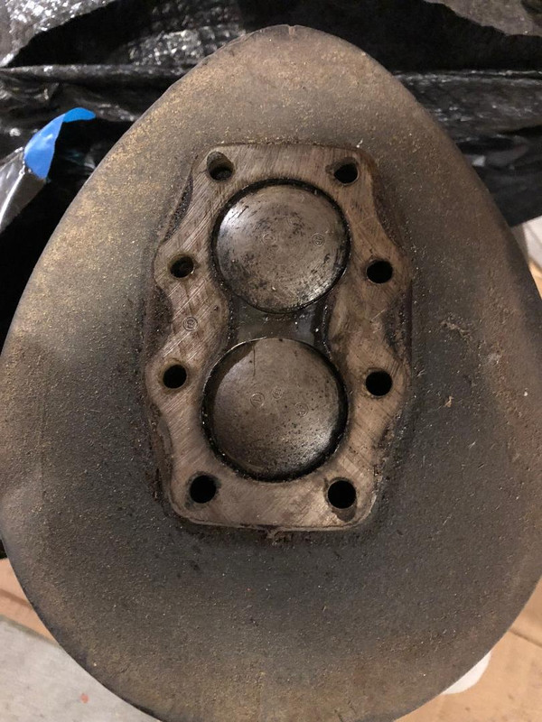

Post by houseoffubar on Jul 28, 2019 16:03:50 GMT -5
This is my 250 "Twingle". I pulled it apart to check the condition and clean her up. Motor looks great inside, now just have to build a chassis to put it in!
The port timing, like all two strokes is controlled by the pistons, but this is crazy, the rear cylinder handles intake, the front cylinder exhaust, with a shared combustion chamber and shared crankshaft. the real beauty of these is the pistons are timed to completely shut off the intake and exhaust, so no scavenging or exhaust waves to consider (no expansion chambers here) this limits horsepower, but gives the bike a solid 70MPG and mush cleaner emissions, as well as a 2 stroke with a four stroke like power delivery, and very reliable, long lived motors.
Post by aeroxbud on Jul 28, 2019 20:36:49 GMT -5
The port timing, like all two strokes is controlled by the pistons, but this is crazy, the rear cylinder handles intake, the front cylinder exhaust, with a shared combustion chamber and shared crankshaft. the real beauty of these is the pistons are timed to completely shut off the intake and exhaust, so no scavenging or exhaust waves to consider (no expansion chambers here) this limits horsepower, but gives the bike a solid 70MPG and mush cleaner emissions, as well as a 2 stroke with a four stroke like power delivery, and very reliable, long lived motors. That's crazy. Almost like a Honda NR750 piston! nr750-5 [/url]
