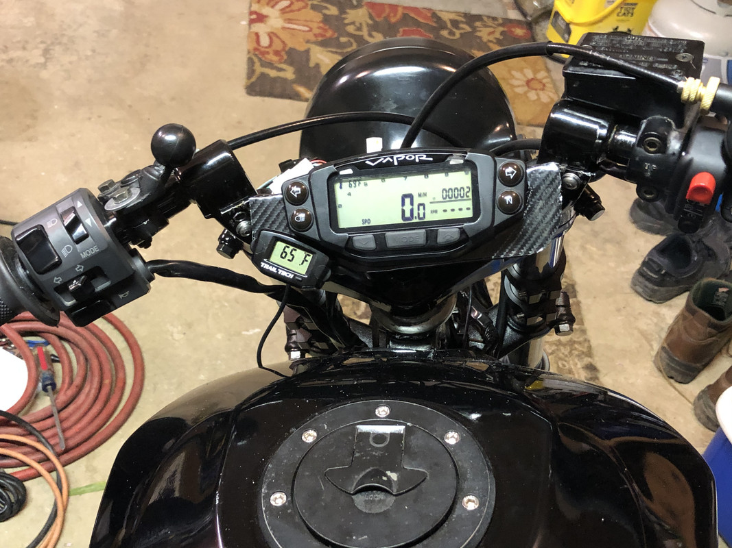

Post by ryan_ott on May 3, 2020 0:55:18 GMT -5
Worked out a mount for the TrailTech Vapor. Now if I can figure out why it cuts out when the engine runs I’ll be set. That’s with it connected to nothing but the CHT leads. The ignition recommends non resistive plugs but the gauge obviously wants resistive plugs so I’ll try some shielded leads first. Got a trip to the hardware store in. This bike gets more looks then a $2 whore in the daylight. Everyone turns to look at it. pandora net worth
Post by ryan_ott on May 9, 2020 18:31:57 GMT -5
It took some effort during the lockdown to get the registration completed but it’s done. Finally road legal, well minus the emissions... Get the Vapor wired in, swapped to resistive plugs and that cleared up the issue with the gauges cutting out. Took it for a quick rip to calibrate the speedo and I got it darn close the first try. I had an issue with it breaking up at higher rpm’s with and without the resistive plugs. Might just be temperature related as it doesn’t do it as much on warmer days. I want to get this running well and don’t want to chase my tail with carbs so I ordered a replacement set. They had some corrosion that was repaired some time ago with epoxy so best just to start fresh. Here is a little video you can clearly hear it.

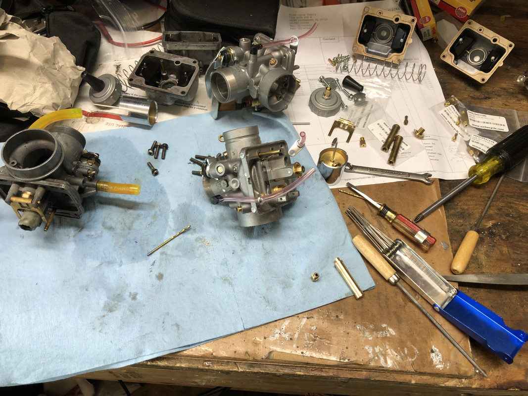

Post by ryan_ott on May 18, 2020 19:45:36 GMT -5
Well I finally got both carbs and jets. Originally only received one carb so had to wait again for the other to arrive. Swapped them out and bench synced them up. They were a pain to get the mixture and idle initially set due to the location of mixture and idle adjustments. Currently 35/185 with a drilled air jet, different needle and modified needle jet. The cylinders used to be about 30 deg apart CHT but now are within 6 deg of each other. Part throttle cruise and off the pipe is around 280-300, on the pipe continually and getting aggressive with it it’s around 320-350. Might just up the main one size. It surely is a fun bike to ride, might not be the fastest but it makes a lot of smiles... and probably hearing damage in due time. I started to wear ear plugs when I take it out.
