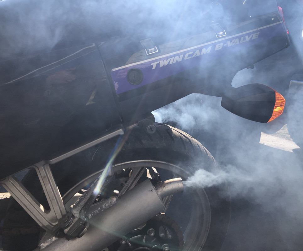

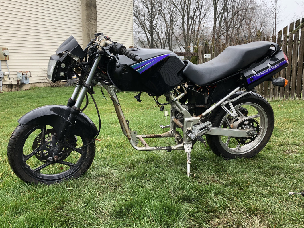

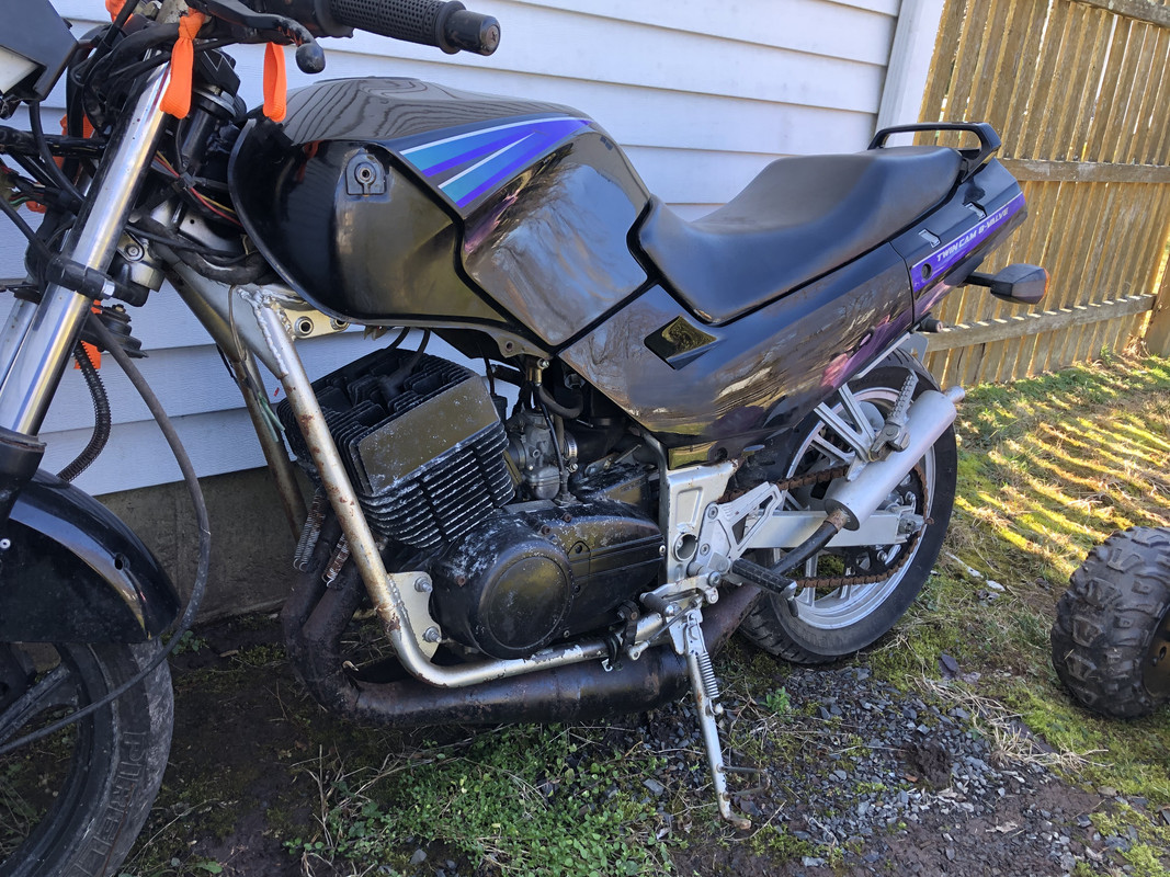

This is the start of a thread that may be dragged out for awhile but hopefully not. Yamasaki The name came from oldgeek and will stick for eternity. This bike was gifted to OG but was sitting unused and it was offered to me, this was an offer I couldn’t turn up so I made the 1300 mi round trip from PA to NC to pick the girl up. In plain form it’s a 1994 Kawasaki 250 with a heart transplant from a 1974 RD250 completed by none other then 190mech with a beautiful set of peace pipes that sound amazing. Maybe he can add some particulars of the original build as I’m not completely aware of when it was built or the specs. It’s in need of some love as it’s been sitting for awhile but trust me it won’t look the same when I’m done with it. My plans for it are the minimalist approach... strip the plastics, source some 17” spoked wheels for modern rubber, GSXR 600 or 636 front end, clean and paint/powder coat from top to bottom, make a seat pan/cowl, round led headlight, update the points ignition to electronic and source a tank that looks the part. Maybe a few other touches here and there but for the most part that’s the plan. The frame is Kawasaki but I’ll try to keep most other parts Yamaha, why... I have a thing for them. To be continued...

Hah!! What a cool piece! You always do good work. I can't wait to see what you do with this. How's it run so far?
Post by ryan_ott on Mar 9, 2020 5:32:36 GMT -5
I haven’t done more then just start it and see that the battery charges. It’s been sitting so the tires are dry rotted and the calipers are sticking so I can’t take it for a spin until those are sorted at a minimum. It really is a cool piece of history and I feel very fortunate to be the new owner but I can’t wait to get it on the road.

Pulled her out to get some cleanup started. I picked up a clutch cover gasket to get that sealed up and a carb kit to get it freshened up. Just plan on wire brushing the engine, side covers and pipe. Black for the engine and if the pipes clean up well probably just raw or high temp clear. I’m just going to pick away at little things here and there due to what I’ve got going on at home. No manufacturer will give me specs for wheel width for any spoked wheels I’d like to use so either ditch that idea or just get them and hope I can get them to work. More to come..
