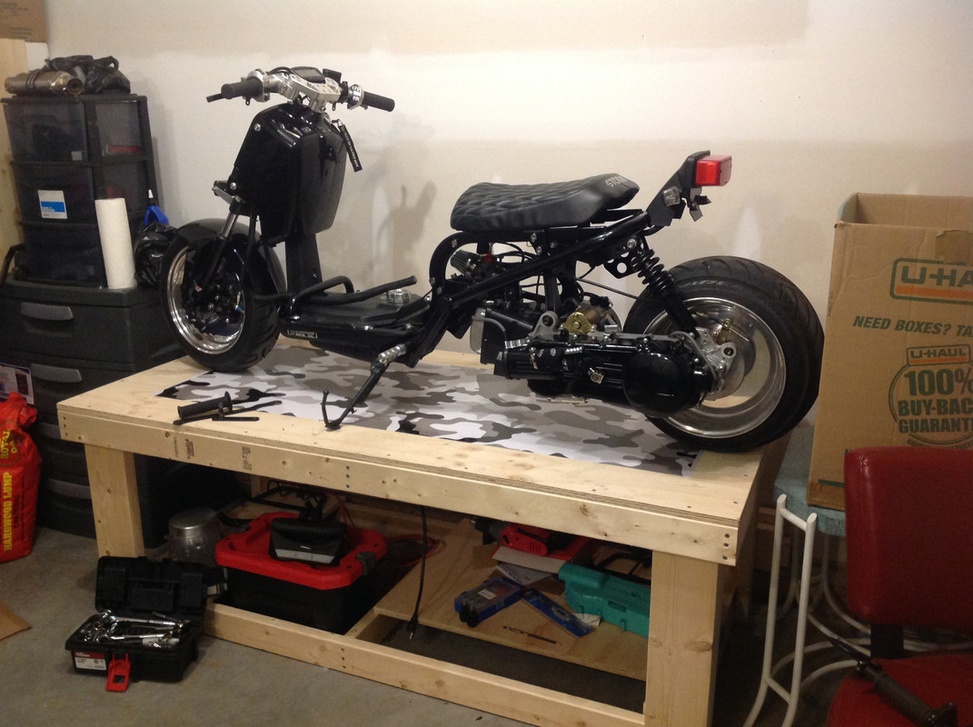

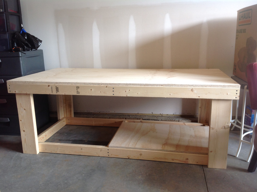

I've been wanting a table/platform to build scooters on but couldn't find one suitable for my needs. So, I made my own. I'm no carpenter, but it was easier than I thought. Got the wood from lowes and they also cut all the pieces.
Post by geoffh on Apr 13, 2020 15:28:48 GMT -5
If the titles the question that,s a bit personnel,but I like your table ,how are you getting the scoot up there??
Post by oldgeek on Apr 13, 2020 16:31:55 GMT -5
I've been wanting a table/platform to build scooters on but couldn't find one suitable for my needs. So, I made my own. I'm no carpenter, but it was easier than I thought. Got the wood from lowes and they also cut all the pieces.  looks nice! Get yourself some of the cheap (closeout) peel and stick vinyl tiles for it, you will be glad you did.
Post by jbjhillbilly on Apr 13, 2020 22:29:02 GMT -5
That’s a solid build. I’d toss a few of I-bolts on the top for your tie-downs, and maybe think about something to chock the front wheel.
Man I wish I had room for one...

Post by sToRm on Apr 14, 2020 9:10:33 GMT -5
If the titles the question that,s a bit personnel,but I like your table ,how are you getting the scoot up there?? Geoff This table was mainly going to be used for frame up building, but I will use a leftover 2x6 as a ramp.

Post by sToRm on Apr 16, 2020 14:51:04 GMT -5
Well, it didn't collapse or creak even with me sitting on the bike. I beveled the table top edges with an angle grinder and sandpaper wheel lol. Also attached a power strip on the underside of the table. My back is very grateful.

Post by jbjhillbilly on Apr 16, 2020 22:02:26 GMT -5
I like the power strip idea. Totally stealing that.
Magnetic trays are a gift from God, and a small lip of 1/4 round on the edge will help keep things from rolling off.

man , I like the table just fine . nice table, sturdy, good height , . I was fine until I saw the scooter up there . hit me like a brick wall . jealous as hell . it's like how did I never do something like that .
Post by fuzzyruttin on Apr 17, 2020 5:25:08 GMT -5
Nice job. Another suggestion, add some locking caster wheels so you can roll it around for 360 access.

Post by sToRm on Apr 17, 2020 8:07:04 GMT -5
Nice job. Another suggestion, add some locking caster wheels so you can roll it around for 360 access. The build plans for this table used 5 inch locking caster wheels, but I'm looking for some smaller wheels that can support the weight.
Post by oldgeek on Apr 17, 2020 8:43:55 GMT -5
Harbor Freight has a pretty good selection of casters.

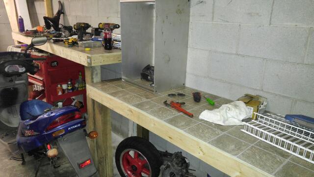

Post by jloi on Apr 18, 2020 0:28:53 GMT -5
waaait. I put caster wheels on mine. started out with I think 3" . they got flat , wouldn't roll. I know I have at least 4" now if not 5" from Northern tools. my table is probably heavier though; drawers and shelf below. ton of stuff on it.very heavy table -relatively . double 2x4 legs all the way around ,5/8" top like yours . I'll get pix in a bit .
