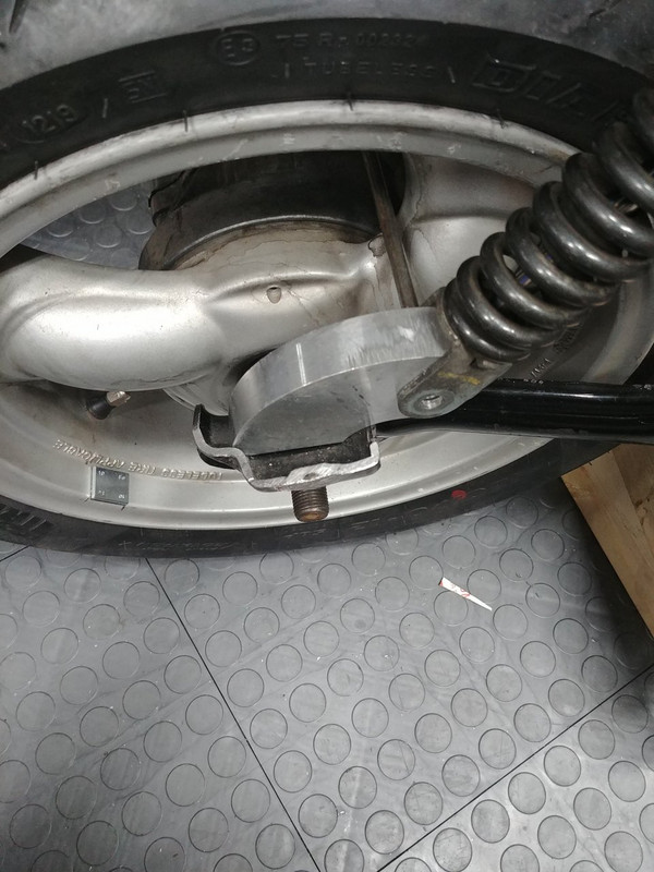

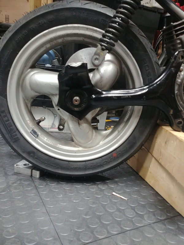

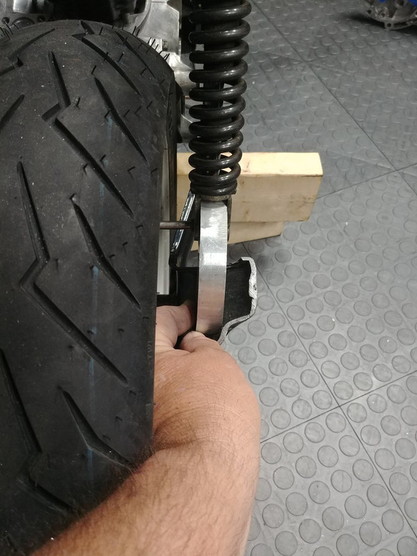

Over the last few days I have spent many hours on various areas of this project. I got frustrated to no end trying to make a part for the motor on the lathe. So I gave up for now because the lathe is simply too small to do the job. It is a fairly simple job but the lathe chuck will not open far enough to do it. I moved on to the right rear shock mount, because it is so important to this build to get it worked out. I started with the donor swing arm looking like this. After a lot of failed ideas I think I came up with a winner. I chopped a few unneeded pieces from the swing arm and made up a shock mount tab from a rather large chunk of aluminum I pulled from the scrapyard haul the other day. I still have to drill the tab out and install the shock mount in it and come up with a way to mount the tab to the swing-arm. Then I still have to make some kind of adapter for the front of the swing arm where it mounts to the cases.Overall I think this route is easier than just building a swing-arm from scratch like I was thinking at one point. The place doing the wheels called and said the castings looked very rough after they were chemically stripped, said more $$ to smooth them out a bit. I said sure but they are not "show wheels" so don't go overboard, please.

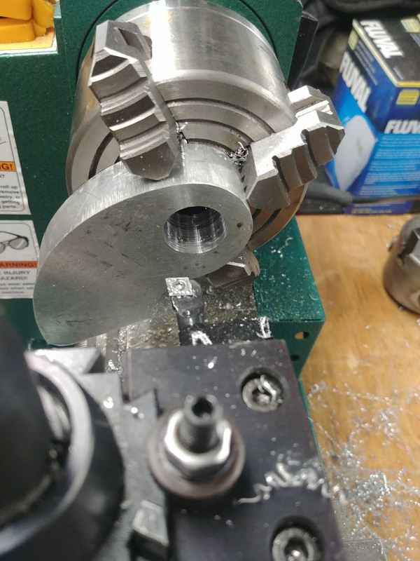

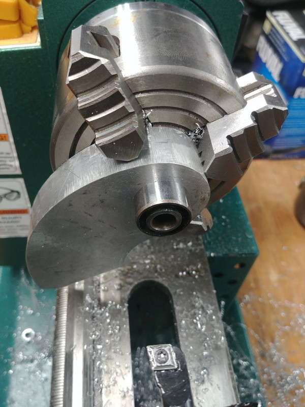

I am kinda proud of my accomplishment today. I did not really do much but I did it with the lathe. I needed to mount the 20mm silent block for the rear shock into the big shock mount I made. First I tried drilling progressively bigger holes using the drill press. The biggest bit I had was about 14mm and by the time I got to it, the hole was off center and not straight through the piece. After cursing a while I thought about it and pulled the 4 jaw adjustable chuck for the lathe out. I completely removed one of the jaws leaving just three in it and test fit the shock tab in its jaws. It seemed to just have enough bite to hold it securely so I installed the chuck on the lathe. I spun the piece on the lathe and got it centered up where I wanted the hole to be. I set up the boring bar and went at it. I tried to attack it by reaming out the center but that was not going well at all. Then I realized a plunge cut from the face would work better. It took a while but it worked out well. I was able to finish the hole and straighten it out in the process. Small Victory!
