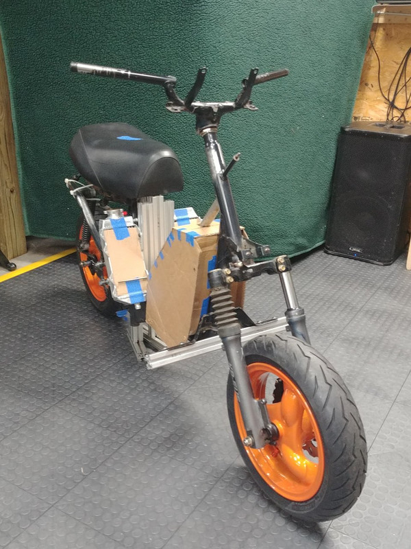

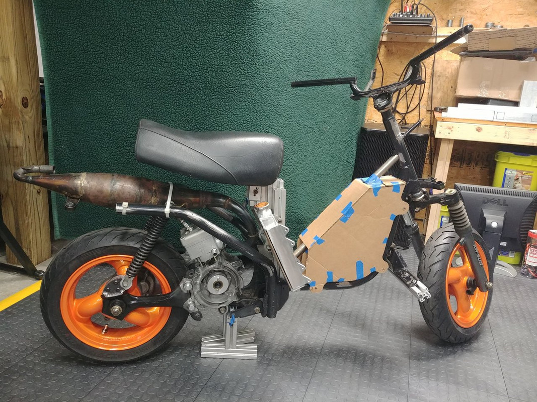

Post by oldgeek on Jan 9, 2021 19:41:32 GMT -5
I made good progress over the last couple of days. The handlebars and the foot rest are just tack welded in place. The radiators and the front support for the seat are bolted up,but still are easy to move around as needed. I have yet to fully work out the rear seat mount that will have to be fabricated in a way that also serves to tie the left and right frame tubes back together. The pipe in the picture may or may not ever end up on this scoot, its just showing there is room for a pipe to go through there. I still don't really like the gas tank in its current configuration. I am going to see if thinning the width of the tank a bit and cutting some of the edging away around the perimeter will make it look better. Maybe I need some round fuel tanks like Brent's moped project.

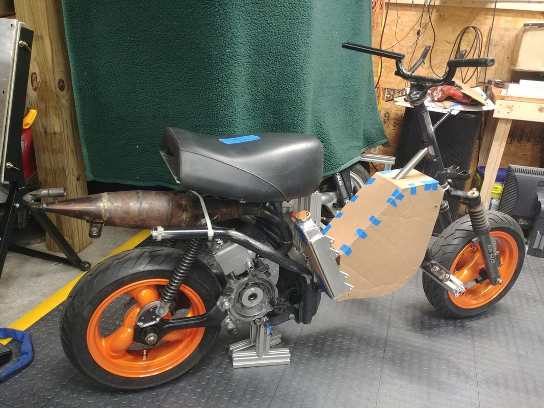

Post by oldgeek on Jan 9, 2021 21:34:42 GMT -5
Cut the width of the tank down about 2" and cut the edge to use mounting tabs. I think it is looking a bit better now.
Post by aeroxbud on Jan 10, 2021 2:08:48 GMT -5
That looks more in proportion.

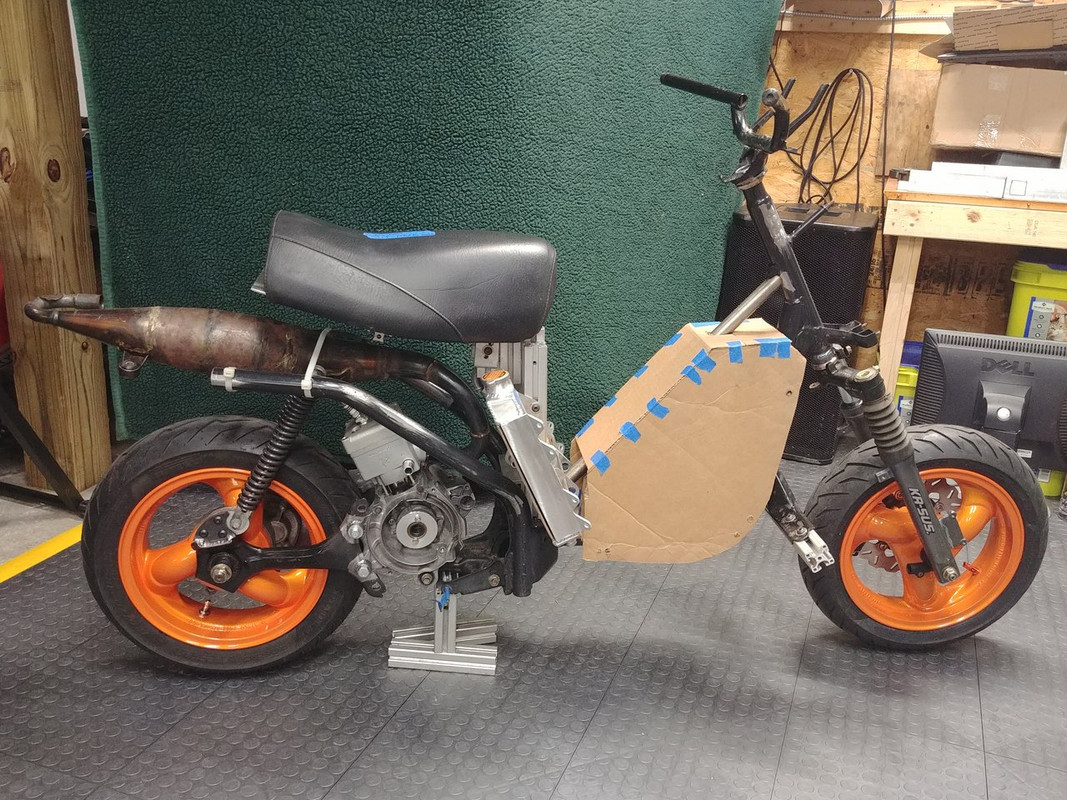

Post by oldgeek on Jan 12, 2021 22:16:37 GMT -5
Now that I have the front of the seat secure I placed some temporary blocking between the frame and the rear of the seat so I could test the rear suspension. I was hoping to get away with using the single Kymco shocks twinned, but they are terribly stiff. I searched all evening for a proper pair of 270mm shocks with a small diameter and the correct mounting points. I must have looked a couple hundred shocks. The only twin set I could find close to being short enough are for a Honda PCX 125. I have a used set on the way from Feebay. They are longer, but I am hoping the scoot will sag to the proper height with my weight on them. I also ordered some headlights I have always wanted to try a set of these. They are projector style originally for a Sachs MadAss. I also figured out a rear seat mount that looks pretty good, I am searching for some mandrel bent pipe to make the mounts with.

Post by Deleted on Jan 21, 2021 7:48:30 GMT -5
I'm guessing seat is going to be modified/lowered, because of the extra height?
Post by oldgeek on Jan 21, 2021 8:12:02 GMT -5
I'm guessing seat is going to be modified/lowered, because of the extra height? I think the seat is in its final location. With the old shocks mounted, when I sat on the scoot there was very little movement of the shocks because they were so stiff. With the new shocks fitted, there is a fair amount of movement. It actually sags to about the ride height of where the stiffer shocks were. I can stand flat footed when sitting on the seat.
