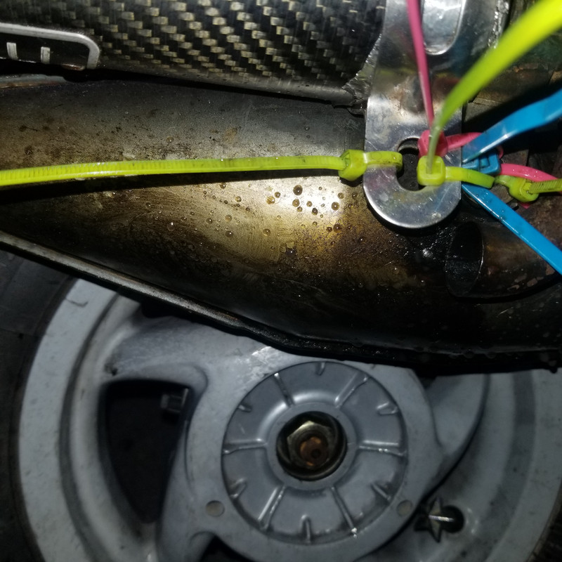

Post by 808ministroke on Nov 12, 2020 23:06:54 GMT -5
 Hey guys this water is not from an outside source it didn't rain there is water comjn out my exhaust  i can only awesome a base gasket i.e. a fuckin rebuild danm wtf .

Post by 808ministroke on Nov 13, 2020 17:07:32 GMT -5
Use a light coat of silicone sealant when re-assembling. Also on the head gasket. I will for sure, i did not assemble this engine but have assembled the mina mhr before, i am assuming itdba basebgasket and not a head is because of how these bores seal making a head gasket failure highly unlikely. I havent yet looked at it any deeper but based on the fact these piaggio engines have water flowing into the bottom of the case it seems more likely that the failure ocurred there, i can only pray that it is not a leak inside the case itself at that point it may be beyond my pay grade tp fix.
Post by aeroxbud on Nov 13, 2020 17:39:22 GMT -5
I know Piaggio don't fit base gaskets to their hyper 2 engines from the factory. But if someone else built it, you will have to investigate.
Post by 808ministroke on Nov 14, 2020 5:27:34 GMT -5
so i took off the old exhaust and it was filled with was filled with water maybe like a half cup or so i ran thr pump with the exhaust off and and i did see a few drop seemingly come out the exhaust from the side closest to the head. so that leads me to suspect it is a head gasket failure of some sort. I always liked the modular head design that is on these and a few other top end bores, always thought they were impermeable to failing but this weekend i am gunna take a look and i actualy do have on hand a replacement head gasket for the mina 77version which i think is identical to the head gaskets on all the 50mm mhr bores so crosssing my fingers. if that is the reason water is leaking into cylinder i will consider myself really lucky as that is the one thing i can quickly and easily replace. oh and got in my yasuni r , nice silencer and bracket i wish the chamber was a little bigger though, still if i can fix the engine up and even get to run it at all this weekend i will be super stoked.
