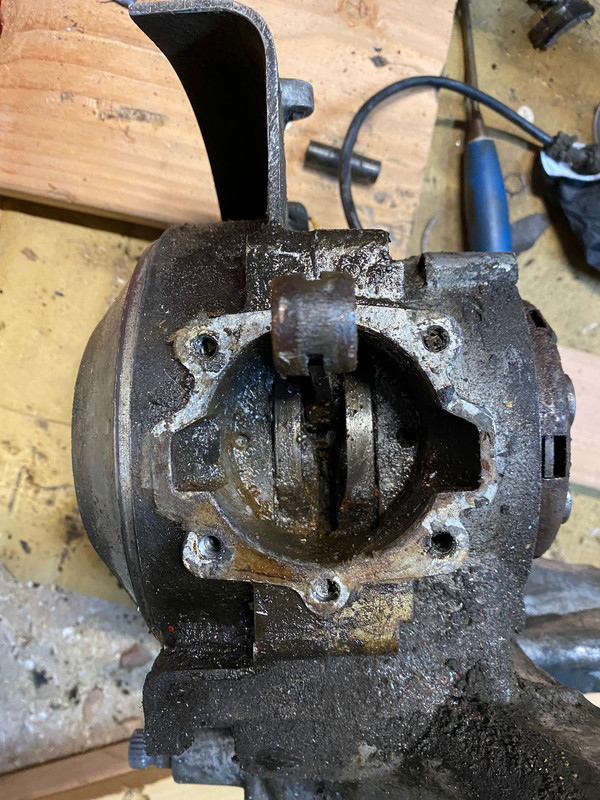

Got the cylinder and piston removed finally! Took hours and hammers, chisels, drills, swearing and probably other stuff but off they came in a lot of pieces. Crank is still seized though.
