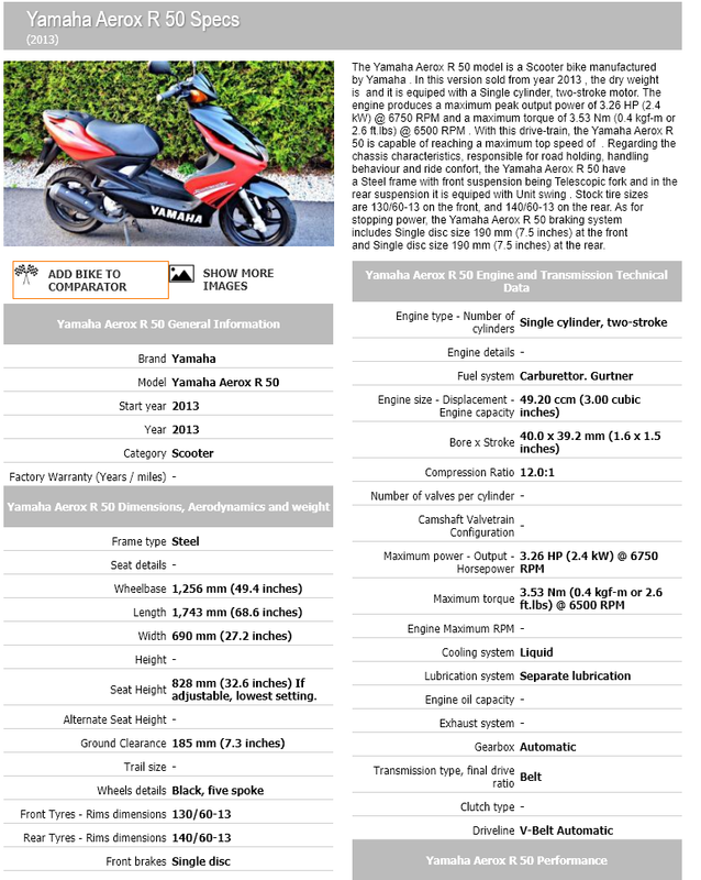

13’s? I’m a scoot noob but I’ve not seen 13’s. 10’s and 12’s I thought ruled the roost. dang 3 1/2 hp stock is sweet for unmodified.
Post by Lucass2T on Dec 15, 2020 1:59:17 GMT -5
13’s? I’m a scoot noob but I’ve not seen 13’s. 10’s and 12’s I thought ruled the roost. 13's is quite common in Europe actually. All the top sales (90-00's) 50cc scoots in Europe had 13's. Aprilia SR, Gilera Runner, Yamaha Aerox, Peugeot speedfight the list goes on.
