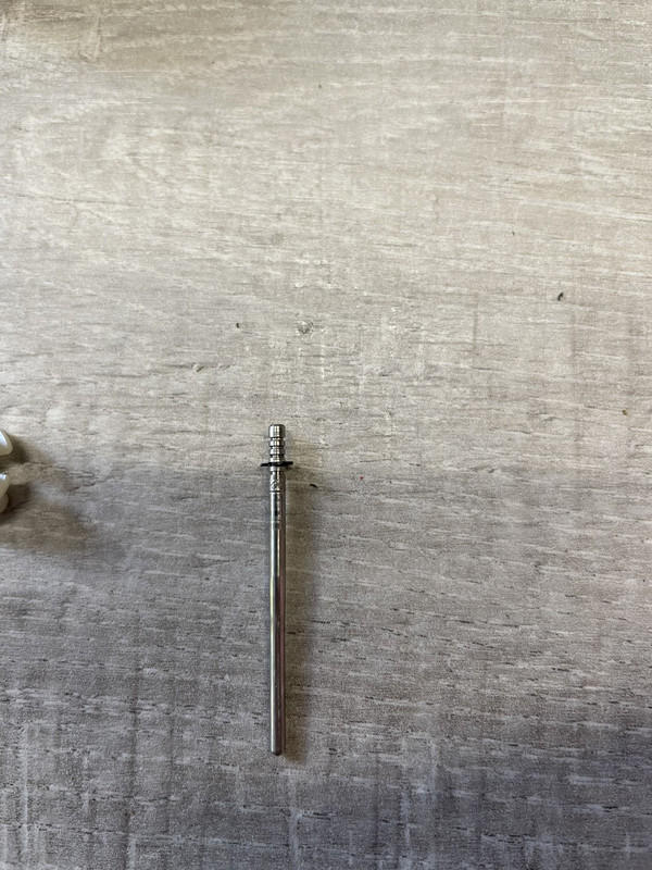

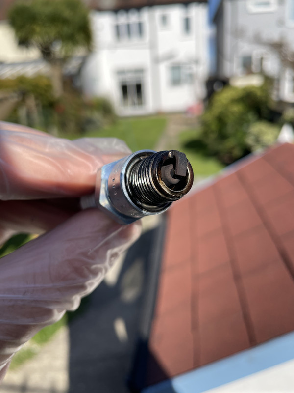

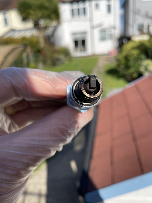

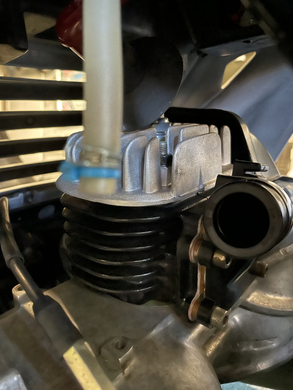

Hi guys! Been doing some riding in this nice weather we have had here lately. To my surprise the bike has been riding pretty well spot on from my initial tune I thought I’d need to adjust the main jet it feels a little rich as you first pull away WOT is great no probs there had a 52mph gps. open to views and advice  Here’s what I have looked at so far I checked the needle hight, I didn’t change this it’s how it was after stripping the old motoforce engine down from the previous owner of the engine  I then checked the head nut torque and pulled the plug what’s opinions on the plug? It’s running a 88 polini main jet I have a genuine 90minarelli jet I could use?

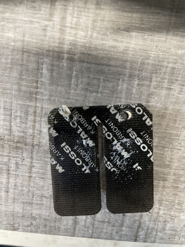

I noticed some of the TB1184 on the reeds Witch is strange it had plenty of time to cure  any way i resealed it with two new card gaskets with a thin coat of TB1215
Post by aeroxbud on Apr 5, 2021 14:49:24 GMT -5
That looks rich. I would try moving the needle clip up a notch. I found in my vertical Minarelli, reed valve gaskets are more prone to leaking. I think it's because fuel can sit there. With the horizontal. The fuel drains down.
Post by yambw’s on Apr 6, 2021 2:49:58 GMT -5
That looks rich. I would try moving the needle clip up a notch. I found in my vertical Minarelli, reed valve gaskets are more prone to leaking. I think it's because fuel can sit there. With the horizontal. The fuel drains down. Nice one! I have a couple new plugs so I’ll give it a go thanks. So when moving the needle clip from one position to the next, up or down, does it make a dramatic change in the lean/rich condition?
Post by Zino on Apr 6, 2021 4:39:07 GMT -5
Your plug looks mildly rich If it feels good at wide open dont go up Better a notch Rich then Lean
Dial in the needle Just small changes from rich to lean as you go up a clip Just go one notch at a time it will gradually have better or get worse response revving it up from 1/4 throttle to wide open If it feels better go up another notch till it either worsens or feels the same as the last clip position . Take the best feeling position if 2 are the same take the lower clip(richer)one for safety .

Leave the main jet as it is. It feels fine on full throttle. The needle controls the lower end jetting. Like Zino said, move it up one notch and see how it is. It will make it leaner at the bottom. If better try one more notch. If not better, go back to the previous.
Post by yambw’s on Apr 6, 2021 5:57:09 GMT -5
Leave the main jet as it is. It feels fine on full throttle. The needle controls the lower end jetting. Like Zino said, move it up one notch and see how it is. It will make it leaner at the bottom. If better try one more notch. If not better, go back to the previous. Ahh ok got it! I got confused when he said a “notch” I thought he was Referring to the needle clip notches as you said then I will experiment with the needle clip
