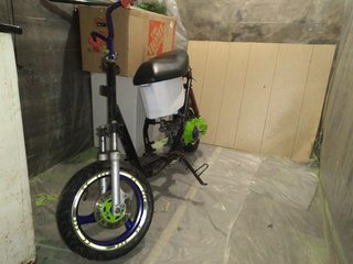

I was eyeballing the Maxiscoot MXS stuff last night. It’s a Loooooong way from my air cooled Naraku 70cc 12mm kit. Yeah same here captincvmn. Right now I'm running an Airsal T6 Racing 70cc on my Zuma. I figure I've had fairly good success this far on splitting the cases and getting them to seal,etc. So why not try something a little more challenging. I've got one case ready to accept the crank just using a dremel and an ebay cutting bit.
