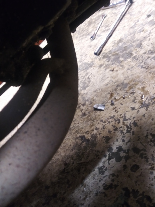

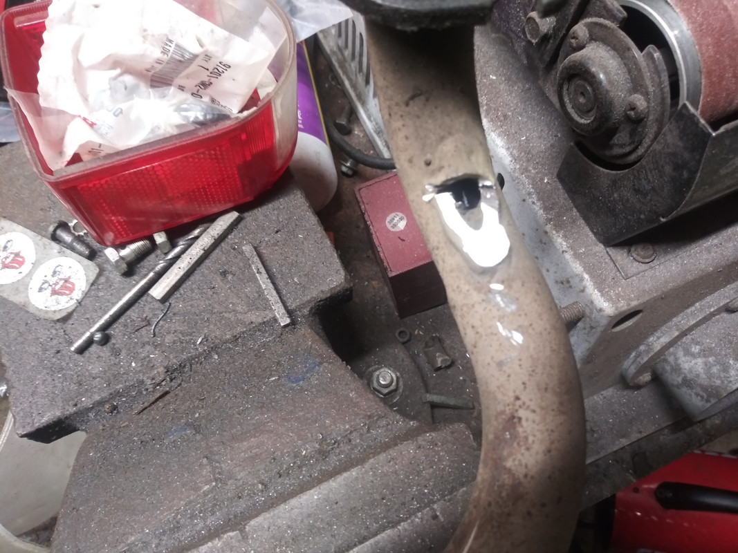

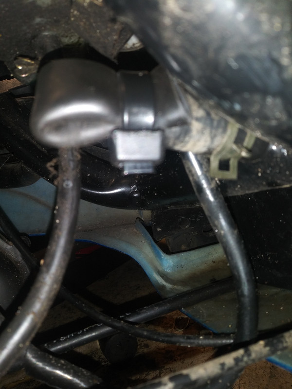

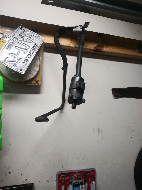

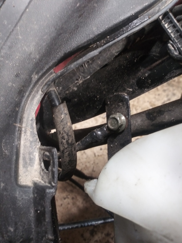

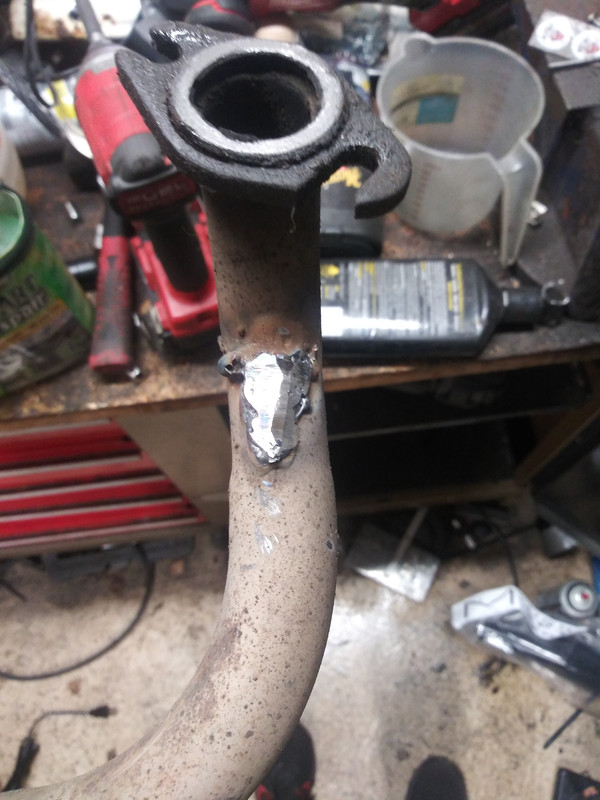

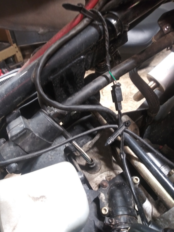

Well, long story short. facebook marketplace, offered 200$, he said yes. Didnt run, got it running with a carb clean. So, now, this scoot is a TNG. What's special is that they were assembled in the USA and generally, a much higher end scooter than you would see in other brands. (ie real pipe, genuine 16mm mikuni carb, seems well built, heavy, etc) Now, it tops out a 38mph currently, cruising is bout 32-35ish. My goal is to be able to cruise at 50-55, and hit 60ish for top end. First order, de-restrict the pipe. This scooter has a much more complex restriction than just a washer, it has what they call a "secondary air injection system" or SAIS for short. Basically it's a complex exhuast leak for emmissions. To remove it i had to cut the steel tube that was welded in the pipe, this took about 30 minutes do to the fact they lay a ton of weld on it. Then i welded up the hole caused by removing said pipe. After that, i cut the rubber hose and zip tied it to cap off the frame (to prevent rusting) Tommorrow ill be heading for a test drive, wish me luck!

Post by 190mech on Mar 25, 2021 4:07:23 GMT -5
That stock pipe has a built in cat and a ton of baffles,best to bin it and find a decent expansion chamber..
Post by markopollo on Mar 25, 2021 11:14:32 GMT -5
That stock pipe has a built in cat and a ton of baffles,best to bin it and find a decent expansion chamber.. good to know, i figured that this pipe was gonna be like that with how quiet it is even with the external stuff gone. but with that external leak gone, it kicks in low now, but drops off after 25mph and same top end.
