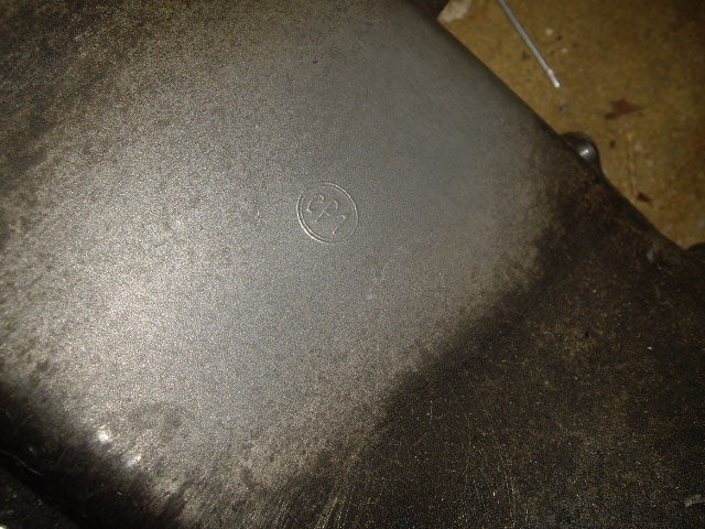

CPI cases have a casting mark in the wheel opening about midway like this; It sure looks like a CPI to me but may be a knock off..

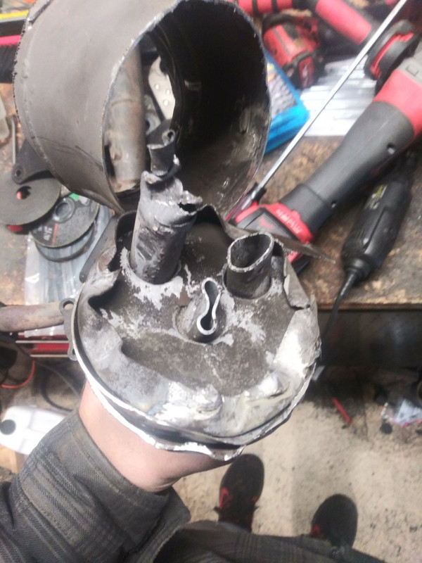

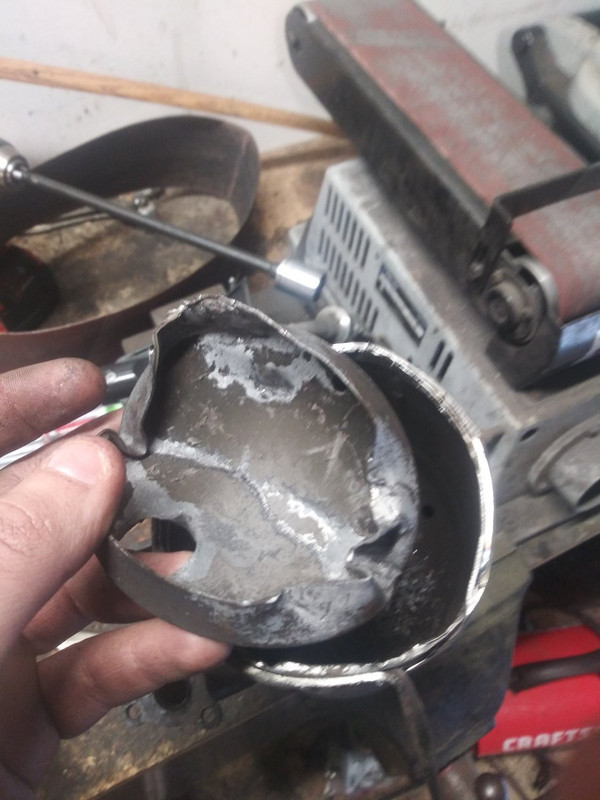

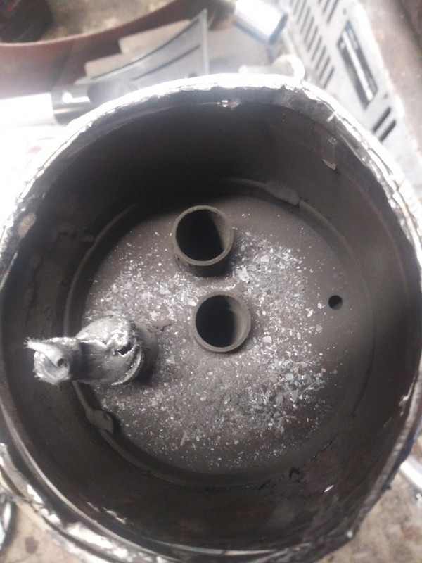

well, calling it a day. took me a LOOONG time, but, all that EPA crap is GONE!! 2 baffles and a cat for me. it'll need to be patched up (leaks,do to my "perfect" welding) also sounds lean, id say a up-jet is in order.

I don't see a logo, so I'm not sure if it's the real deal till I take off the top end for some "port" work (knowing me, its gonna end up crappy).

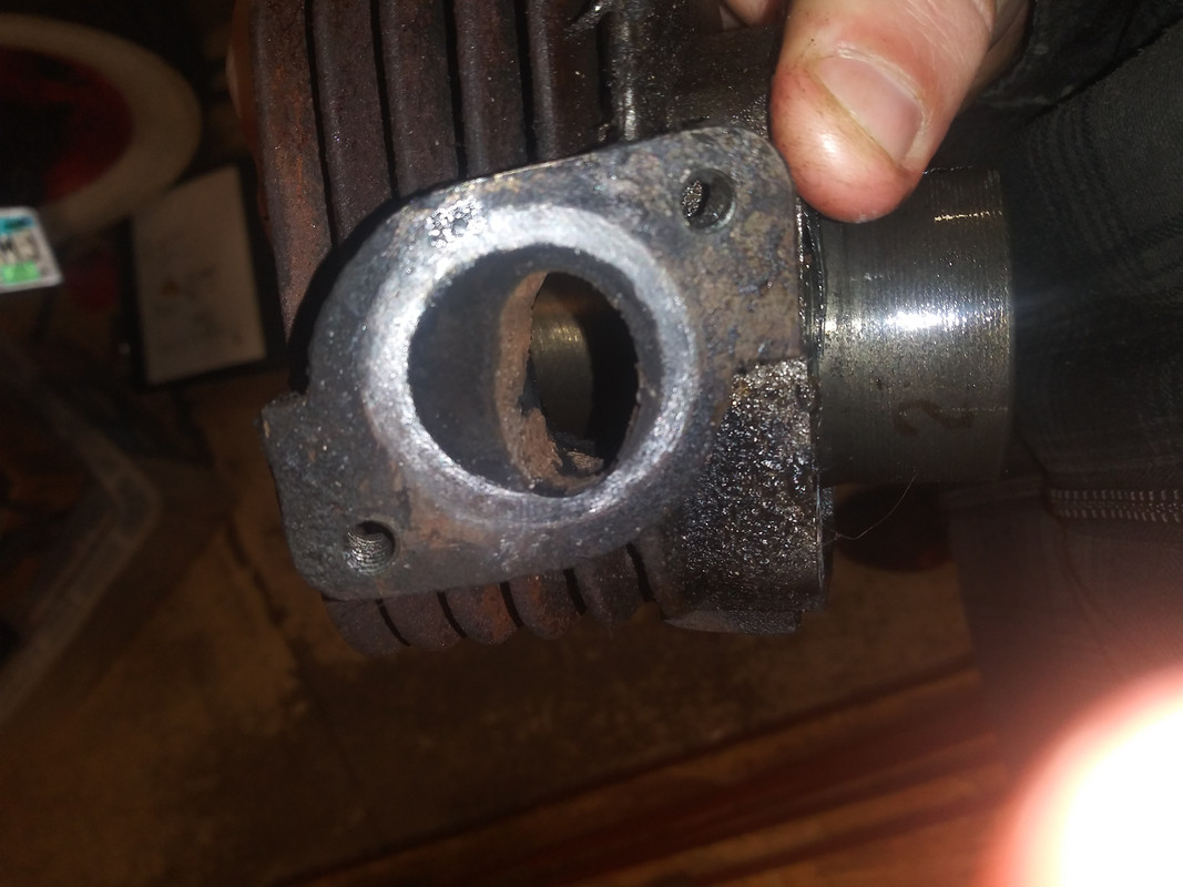

Post by markopollo on Apr 15, 2021 20:32:48 GMT -5

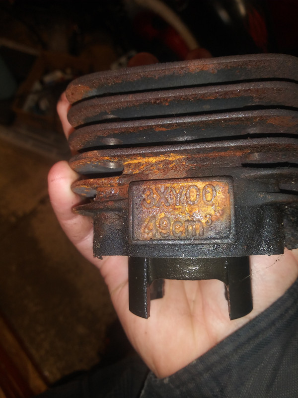

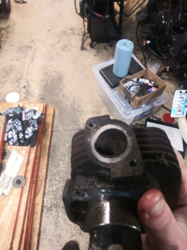

Finally some good stuff! Got the top end off, and have some good news and bad news. Good news is, 12mm wrist pin!! Looks like its a genuine CPI Bad news, stock cylinder is JUNK for any meaningful preformance as the manufacturer casts a HUUGE restrictor on it (its narrower then the tip of your thumb, for reference) Gonna order a cheapo "90cc" big bore kit for it. Still looking for pipe reccomendations!
Post by captincvmn on Apr 15, 2021 21:58:46 GMT -5
Save yourself disappointment down the road and buy a stage6 70cc street race kit. Buy the wider bearing to match piston too. Cylinder has 49cc stamped right on it for the PoPo
Post by markopollo on Apr 15, 2021 22:11:39 GMT -5
I mean, I like messing with stuff more than driving lol.
Ill see how it turns out, if its junk ill see what i can do to make it better. I also don't want to purchase a racing crankshaft just yet..
It is an 8 port though, so its got potential to be atleast decent.
