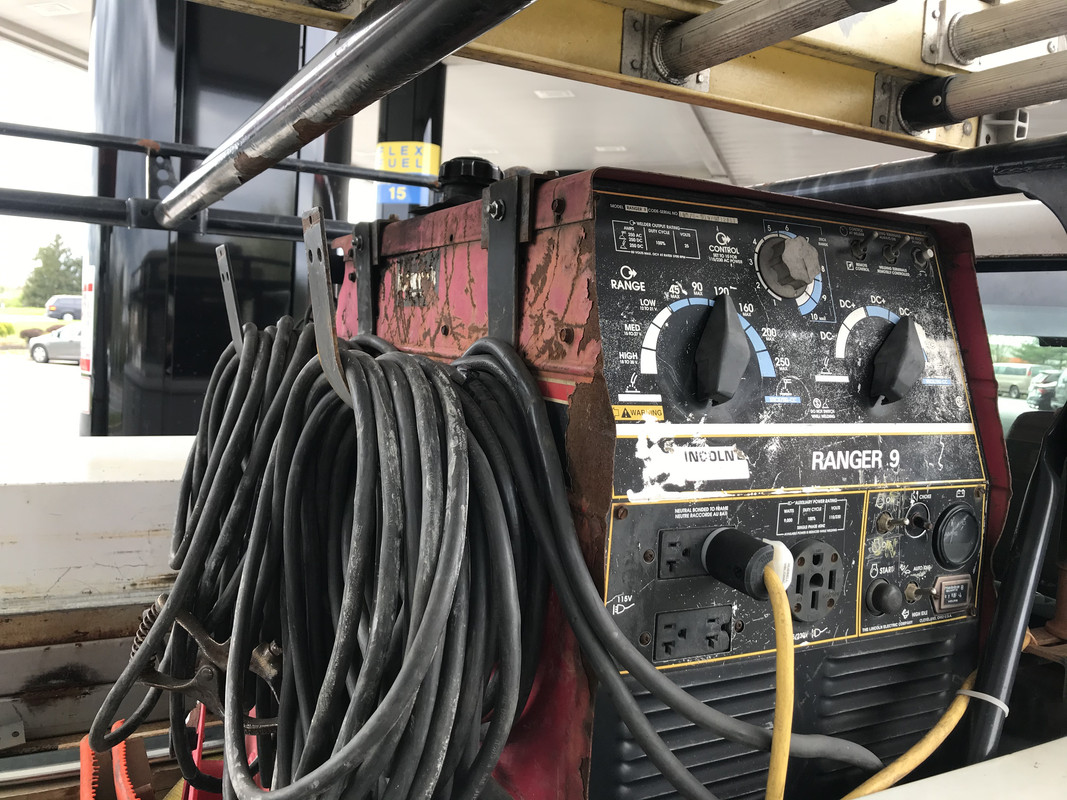

Post by captincvmn on Apr 17, 2021 15:38:36 GMT -5
This is my welder on my work truck I use. 3600 hours on it and climbing. Reliable Onan engine. Sits outside in the weather all the time. I’ve had this particular welder on a work truck for 14 years and I know who had it on a truck before me. It’s pushing close to 25yrs old I bet.
