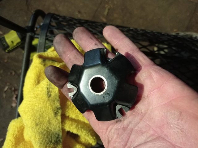

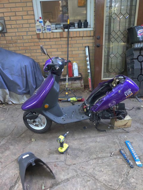

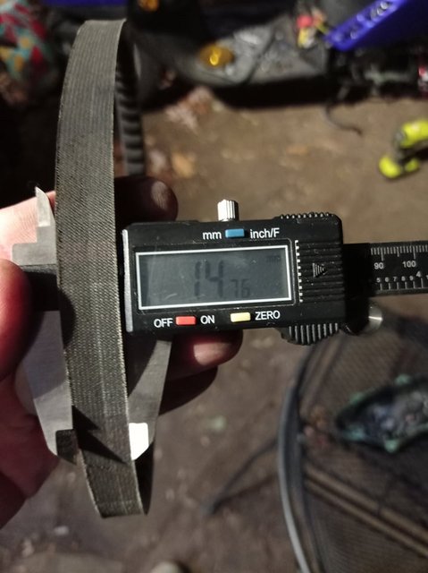

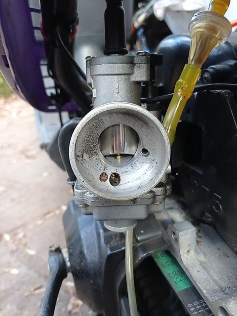

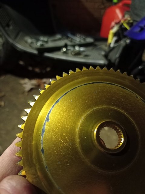

I'm now 1100 or so miles into running this bore. It has been problem free the entire time. There is some more tuning I could tinker with, but it's just been so reliable I didn't want to change anything. Well, I've been meaning to change the air filter to an angled one that tucks up under the plastics better, and yester after hitting a big bump the air filter pushed the side skirt out. So I went ahead and pulled the filter on the prebug and elite to clean and then swap.  Ooof, what have I done? So much crap getting to the carb.  I should have pulled and cleaned this thing earlier. Now I'm scared to see what the cylinder looks like. It still feels like it has good compression so maybe I don't look until I absolutely have to. Maybe the whole time it was just self sabotage so I have to purchase the corsa and pg long that have been sitting in my treatland cart for months now.  Might as well inspect the CVT now that I'm working on the damn thing. Drive face is pretty ate up. Unsure if this is all just from belt wear. What do you expect with a $20 drive face from aliexpress  Belt down to 14.7mm from 15.5mm. Honda spec is 15mm so I'm a little past due on this as well. Time to order a new belt.  Ramp plate was missing a guide. Rollers are starting to flatspot. And clutch is pretty glazed. So I replaced the guide and rollers and scuffed the clutch pads up a little.

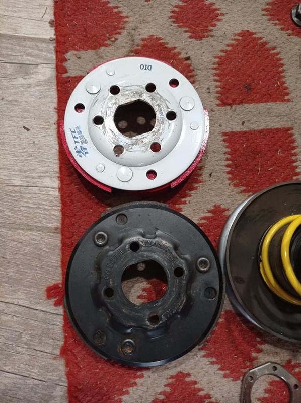

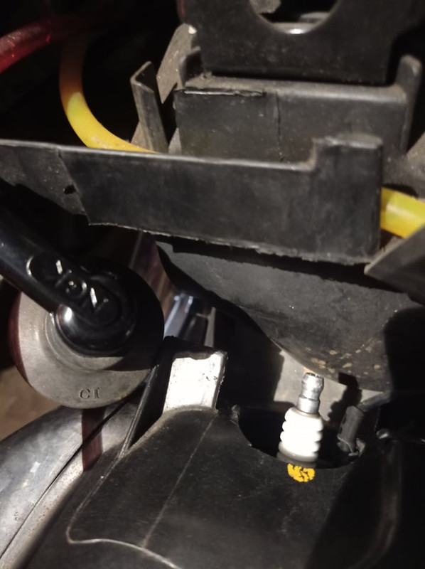

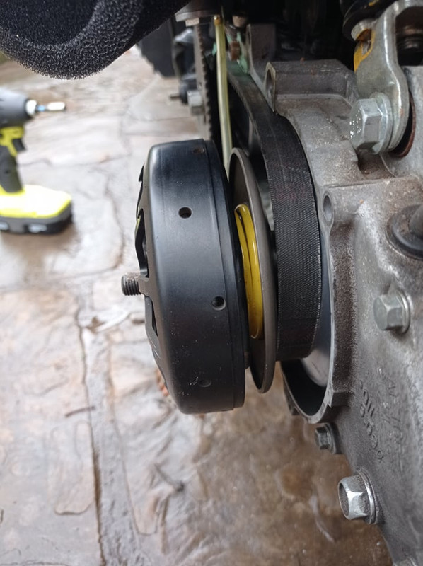

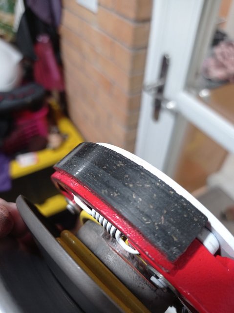

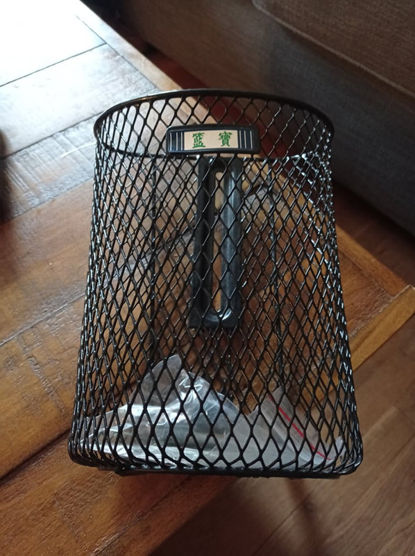

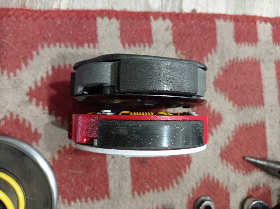

As luck would have it, since I started messing with the bike again, issues start to arise. Despite not even touching it, the spark plug cap decided it no longer wanted to hold on. Instead of replacing with a similar cap, I decided to try a cap for terminal nut instead of terminal stud. I'm not sure why the different types exist...anyone know? Anyways, NGK 8031 / LB05P  Also, the clutch has engaged too early since I've put it on. I have a set of Polini clutch springs that are marketed for Dio/Elite/ZX50 etc, but they don't match stock clutch or the TFC clutch I have.  In the mean time, I swapped a Malossi Delta clutch out for a Stage6 Torque Control MKII on one of my Zumas. A little digging, and it looks like the Delta will work on the Elite since I am using a 107mm bell. I already have a set of tuning springs for this clutch.  shorter pad, but fatter. Looks like the scuffing up I did on the TFC the other night wasn't enough. Looks slick already.  Fits no problem. Leaving the red clutch springs in.   A quick run around the neighborhood, and I'm VERY happy with the clutch swap. I should have messed with this ages ago. I also received this nifty little front basket in the mail. I'm still unsure if it will end up on this bike or one of the new black Elites I just picked up.
i think your fuel filter is installed backwards, but main thing, get fuel filter.

Ooof, what have I done? So much crap getting to the carb.  I should have pulled and cleaned this thing earlier. Now I'm scared to see what the cylinder looks like. It still feels like it has good compression so maybe I don't look until I absolutely have to. Maybe the whole time it was just self sabotage so I have to purchase the corsa and pg long that have been sitting in my treatland cart for months now.  i think your fuel filter is installed backwards, but main thing, get fuel filter.
what is your plan for the PG Long pipe? Flip cone? if not better of spending the money on a Yasuni as far as quality.
It is haha. It still filters this direction, just gets clogged easy. I had issues with that when I first got it, but didn't know any better. Now that I know better, it doesn't get clogged anymore, but I've just been lazy to flip it. Now that it's been noticed I guess I have to flip it.  PG long just seems like a good cheap bolt on option that would make more power with a Corsa than the v8 style pipe on right now. I know of the flip cone, I just don't really have a good idea of how it's actually done. It'd be great if I could find some pictures of what actually is going on with the flip cone. Of course I still have the C16 for vert minarelli as well. I really need to spend more time on that idea.

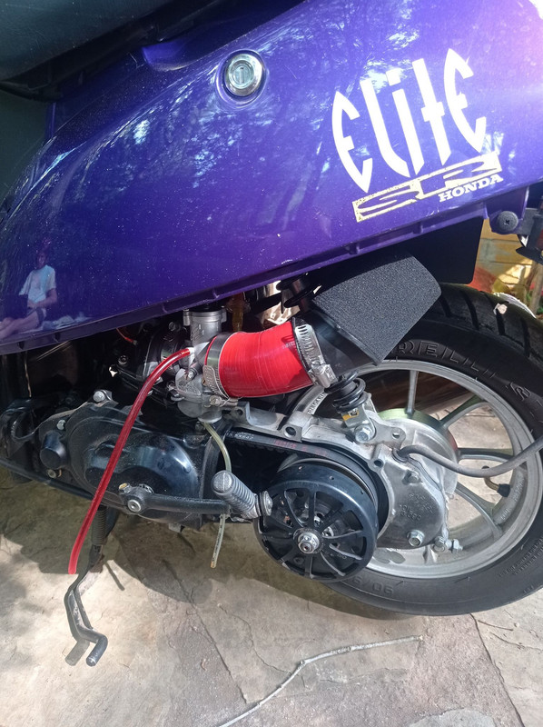

I have been having clearance issues with the air filter hitting the side skirts when the suspension compresses. Sometimes it will pop with side skirt out. I came up with this as a solution. 45* hose with a coupler at the end for the filter to mount on. It now tucks up quite nicely. I don't know if there is a better solution as I'd rather not trim the skirts.  The silicone hose is not ideal as if it gets fuel and gas on it, it will probably start to swell. But since the proof of concept works, I can and may replace with fuel filler hose.

Ooof! long time no update. That intake solution fell off pretty shortly after installing. I've just been riding without the sideskirt. I don't think I've touched anything else on the bike since. Kinda sad looking back in this thread and seeing how long the corsa/c16/crank/variator have all just been sitting around. I think I'm now around 2200 miles on the Polini Contessa. 10/10 would recommend. It's been feeling like it's running a hair lean lately, and I sold the silver wheels off of the bike to a friend. Seems like a good time to put it under the knife. I have the motor off now and plan on doing a leakdown test this weekend to see if I've developed a leak, just for science. Then hopefully I can start moving forward with getting the new parts installed.
