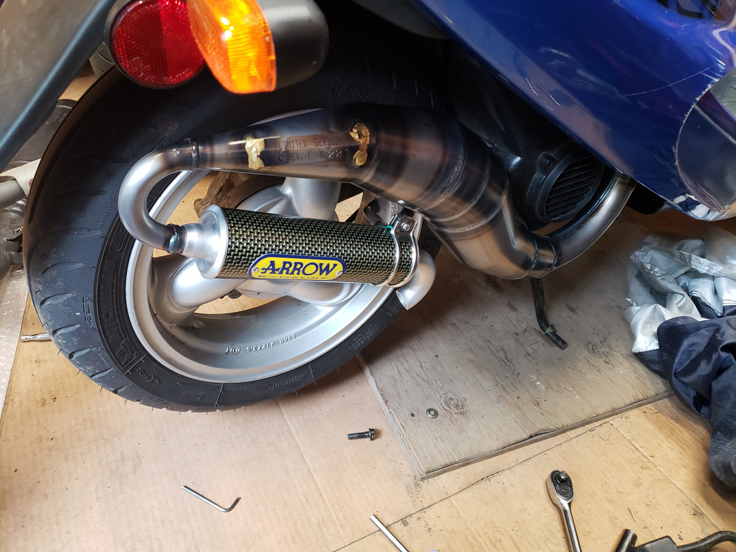

I love zx50's! they all pack a great punch, and have a very enjoyable ride. I have a Polini Contessa 72cc and CVT bits for mine (which need to be installed some time this spring) and also an Arrow exhaust. I would say you should try some trim restoration gel, as yours look like they need it. here's what mine looks like for reference Stock exhaust is fine, but its like a boat anchor, so heavy compared to a performance pipe. ![](https://i.postimg.cc/jqZzDYTq/20210922-153658.jpg)

Post by winner3ty on Feb 26, 2022 20:59:07 GMT -5
Thanks! I was looking at the Arrow pipe but wasn't sure if it would clear the plastics. It looks like it does. Decision made ![:)](//storage2.proboards.com/forum/images/smiley/smiley.png) Plenty of room, had to remove the reflectors though, cuts it too closely to the pipe. wraps around the air shroud well. also will have no rubber stopper for the center stand. Also a must is to replace the allen bolt for the silencer, strips out easy and is too short. ![](https://i.postimg.cc/J0cM3BhY/20210922-153640.jpg)
