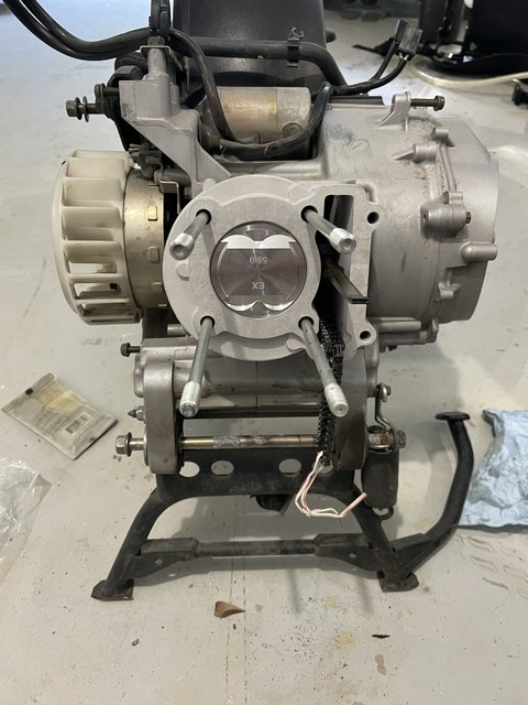

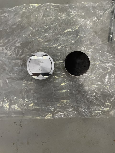

Got this far today. I need a slide hammer to get the rocker arm pins out so I can swap the cam. The new cylinder & piston look nice. Kit came with a thin & thick base gasket too. Hopefully it runs well when it’s finished.

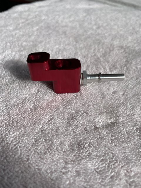

Got it put back together yesterday & when I went to start found out it was leaking fuels around the new fitting. Picked up some thread sealant on the way to work this morning so hopefully it’ll be good to go tomorrow.
Post by bigmatthew86 on Oct 5, 2022 12:53:26 GMT -5
Got it running today, that fitting is still giving me problems however. My battery also crapped out so I had to order one. I robbed the battery from my 50 so I could ride it. Put about 15 miles on it. Rode it to the gas station & filled up with some fresh 93. Didn’t do any top speed runs but I was babying it either. I’m in the break it in hard group. It pulls way better. It’ll accelerate going up hill with me on it which was something it wouldn’t do before. It’ll also hit an indicated 60 pretty easily where not so before. I’ll give few more miles & see what it’ll do top speed now. I had read the cam makes a pretty big difference over just a bore kit & this seems to be true. It feels like it’s pulling strong on the top end.
