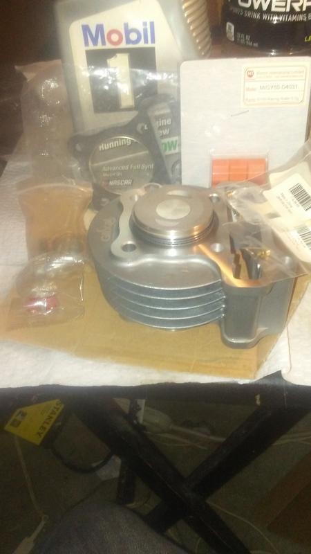

I know I'm jumping the gun a little becaue it isn't installed just yet....but this thread has been touched in 4.5 months so... I just ordered a 47mm Glixal BBK off Amazon frommy bro's Prime account. Free 2 day shipping. About $27 for the kit which is just cylinder, piston, wrist pin, circlips, intake/exhaust studs, base/head gaskets & a pair of valve oil seals. Link to Glixal 47mm Cylinder kit(no head): www.amazon.com/gp/product/B01303YPEU/ref=oh_aui_detailpage_o00_s00?ie=UTF8&psc=1Does anyone know should I bother using the new oil seals if I am using my stock head and have no current problems with my head running my stock cylinder/piston? I heard good reviews for the Glixal kit on Amazon, on this forum and in this thread here so all that coupled with one of the lowest prices I could find delivered to my door and very fast is why I chose it. I hope me getting this "bare minimum" kit will be enough for some great results. I have recently heard bad reviews for a9 cam on here so I decided to skip that and I think my stock head will be good enough since it is running ok currently, I am just a little worried about the compression increase so I may run an extra gasket or two and make sure tomuse 93 octane gas, I also ordered #88, #91 and #94 main jets from partsforscooters.com (#95 was out of stock) to put in my pd19j CVK carb. Jets should arrive in 7-10 days if I read correctly, were under $3 each I believe and under $4 shipping so very good prices there. To wrap it up I ordered 6.5g sliders off e-bay fro $10.25 from seller PartsGalore which should arrive in about a week. If anyone has any pointers for me I will gladly take some advice! Thanks! I am excited to find out if I can make this run and if so how much power I will make on the roads I run

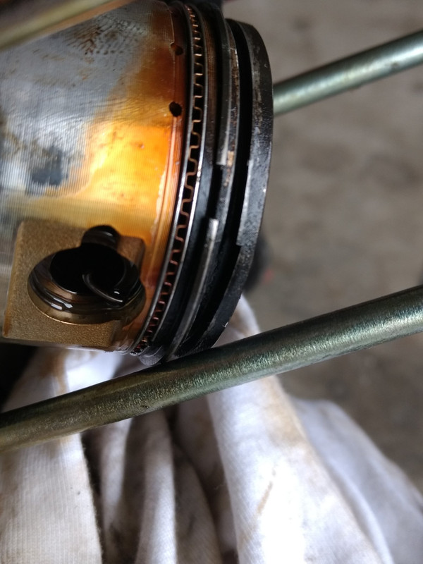

Ran a Goofit 47mm BBK from for more than 5k miles. I want to say it was on there from 2000km to 15000 maybe?
Ran very hard, lost my air filter a few times and had to ride home without one. Didn't know I was probably cruising everywhere at 9000rpms. I normally run WalMart 10w30 and replace every 1500-2000km.
Was leaking oil and ran low on oil a bunch of times. Eventually it caught up with me and damaged the rings. The upper oiling ring pushed down diagonal into the compression ring groove. Pretty nasty groove in the cyclinder.
Still ran, but only about 25 mph, and hard to start. Replaced, drained the oil a couple times to try and clean all the metal out.
I replaced with a new 47mm BBK around 15k or so. Replaced the crank around 20k. It had a little noise to it, not like a failure situation. Defineitly a lot of play in it when I removed it though. Re-used the piston and cyclinder after. So that second piston/barrel has been on for about 5000 miles or so? No problemo!
