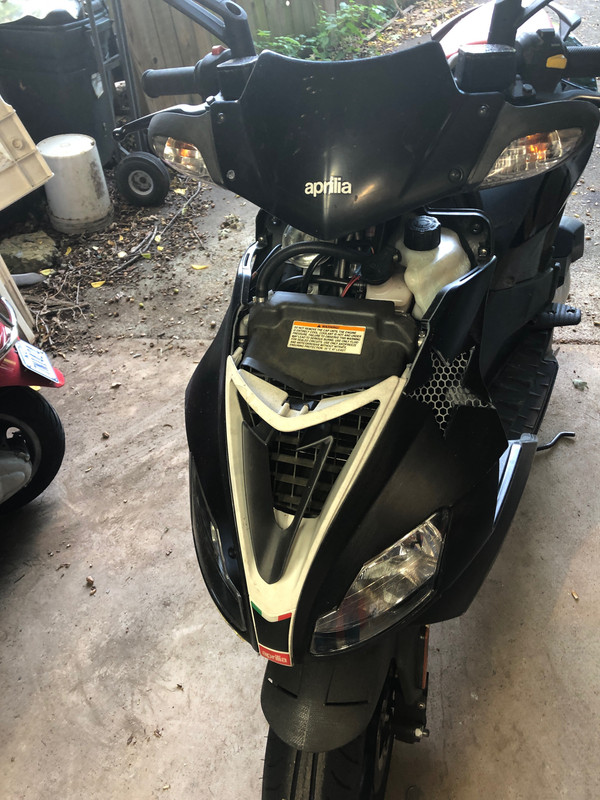

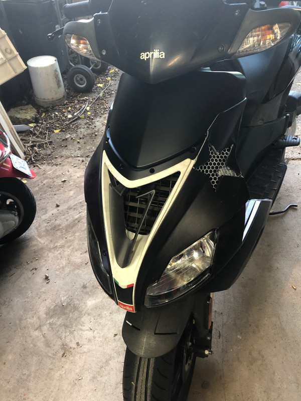

Post by pinkscoot on Sept 6, 2020 9:56:38 GMT -5
I finally got the almost last piece on.   There is one small piece that goes under this that's on its way from Italy. But it button up the front and covers all of the fluid tanks.
