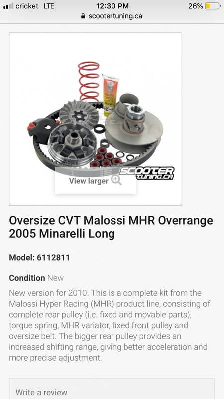

I have found this on the Canada rabbit site. I’m trying to avoid splitting the case, buying gears, plus new gasket for everything at the moment. benji you said the gears would be a dependable option, but what about just throwing down on this overrange kit? My goal is 50mph. The acceleration is great right now I’d like to keep it if possible but get into the 50s without the motor screaming getting super hot. I pulled the cover and found everything (contra,clutch,vario) is completely stock including what looks to be the original oem Yamaha belt but maybe not. The fan drive face has chipped off blades. Only the restriction washer on the boss was removed previously.
Post by benji on May 20, 2019 14:34:46 GMT -5
That over range is a good buy, but there is modifications that are needed to install it. It may be Overkill w/o up gears. I would do up gears and tune the OEM CVT before you buy that. You should be able to hit 45-50 on the OEM CVT and gears with tuning. Btw, if you buy the over range you will still have to tune that as well. It is not a bolt on kit. Gears however are much more universal. You will need a press but they're an easy install, not case-splitting. A set of 15/50 upgears are what you need, along with time spent tuning the CVT and maybe a jog90 rear td.

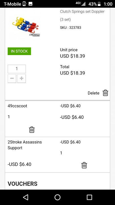

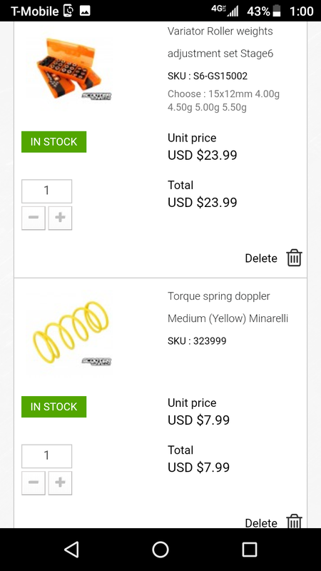

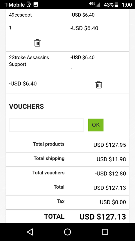

Ok great I’ll go ahead and buy the things needed now. Say benji do you mind sharing those discount vouchers with a fellow 49ccscootr’? :edit: I was able to decipher one voucher out. I tried a 49ccscoot one and the site said it wasn’t valid. Either way, I’m glad the gears are on the way, plus a few other things that were needed. I held off on the rollers, contra and clutch springs because I’m probably just going to get Malossi “Multivar” and it has different size weights than the stock vario has and comes with a torque spring. No clutch springs because the adjustable S6 torque control seems pretty trick. I have an NCY rear pulley but it’s just a matching size to the stock TD only with better shift angles. It was cheap ($30) and it’s been collecting dust, I’ll give it a try with the new gears.

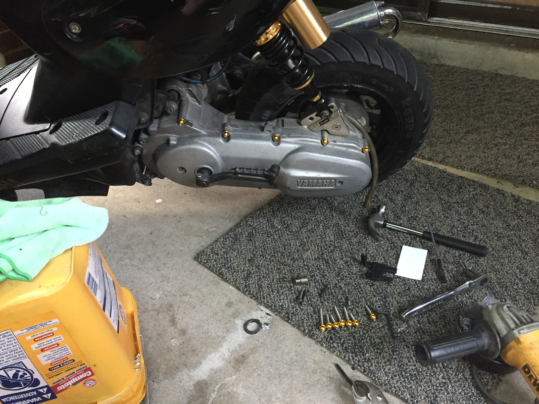

Post by mattyslimz on Jun 7, 2019 10:31:26 GMT -5
I added a rear shock (not res. adjustable just for looks) and a Stage 6 riser. The riser is for an Aerox so some grinding to the case and riser itself we’re needed. I really like the height now and with the spring tightened up it’s a real smooth ride. I can make deep left hand turns/U-turns with out the Buzzeti side stand scraping. I need to protect that as it’s my only stand, centerstand must’ve been removed by PO due to scraping or fitment of the pipe. Today I will tackle these gears. Hopefully everything goes smoothly. I have a new nut and washer from Partzilla.com. I gotta buddy up the street that works at the Sunoco inspection station, they have a shop press, said just bring them up when I’m ready and slip him $30.. I will be bringing a 13mm socket to go over the shaft when it’s pressed to be sure it’s not crooked, I’m also going to put some gear oil on the shaft/spline to help with the process. I’m getting max temps of around 245-250 with a new BPR8HIX iridium as opposed to the hotter plug BPR7HS non-iridium, temps were around the same.. mind you this is still on factory oil injection with 2 cap fulls upon fill ups. Does anyone see temp changes or performance difference when moving from a hotter plug to cooler?
