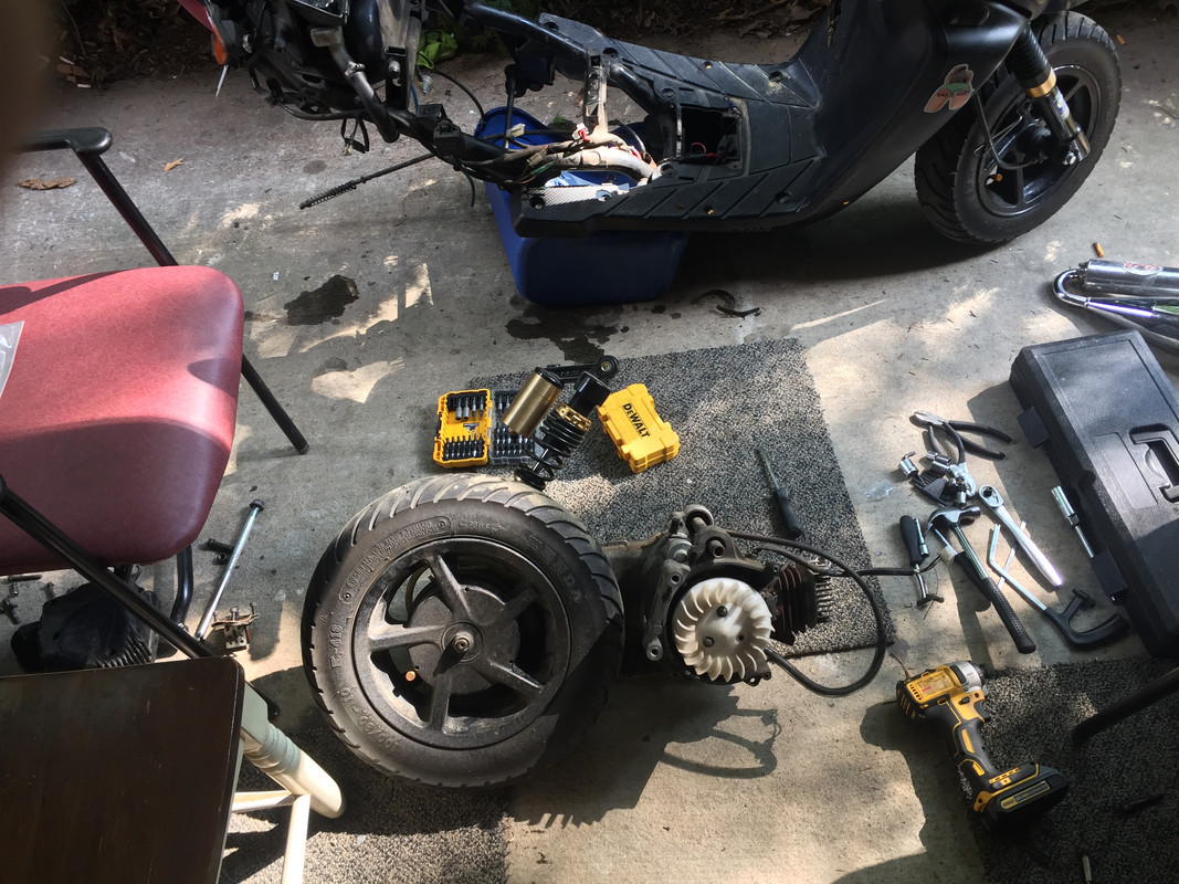

I was going to create a new thread titled “Air cooled monster” but forgot I already started one for this bike. I must of fell and bumped my head because I went and spent more than I should but cheap thrills aren’t my thing and I wanna have fun. The original crank and bearings were already making a little bit of noise upon purchase, but as time went on the noise only progressed and got worse. I searched what would happen if I just kept riding on a bad crank and the results weren’t good, I’ve read everything from seizure from the crank (NOT piston) to also case damage. It was enough for me to go ahead and get some parts ready for a rebuild. I wanted more power and decent reliability, I’m not dailying the bike to work or anything but would like to take it once or twice to week to save money on parking. Parking spots in the Washington DC metro area where I work can get up to $18 a day sometimes so this is a no brainer that I will alternate between my QJ RX8 and this one for parking savings. Heres a list: 1. Malossi RHQ 12mm crank 2. Stage 6 MKII 12mm Racing 70cc kit 3. C4 Stage 6/SKF bearing and seal kit Parts needed to do the work 1. Easyboost crank splitter/bearing separater combo tool 2. Easyboost flywheel puller Minerelli 3. Large size oil filter strap 4. Mapp gas torch. 5. My kitchen freezer. I also am removing the oil pump and going premix. Parts purchased for that I’m still waiting for: 1. Doppler oil pump block off kit 2. A non-vacuum fuel petcock from Yamaha part# ya-2gu-24500-02-00-1 Here is how far I’am.. I have a ways to go yet, so expect me checking back in frequently for questions and updates.

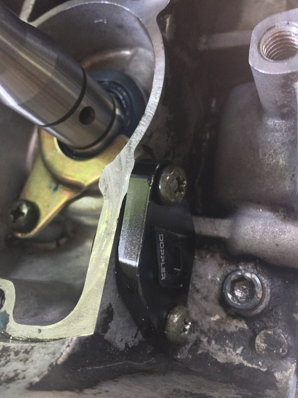

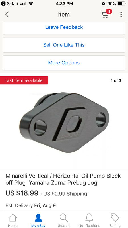

If anyone knows what all I need to correctly install and mount this pipe to this style Zuma it’d be a big help. I guess c16/20/21 all use the same flange, someone here must be running one of the three on a bugeye, I just don’t know if everything will come in the box I get. ryan_ott? There’s a riser on my shock so the bike is opposite of lowered. The Leo Vince has a couple battle gashes but it hasn’t happened since the riser install and from what I gather it will help with the Yasuni fitment because it looks like C series pipes hang a little low.. I have everything buttoned up. I kicked it over a couple times and it started right up. The manual fuel cock has much better fuel flow. Just need to do a leakdown test before I even attempt at any testing/tuning or riding for that matter. On a side note this was a waste of $15.. what the hell did I put that in there for? I had to grind out material just to make it fit (they did mention for the vertical first in the description). I guess it’ll divert airflow way from back in that stator area.
