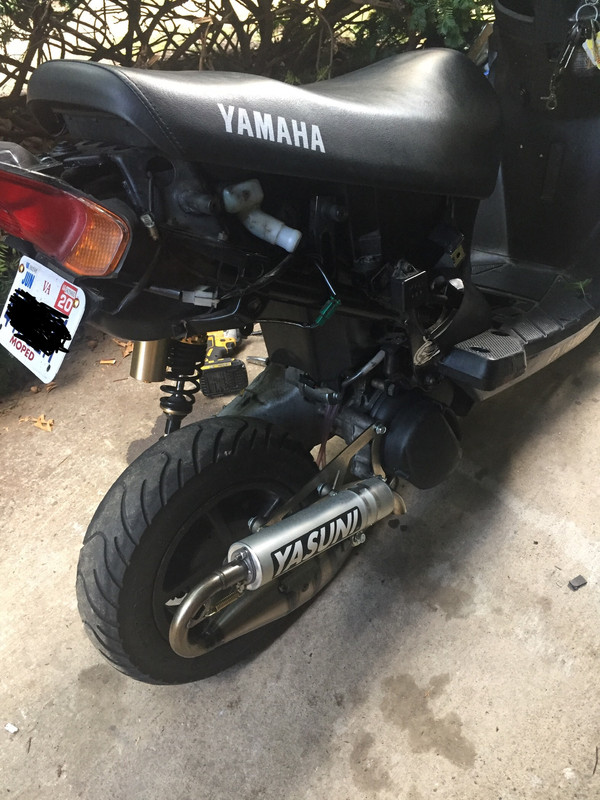

You should get everything you need to fit the exhaust, if it's supplied for your model scooter. I have had quite a few Yasuni exhausts. The only problem I have had is one came with an L shaped spring. Instead of the straight one.
Post by ryan_ott on Aug 22, 2019 20:23:47 GMT -5

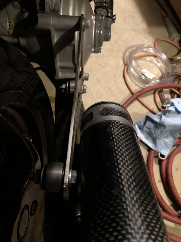

I just saw this... it should come with everything you need. Be sure to mount the bracket on the correct side of the pipe.

Ahh yes I see.. Everything did come in the package that I needed. After all, I have it mounted the same exact way you have it with the hangar bolts coming thru the back. The pipe just got here today and it got to dark to take any pictures but I did lay the C20 down next to both Leo Vince’s TT and ZX and I can tell you ALL the build quality on these pipes far exceeds any other I’ve seen. The welds are super nice and the thickness of the surrounding metal is what all pipes should be. I had a hard time finding a new C20. I checked Yasuni’s website and they do not have the C20 even listed anymore. PM Tuning out of England (the company with world record scooter speeds and that makes wacky looking 360 degree pipes) had one on sale for $120 quid euro* and it just so happened to be for a Minerelli horizontal. It came to $186 on my end after the currency conversion and import shipping. I’m glad I jumped on it when I did. I started the bike up and it sounds real good. I can already see after a few revs that it doesn’t like being down low for too long and seems like it would be a dog off the line unless I get a clutch and springs here soon. Leak down test tomorrow and than I should be able to button it up for a full on cruise.
Post by aeroxbud on Aug 23, 2019 4:23:58 GMT -5
The welding is good on those pipes. If you don't paint them, they get a lovely colour when used. Removed the restrictions yet?

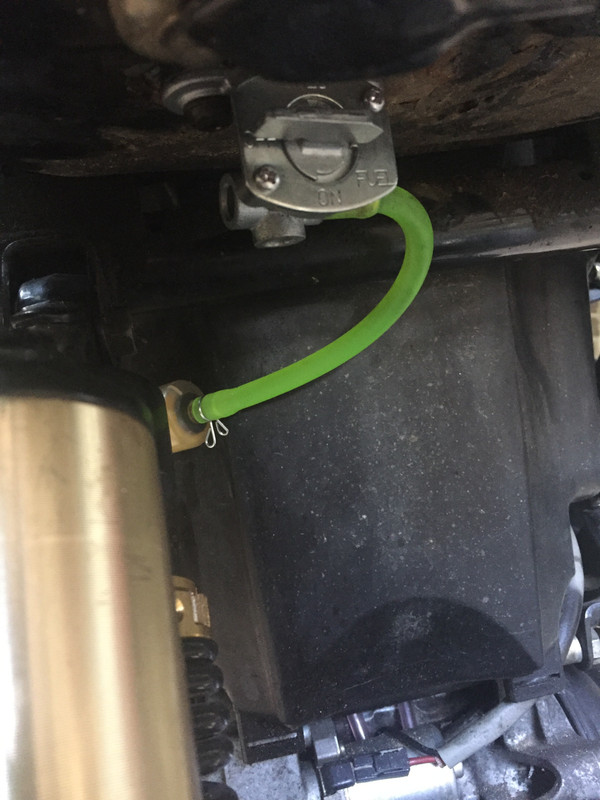

Ok I’m going to hold off on that than. I was just worried the stock system wasn’t handling the really high rpm this combo is putting out. It felt/sounded like it was breaking up, but it was probably just my jetting. The single fuel petcock that’s for WR and YZs works good. This thing is turning out to be a pain in the ass to tune correctly. Either I have to raise the needle or I’m gonna have to order the SMALLER! size pack 100-122 because all the jets I’ve tried above the factory 120 have been way to rich. I more than likely have to put some money into the CVT really get a proper tune.. More waiting I guess. I think I’m gonna go with the Stage 6 Torque control clutch in 105mm. I’m running 4.5 g rollers. Instead of the the Iggy I was thinking of getting an a full Malossi overrange Kit since I’ve removed the starter clutch and all its components, I had to shim it a lot.
