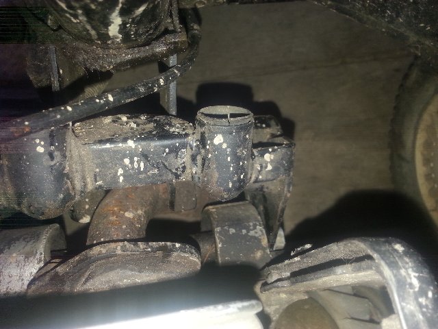

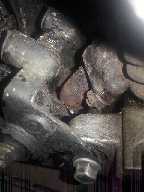

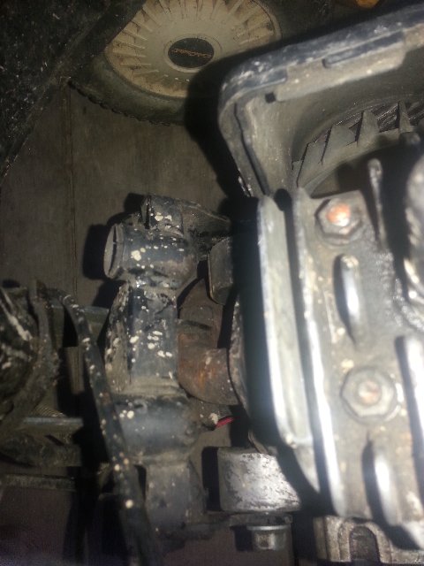

I will post pics asap. The mount is...you guessed it super fracking sketchy. The spring bumps don't really have anything to hit against, but the two square shank bolts are there for the torsion mount. The original mount used a single square shank, the Jog used two.
I'm thinking of welding some ¼ inch metal for the spring bumps on the mount to have a perch, but other than that its actually solid, even in a rough gravel road. Sketchy due to the skinny tires, and the no bump stops, but functional.

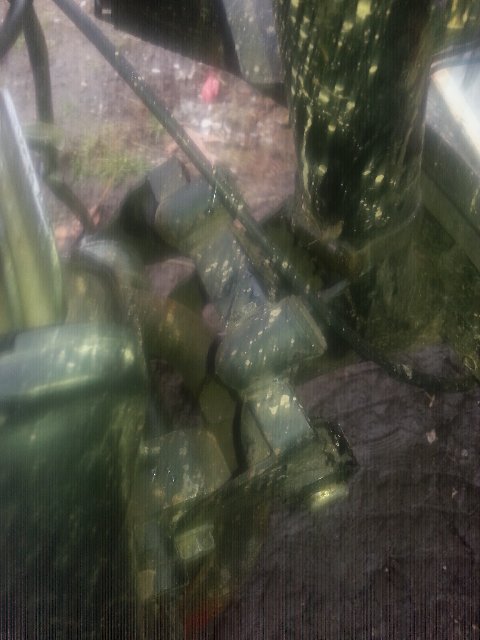

I want to see the mount! I swapped the drivetrain and suspension from a buy eye onto my Razz. It’s a different machine now. There’s a build thread for it around here somewhere. hope you can kind of see the mount and the way the pipe sets in there. This is the Jog pipe, I really want to use it, it has a better shape, bigger header with a taper, and the razz pipe is tiny as hell. I really don't want to use it...
