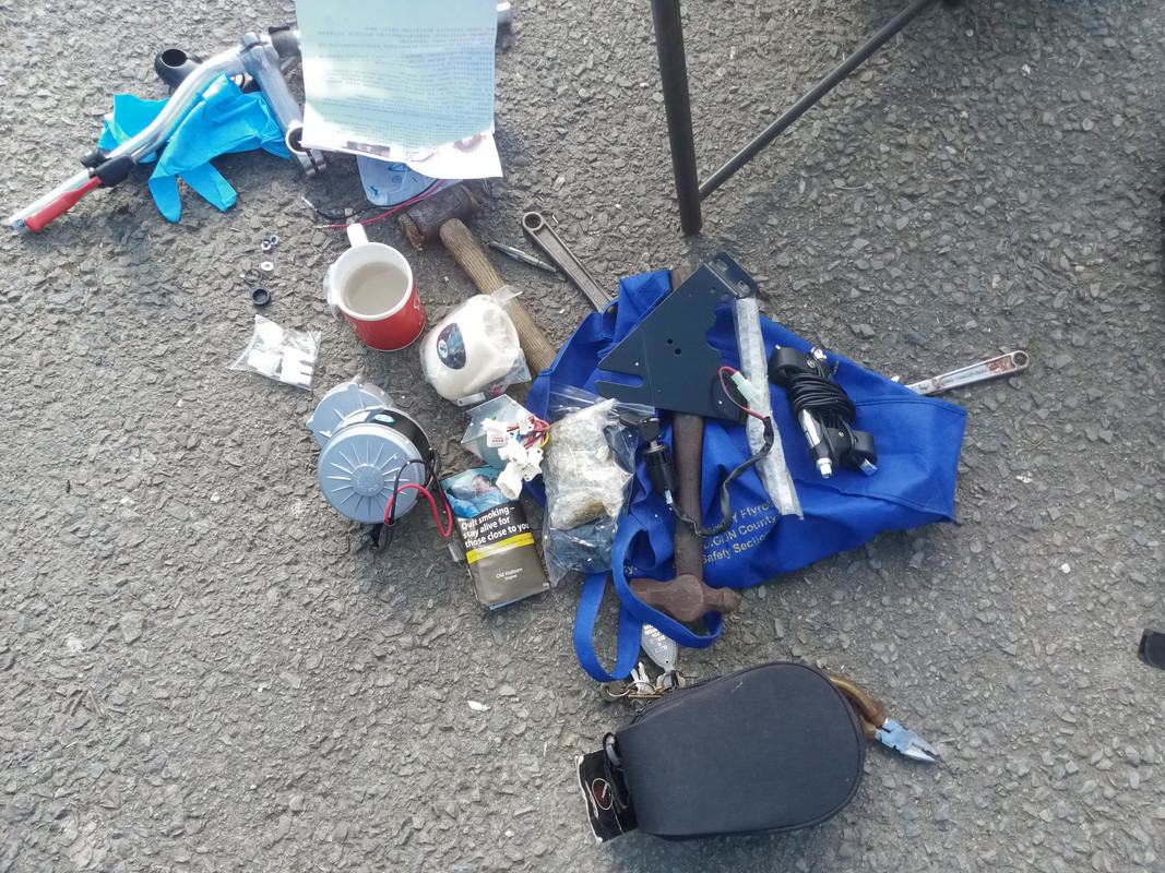

Post by milly on Apr 27, 2020 14:28:50 GMT -5

Post by milly on Apr 29, 2020 16:06:01 GMT -5
Well it won't fit Raleigh either so my friends giving me a Marin and a Kona so see if fits them.

Post by milly on Apr 29, 2020 18:30:18 GMT -5
No this one sits outboard of the frame stays and a shaft with sprocket protrude into the chain line and you have a chain from that to rear sprocket. Its really designed for single speed and you just add the extra sprocket supplied in the kit. Mounting it on multi gear cogs mean you lose one gear usually. I will try to get pics of what I mean Tom
