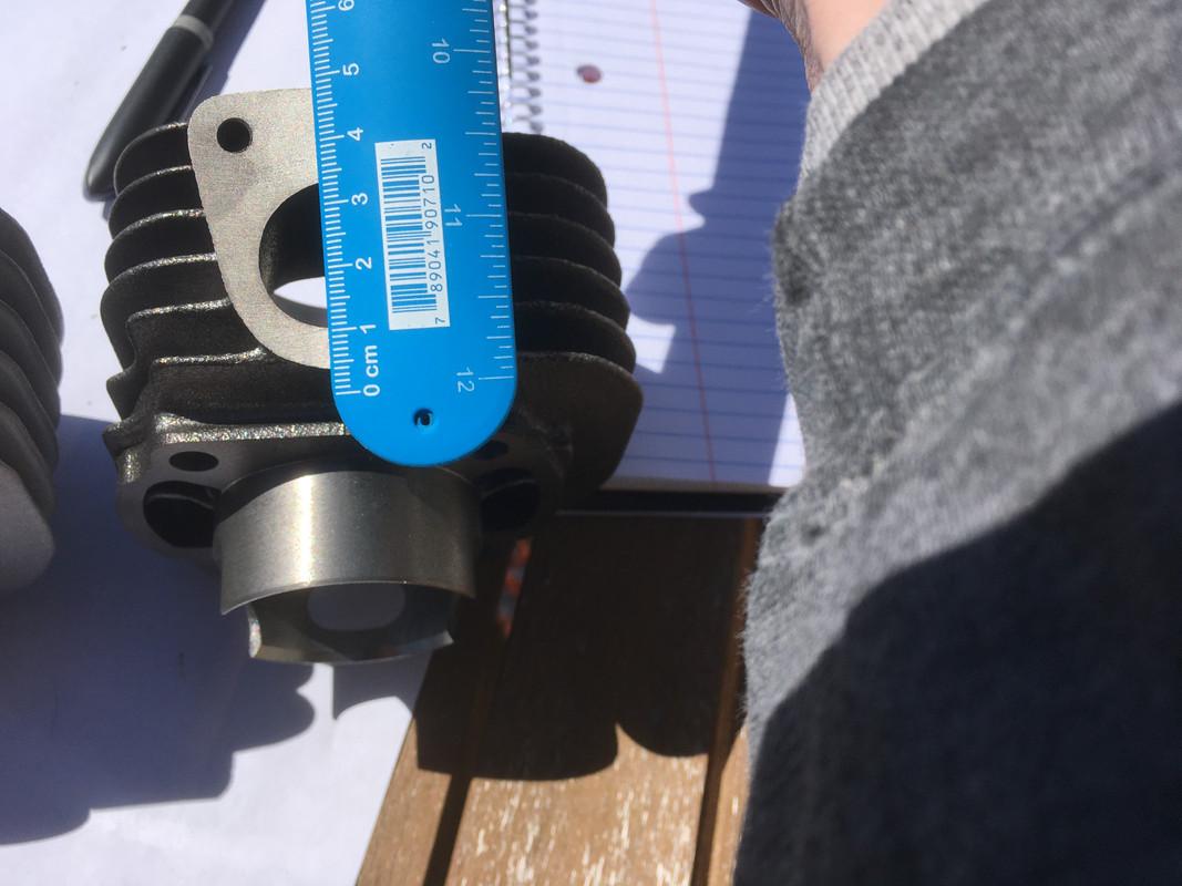

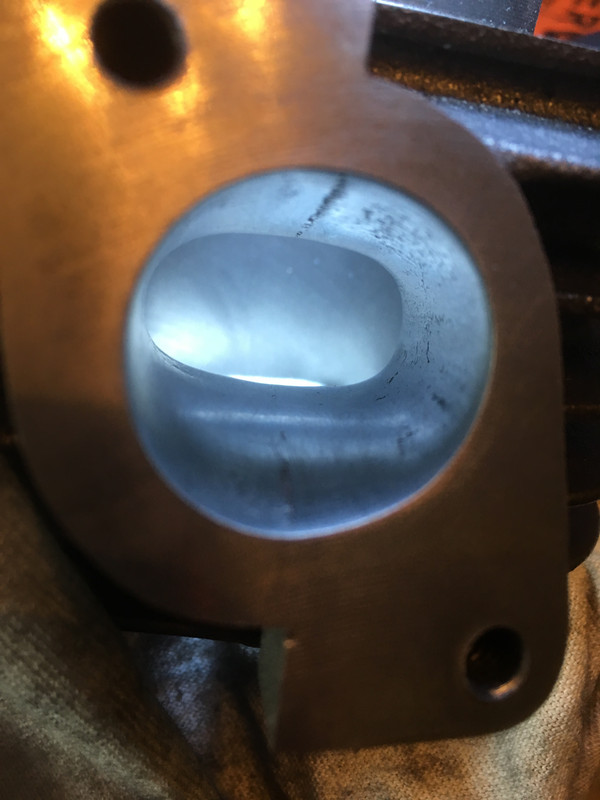

Freshened up the Cylinder raised exhaust port 1mm so I can get a little higher RPM. Chamfered all the Ports with some hobby files I bought at Lowes I find the round one works best. Just knocking off the sharp edges cuts down the chance of snagging a ring. Polished the exhaust port to Mirror finish started with Files then 60 grit worked down to 400 grit Hand polishing with WD-40 by hand takes the better part of a afternoon. The rest of ports I leave Rough and just knock out any slag . I have seen guys get to happy with a dremel and ruin there cylinder so It takes longer by hand but is safer.
Post by Zino on May 25, 2020 11:34:00 GMT -5
Also measured Up the exhaust port and matched to the Wild lion Pipe For better flow

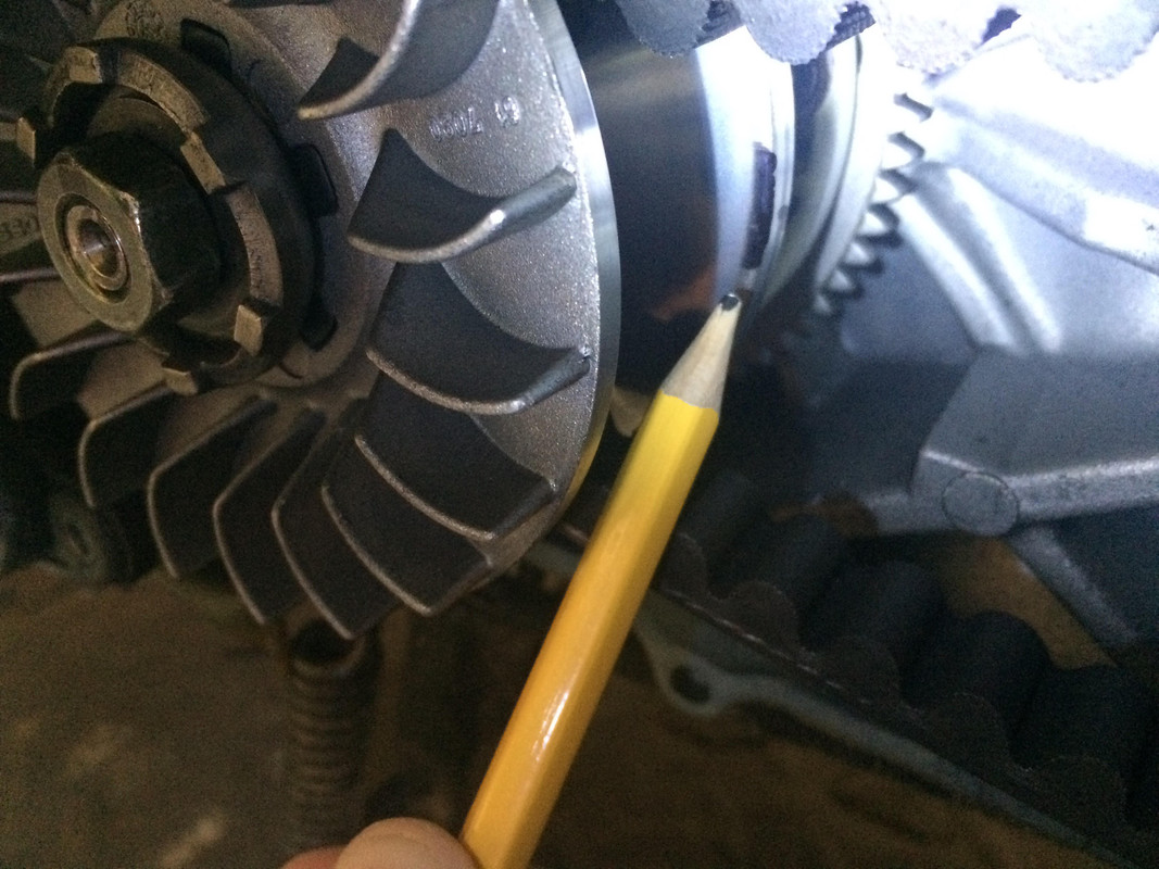

Dialed in the Cvt 6 gram sliders get the malossi variator to just under 2mm. She shifts at 8000 rpms Medium polini clutch springs work fine . clutch engages about 5k rpms Swapped a stock zuma contra in The vino one wasnt firm enough and had some belt slip . I have leaned on it a little bit It does rev past 9200 rpms

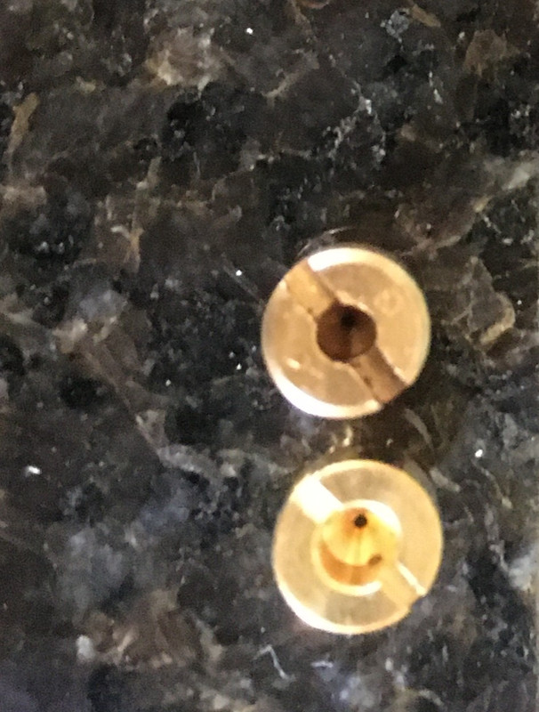

Buying the right jets Not all Jets are the same There are Genuine Mikuni the one on top and Knockoffs like these Glixals Mikuni . They are the right length ,thread size and hole diameter . One big difference is the angle of the jets and depth which changes the flow rate . The Glixal jets act about 3 % bigger compared to the same size Genuine Mikuni Jet . Based on Jet size that starts to gurgle in the stock carbs . When buying jets It pays to buy a few extra sizes in case you are buying jets cast just a little differentlly
Post by mrchilled85 on Jul 12, 2020 2:26:01 GMT -5
i have seen that with a number of cheap jetting packs a lot of them are not the right sizes
