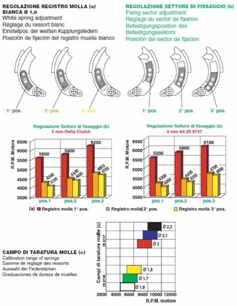

Hey Zino, care to elaborate a bit on your Delta clutch setup?
I’m running the delta on my Zuma now and could use some help. I mixed up my weights that came with the performance springs…are the performance clutch weights the heavier or lights weights?
What are your clutch settings otherwise?
Post by Zino on Jun 22, 2021 21:01:48 GMT -5
The performance are lighter so they swing out later . Lighter weights higher rpms to engage just like the variator weights .
yellow springs stiffest setting race weights has me engage above 6k rpms
here is a post from my zuma build on how i simplified tuning on the delta
With a normal clutch you typically have different tension springs typically 500-1000 rpms difference in clutch engagement The Delta Clutch Chart above Gives a Crazy amount of options and can look overwhelming . 6 different springs The delta lets me find 3 extra tension points with each spring . This lets me set the clutch to engage in the pipes powerband not before and be doggy off the line . 2 different deltas clutch weights with 3 more engagement points for each. The coolest thing by dialing in the weights that you can make the clutch engage really snappy for popping wheelies.
Here is How to methodically tune it Clutch Bite Try for Wheelies Yes Position 1 For weights No need for Wheelies Position 3 For weights Not Sure Position 2 Then Treat It like a regular clutch .( I ignored Tension 1 and 2 because they are basically the same) Start with the lightest spring. Find the Tension spring in Position 3 that when you roll on the Throttle You Jump off the line , Because you are in the power band If you roll for 20 feet then feel the scoot start pushing go up a spring.
This gave me a good initial tune . Use The Charts as a Guideline that come with the delta I found that the bottom chart was correct in that red was tighter than yellow But the rpm ranges were not at all close to the chart . The difference in weights positions was real close to correct 200-300 rpms for each position . The tensions were real close Pos 1 and 2 100-200 rpms The position 3 is way tighter 1000 rpms plus .

Post by Zino on Jun 26, 2021 22:27:15 GMT -5
the delta chart that I reference in above post .
Post by Kenho21 on Jun 27, 2021 7:39:07 GMT -5
You always come through Zino. That graphic is better than the one I’d found. Thanks!
