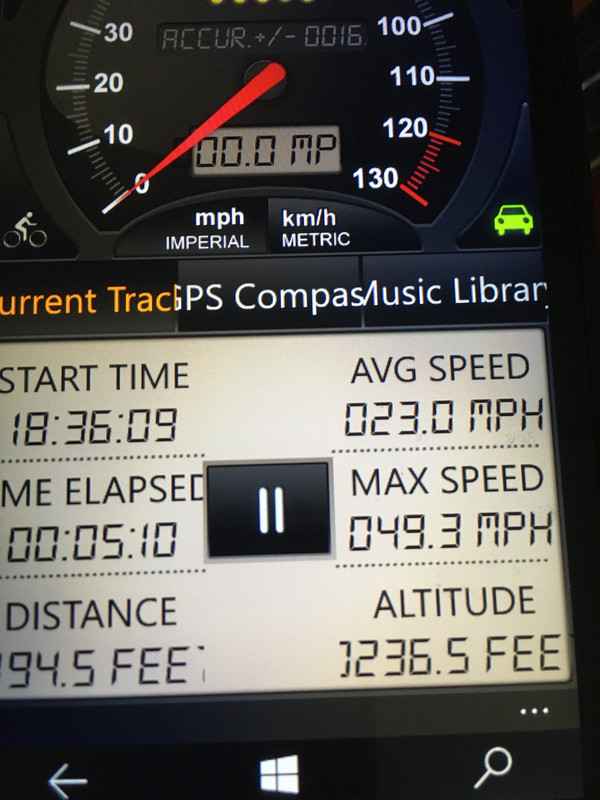

Took both scoots for a long run 30 miles each to clean out the gas . Definetely have to drop the jets . Both are running top end about 50 mph and topping out in temps at just over 300 degrees on the wide open runs My vino has a slight hesitation at take off My wifes idle is hanging a bit . Looks like time for a carb clean on stock carbs or time to upgrade to 17.5 dellorto .

Got the Carbs in Shape and Jetted them both to a 70 Mikuni Put a good 40 miles on one 8 miles wide open run Temps peaked 316 So I am in a good range the 72 jet was just a little fat .
Peak rpms on the mildly ported Malossi/WildLion Combo to 9400-9500 rpms before the jet change peak was closer to 9300 rpms The other Malossi Wild Lion combo revs up to 9100-9200 rpms When before jetting had a hard time breaking 9 K
The Mild porting was a 1-2 mm raise on the exhaust port Gave me a little more Peak rpms Both Malossi Exhausts ports were polished for better flow
Post by Kenho21 on Apr 24, 2021 18:08:44 GMT -5
What speed are you seeing at 9500rpm?
