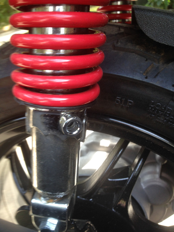

 I think this is it. I imagine there's a special tool for rotating the shock down but a big channel-lock should work if I don't mind scratching the chrome.
kevino
Posts: 107
Post by kevino on Sept 22, 2020 10:27:56 GMT -5
 I checked the other side and see there's an ALlen bolt that might need to be loosened before adjustment changes. Do I need to unbolt the shock at both ends or just the bottom for lowering? TIA, kevino

That adjustment wont lower your scooter any just firm the spring or soften it . Like oldgeek said pull the seat remove staples shave foam re staple or have a upholstery shop do it for you I have had seats recovered in three colors it only cost me 35 bucks ..
One more thing your scooter PDI's with the tools that adjust your rear shock just most shops pull them out ...

I still think it's worth adjusting the coils just to see if it helps even a little. But I already bitched up the Allen bolt by using the wrong wrench. So now I gotta pull the shocks off so I can use a vise grip to make any adjustment. How much force is the spring under? IF I unbolt top and bottom, will I be able to compress the springs enough to put the bolts back???
I called the dealership. He agreed using channel-lock and vise grips would be okay.

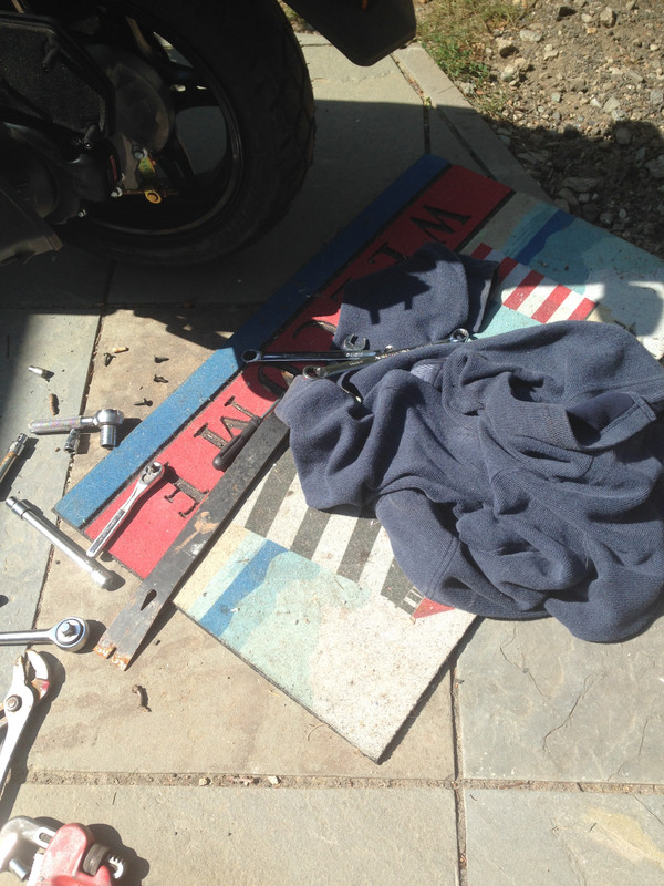

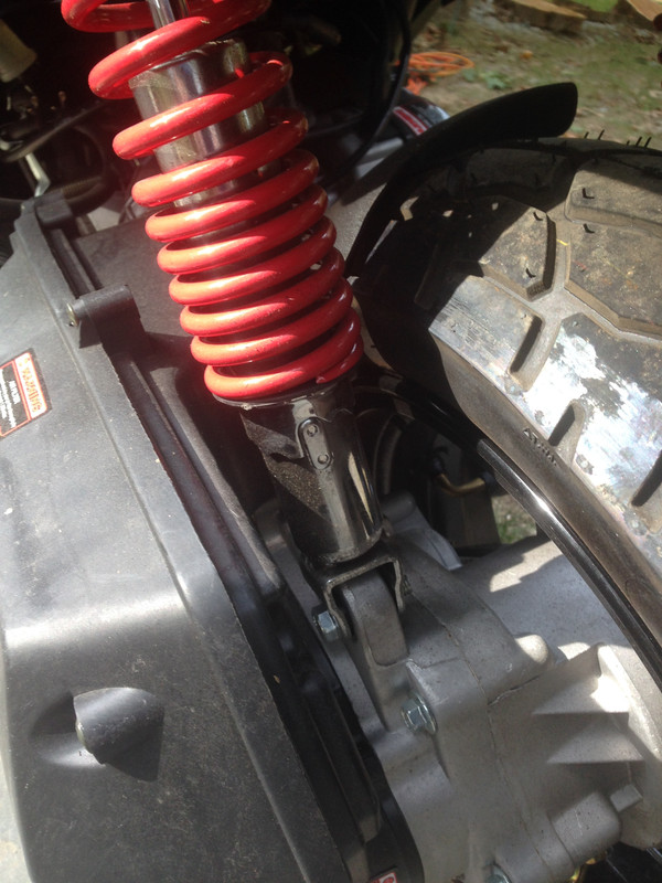

 The simplest tasks take the longest time. I want to lower the rear shocks but I need to remove both shocks to do that. I needed 8 and 10mm sockets and a Philips and a long lever to get one shock off. Then adjusting it with a pipe wrench and vise grip. My 64yr old eyes thought there was an allen nut acting as a lock but no, it's just a useless port.
