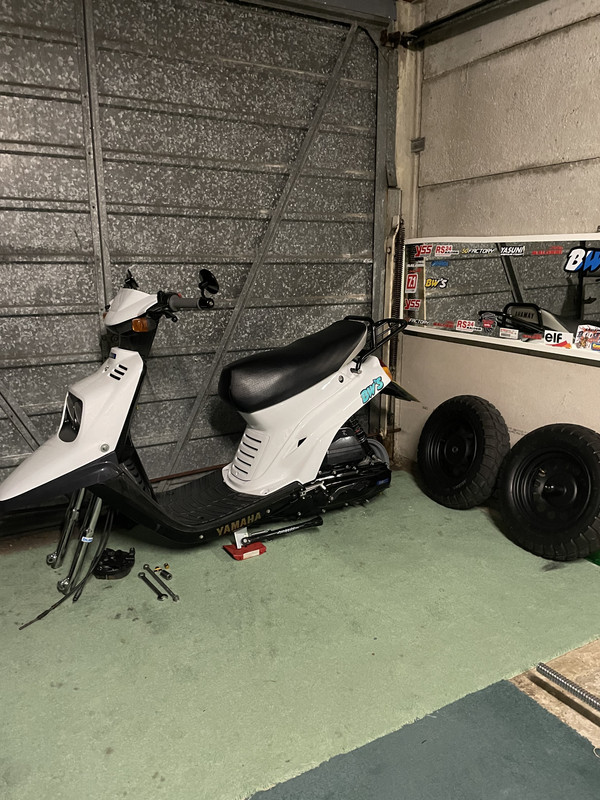

Post by yambw’s on Sept 3, 2021 11:35:57 GMT -5
Post by aeroxbud on Sept 3, 2021 12:17:18 GMT -5
Looks good. 👍
