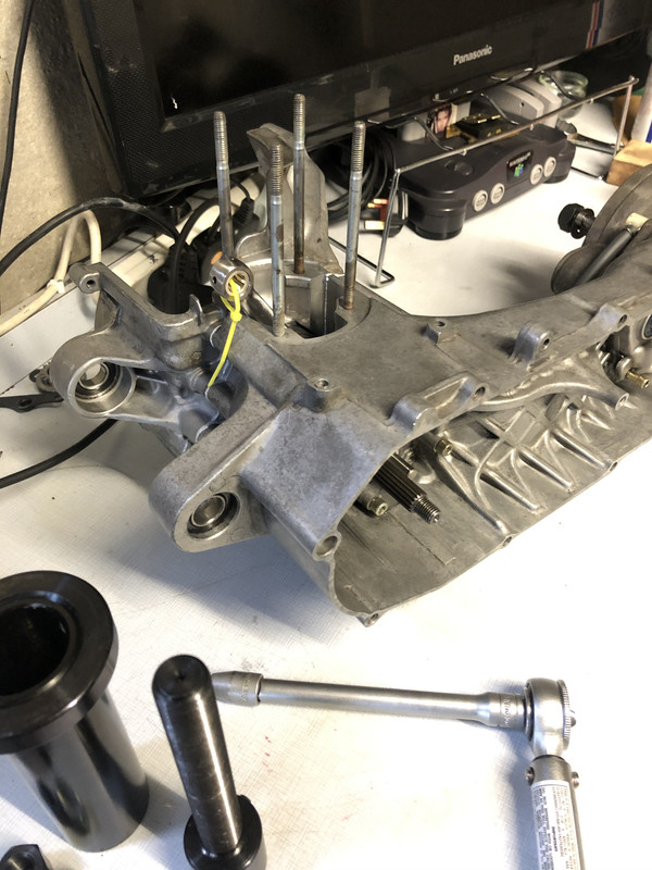

So I had a few hours free today.. bearings and crank are in and cases together I copied 90gtvert’s technique except I used a heat gun rather that the oven, worked a treat also went with 1184 in the end as seen in one of his YouTube video I liked the way it stuck to the cases all be it a little runny crank just needed a little tweak with the crank puller at the end
