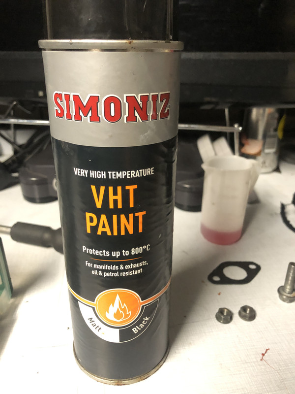

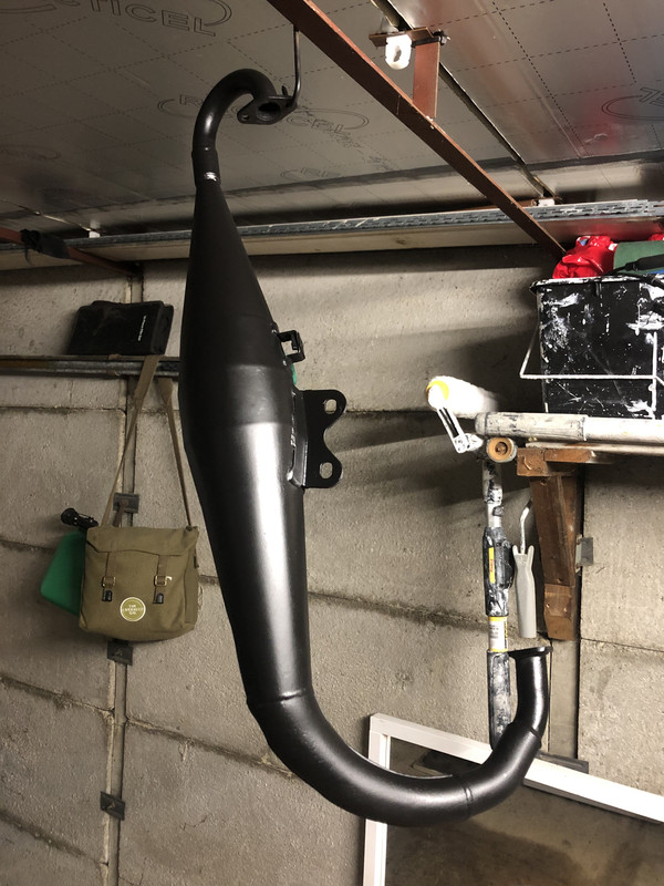

Wasn’t happy with Halfords vht paint, was really chalky, the paint from them is usually very good. Anyway gave it another going over with another brand and it’s come out with a nice sheen now. Much better ! I recommend highly ![](https://i.postimg.cc/yY66b5p8/C1072-BD9-6-BF4-49-BE-9382-47182-ED2-E3-D4.jpg) ![](https://i.postimg.cc/x1h0qdfX/F9-ABE492-800-A-4818-9-A40-F6-ABA529-DD9-E.jpg)

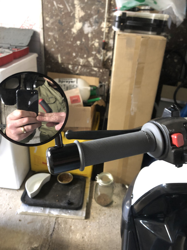

Found these natty little mirrors, anything else just looks to big on such a small bike ![](https://i.postimg.cc/L5gvj2TV/4-AB5-F948-8-DF2-4-E08-976-B-97-F4-B8-F4-C6-B0.jpg)
