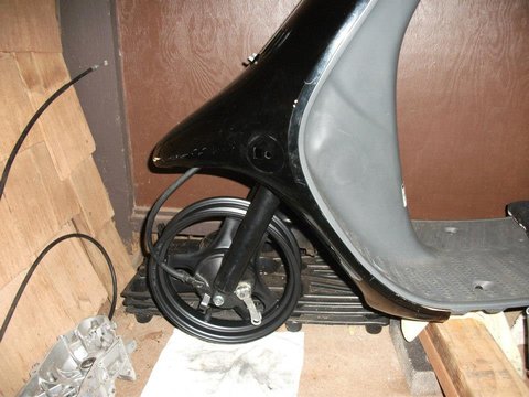

I had metro forks lowered with a spring kit i forget where I got it from its was 10years ago. Also running an 80/90 front tire. I also used a Gdash stem. It bolts on. U can use a dio zx stem too but there is less clearance with the inner leg shield. My current 89 also has a Gdash stem but i went disk brakes instead of drums

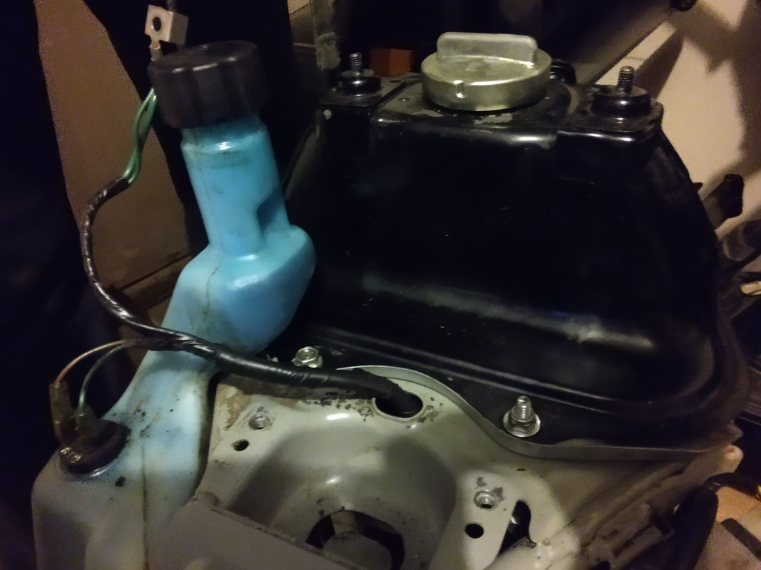

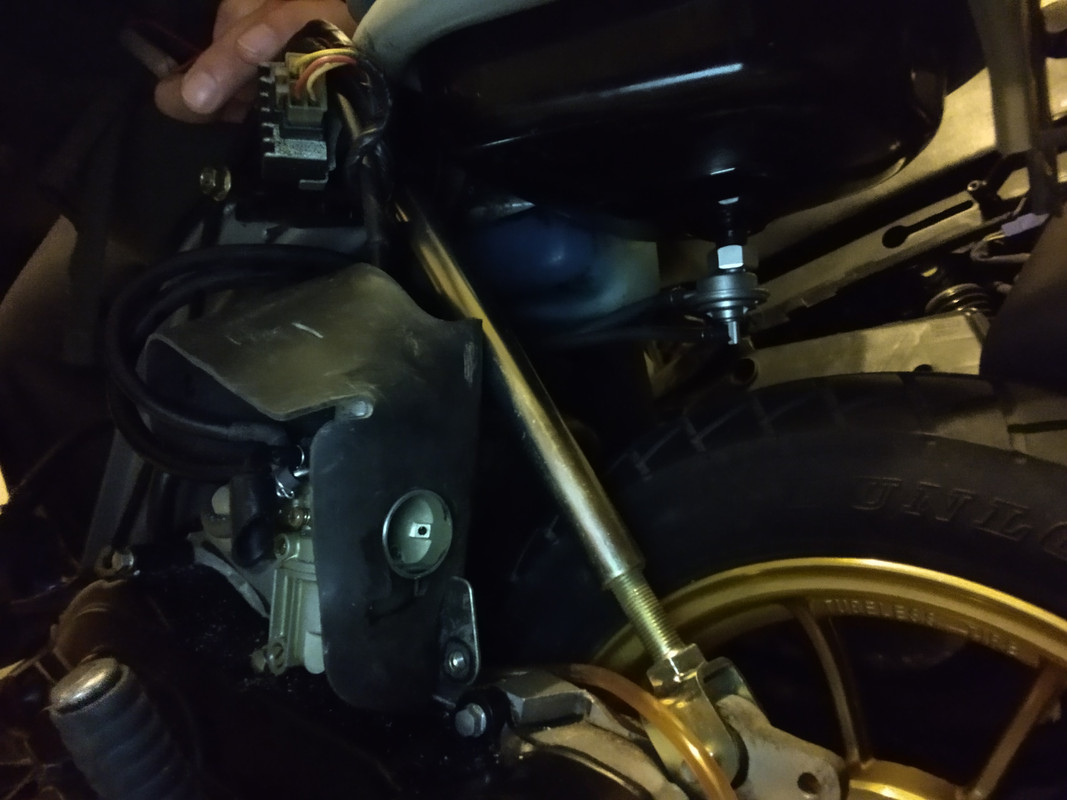

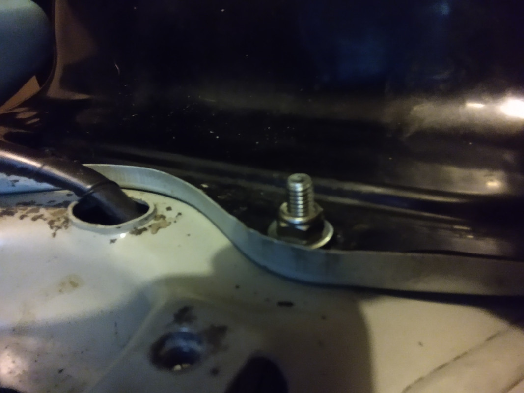

Here are some close up pics of the (a)sss shock mount install. Fairly easy, but no instructions so I thought I'd enlighten. So, first I pulled the center spacer out of the oem shock to use on the (a)sss mount. Then I had to figure out how to bolt it to the frame. There is a hole that lines up closely with the gas tank bolt, so I used a 6 mil thread hex bolt with a washer to bolt the other side of the mount to the underside of the frame to the nut-sert that the gas tank bolts into. Then, I used a nut to hold the gas tank down, so basically using the bolt from underneath as a stud. Then I used a sspg drag link from www.partsforscooters.com (great store) instead of a shock so it has a hardtail rear end.

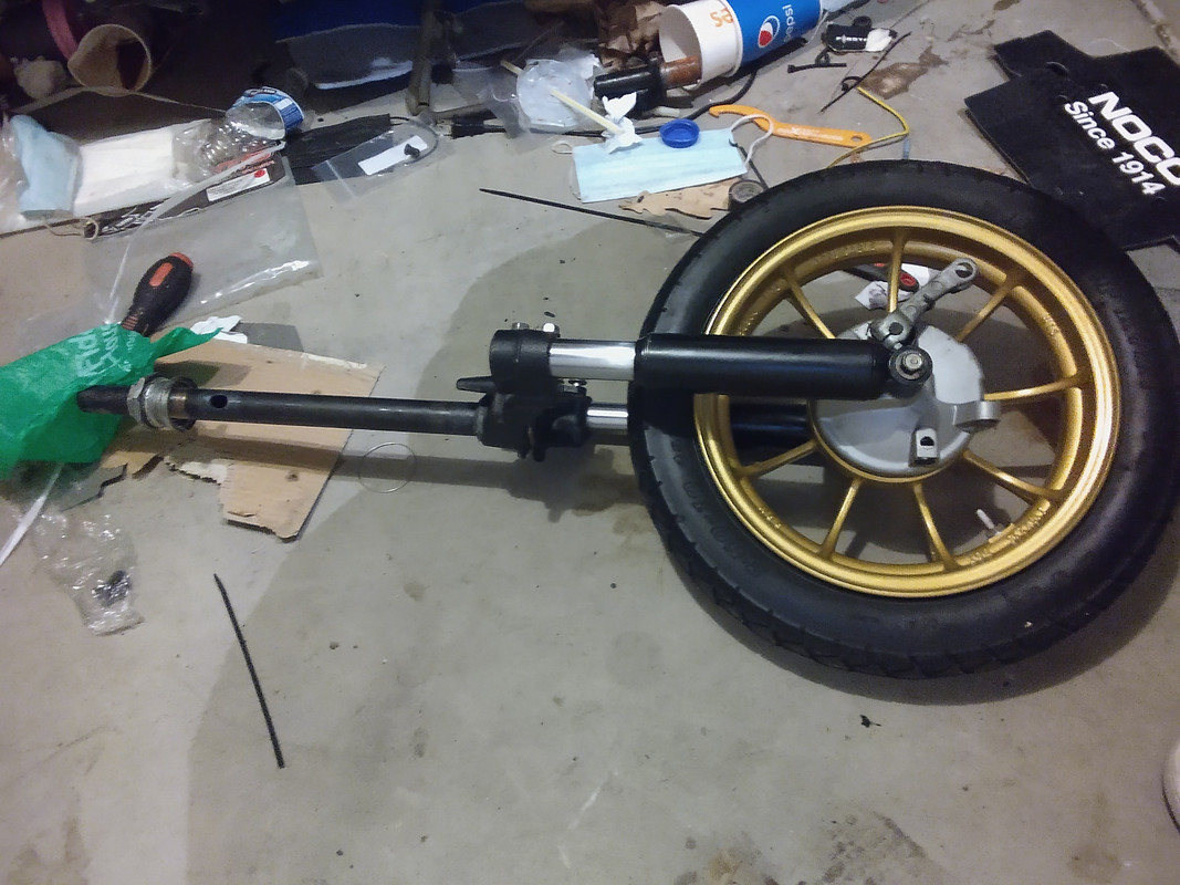

Jst4shw rucks came thru, man these are short. Still has the OEM travel too.

That front end looks amazing.
What lowering option did you choose? 2, 2.5, or 3 in drop?
Post by benji on Mar 22, 2022 11:14:02 GMT -5
3", I wanted the big drop
