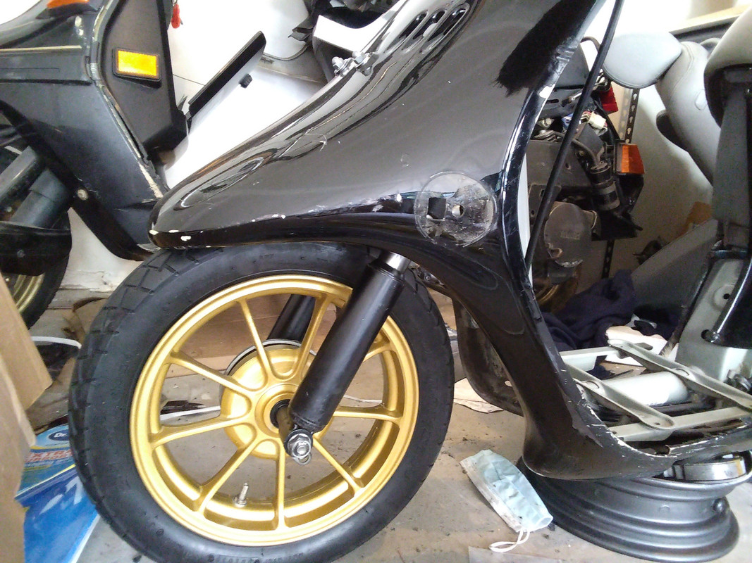

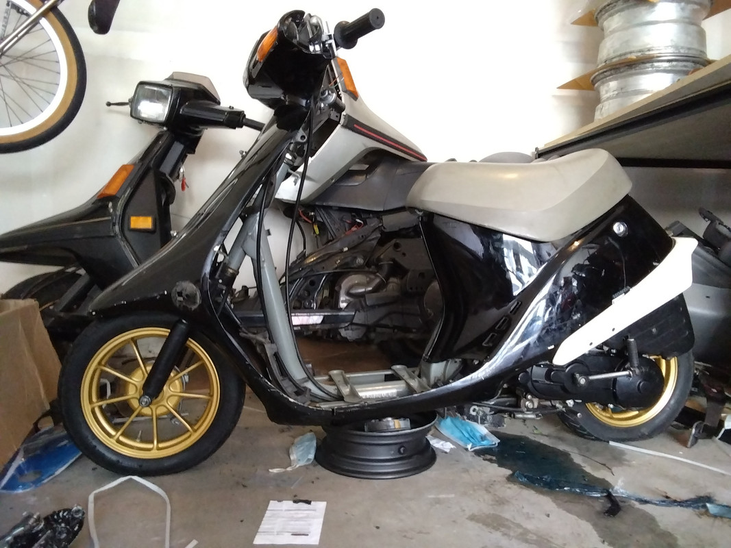

![](https://i.postimg.cc/28QB8WhM/IMG-20220422-093127359.jpg) ![](https://i.postimg.cc/wMK79xv9/IMG-20220422-093048849-HDR.jpg) Fits in but Rubs the plastics a little, but should be fine since it's hard tail 🤣 The front wheel has just enough space for travel ![](https://i.postimg.cc/RZvJ30TF/IMG-20220422-093205677.jpg)
