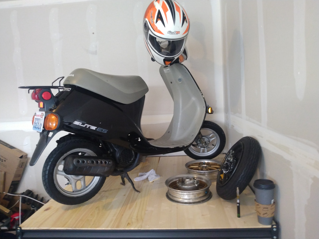

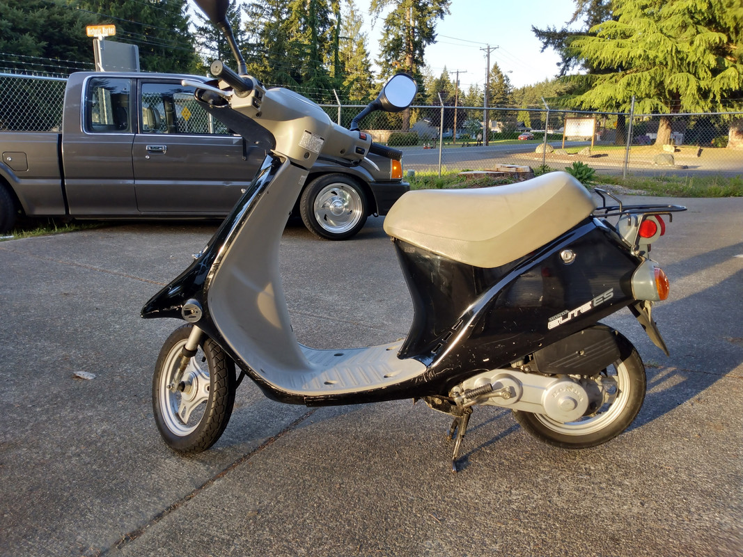

Hey everybody, picked up another one. This time a clean little Elite ES.

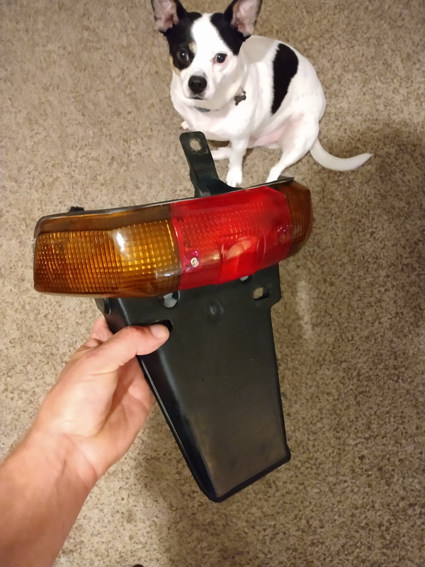

I went ahead and picked up a JDM pal taillight and a sa50 version of an af05e motor for it. I'm not 100% sure exactly what my plan is for this one. The motor I picked up was real low mileage, so I might keep the bore and pipe stock, with just some cvt upgrades.

....aaaand I got the wrong taillight. But that's ok. I guess the bubble tail for the pal is hard to find so it may take a while for one.

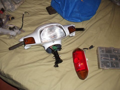

Post by Sum-azn-kid on Jun 1, 2021 4:14:35 GMT -5
That light is for the Honda pal with bumpers. U need the jdm panels to use it

Post by Sum-azn-kid on Jun 1, 2021 4:18:57 GMT -5
This is the bubble tail. I prefer this look over the bumpers
Post by benji on Jun 4, 2021 10:59:53 GMT -5
This is the bubble tail. I prefer this look over the bumpers you know of one available? I can't find one unfortunately.

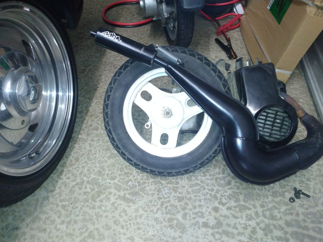

Sa50 motor and mlm techno EDM pipe.
Post by benji on Jun 5, 2021 4:07:09 GMT -5
I'm still deciding how far to go and what direction. I'm thinking of using the stock bore, as it's a really low mileage motor. But I'm obviously gonna do cvt work and a pipe. Supposedly, this motor comes stock with an 88mj so I may not even need to do any carb tuning for the pipe.

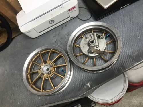

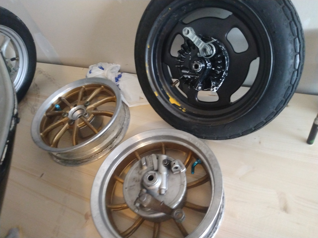

Got myself some rims for my birthday 🎂

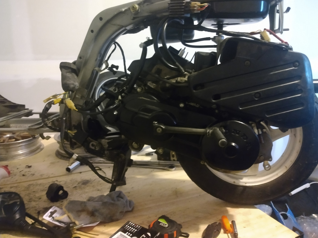

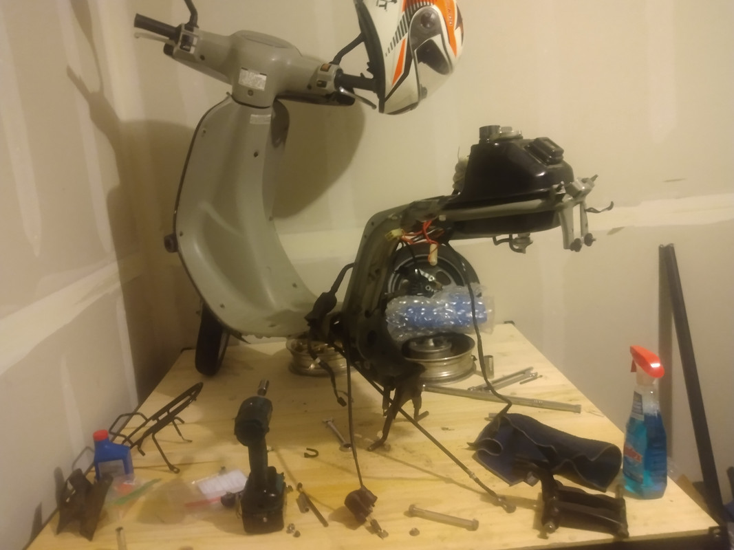

Post by benji on Jul 17, 2021 0:24:54 GMT -5

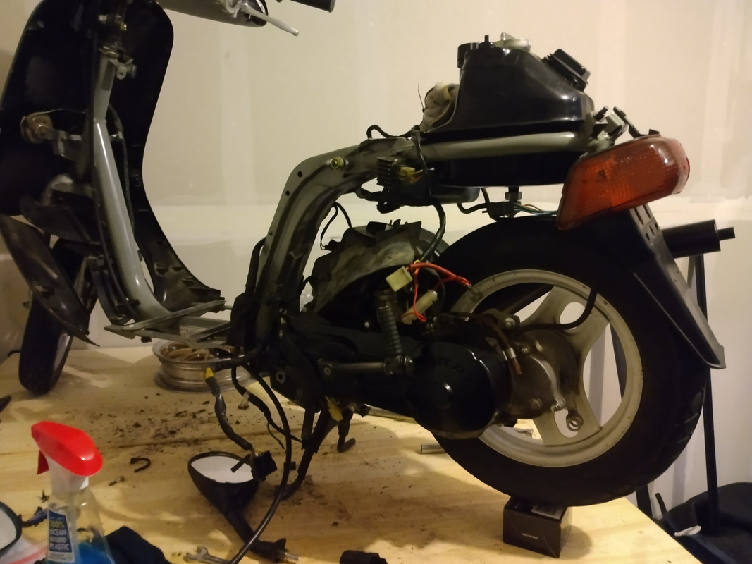

Ok, big post here Finally got around to starting this project. I have pretty much all the parts ready, except maybe a front fork if I need one. I even got a little scooter bench going.. Elite SA50 motor I'm using (af05e)... Wheels I'm gonna use.. either the koso wheels, or ruckus wheels, or maybe SA50 white wheels since I have one already.. And my JDM taillight I'm gonna try to use.. [/url
And here she is about halfway into the motor swap..
...and now it's late, I'll finish up later this weekend probably. Time to let the puppies sleep

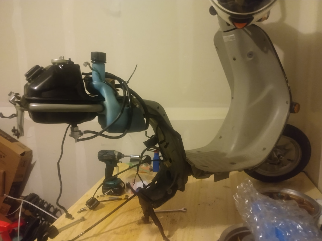

Post by benji on Jul 19, 2021 0:06:12 GMT -5

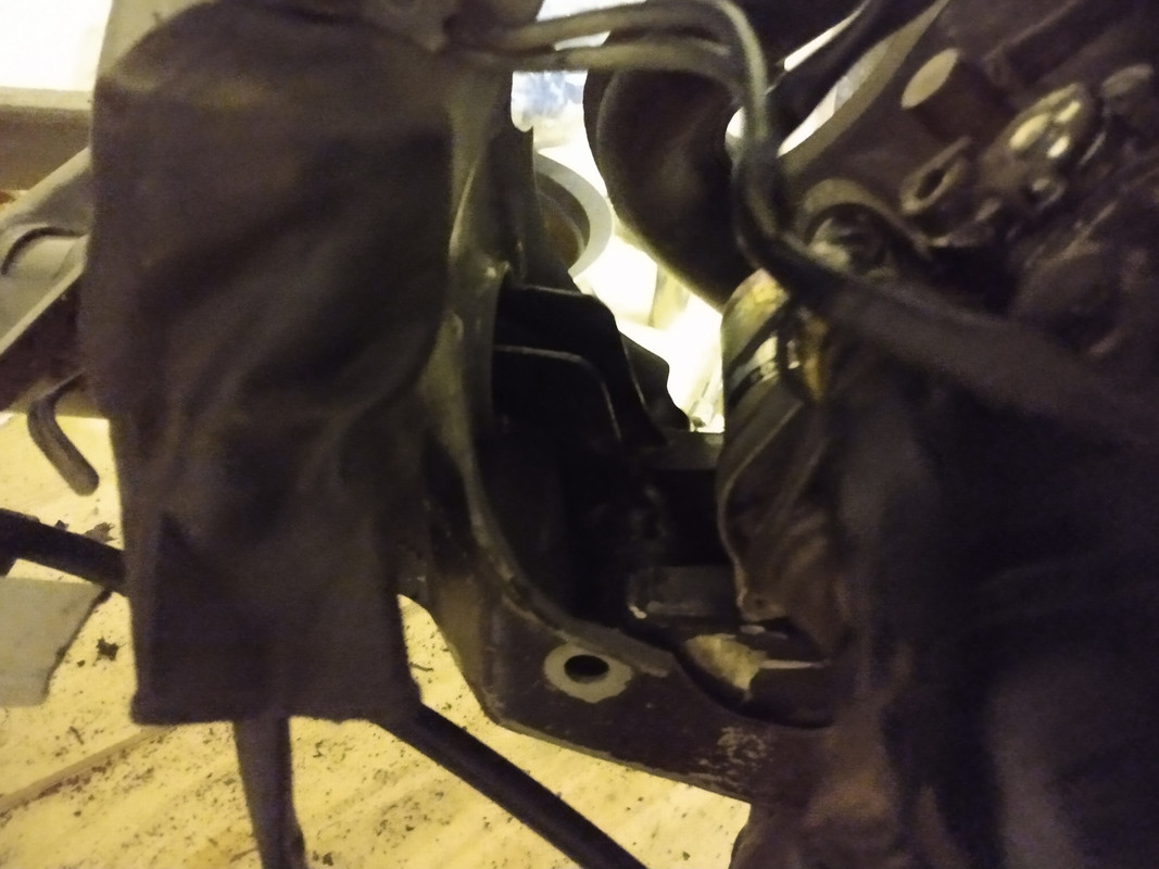

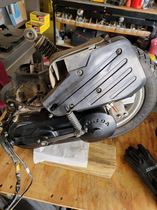

I was able to out some more time into this tonight and got pretty far. Got the mount cut and fit, I still need to drill holes in the frame for it. Looks like I might be able to keep the stand.. I need to dig thru storage and find some parts.. a solid strut rod for "suspension", and some other odd n ends like a throttle cable/slide, etc.
Post by benji on Jul 20, 2021 0:49:14 GMT -5

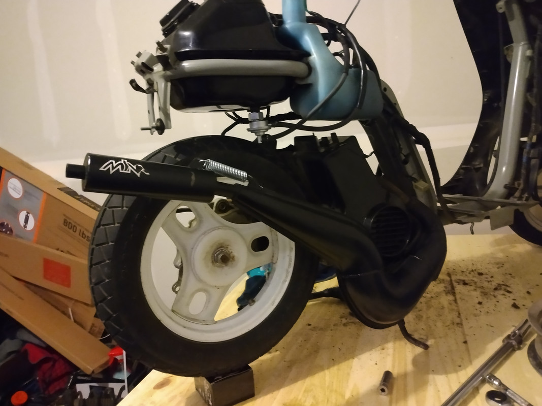

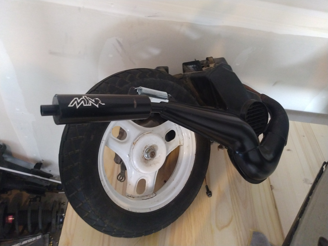

I was able to finish the mount and get the motor on.. still need to take care of some odd n ends. Mocked it up so I could see how the pipe fits. Man, I need to find a pal 2 JDM taillight or find some pal taillight bumpers.
