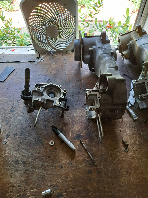

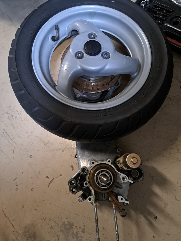

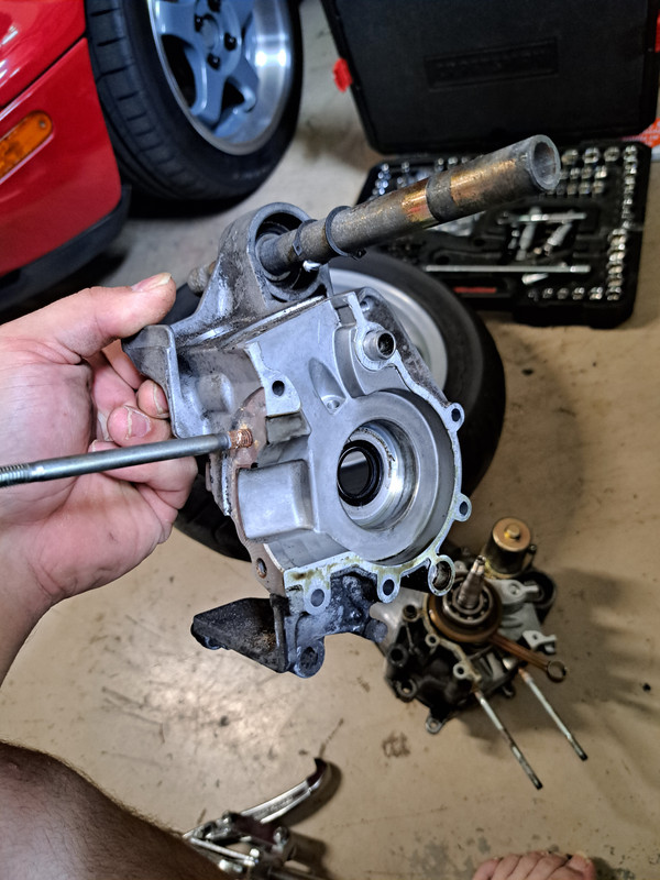

![](https://i.postimg.cc/t4hDqTpH/20220722-135708.jpg) ![](https://i.postimg.cc/s2jLbSSL/20220722-135730.jpg) ![](https://i.postimg.cc/13Z2cbzs/20220722-144430.jpg) Went through one of the toughest parts without a proper tool. A 3 jaw puller made the stator side simple. Cvt side not so much. As much as I thought i cleaned the engine there's still lots of grime. But now that it's apart I can clean it up. And get the ports flowed. Nothing insane as I don't want to do the whole jb weld thing. But enough to flow well for the stage6 mk2 racing, and I guess for whatever future cylinder may find its way to the engine? Just hard to find time with 2 large breed dogs that always need to be cared for (not complaining I love these guys) but seeing one is only 8 months old I gotta keep an extra eye on him when the wife is away ![](https://i.postimg.cc/qMgvHhcz/20220719-234611.jpg) The big guy moved ruining the picture -.-

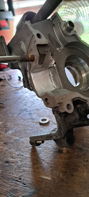

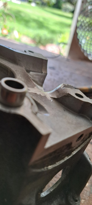

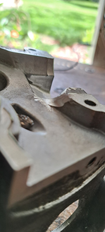

![](https://i.postimg.cc/mZN3Nwd7/20220725-123030.jpg) ![](https://i.postimg.cc/jdMzBjY5/20220725-123035.jpg) Here's my rough draft, making the shape I'm looking for. Then will sand then with a Dremel bit and hand sand for a smooth finish. It's nothing insane like I've seen here but I just really want to ride the scooter.

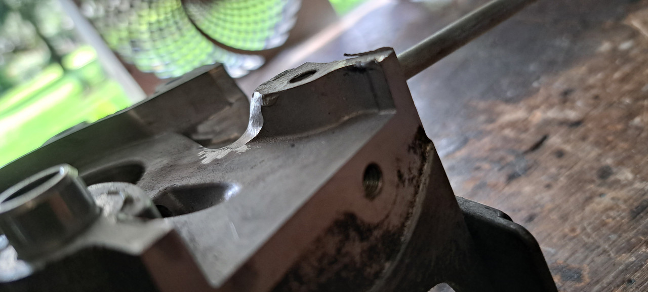

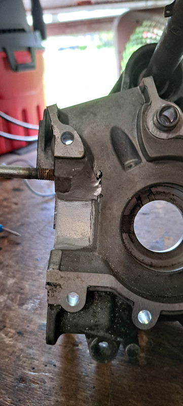

![](https://i.postimg.cc/Y24py2x8/20220731-105435.jpg) ![](https://i.postimg.cc/prkyZsvr/20220731-110350.jpg) ![](https://i.postimg.cc/022zQ1Gw/20220731-111526.jpg) Continuing the process of smoothing things out. Gonna call it soon as I did way more stuff than I originally intended. Now gotta measure this side and mark up the cvt side and give it a go.
Post by x7rocks on Aug 1, 2022 9:03:58 GMT -5
Cvt case has the shape I need made. Now to flow it into the ports a bit better and hope I don't cut through the case. But hoping by tonight I'll have bearings installed into the cases then slide the crank into the cases.

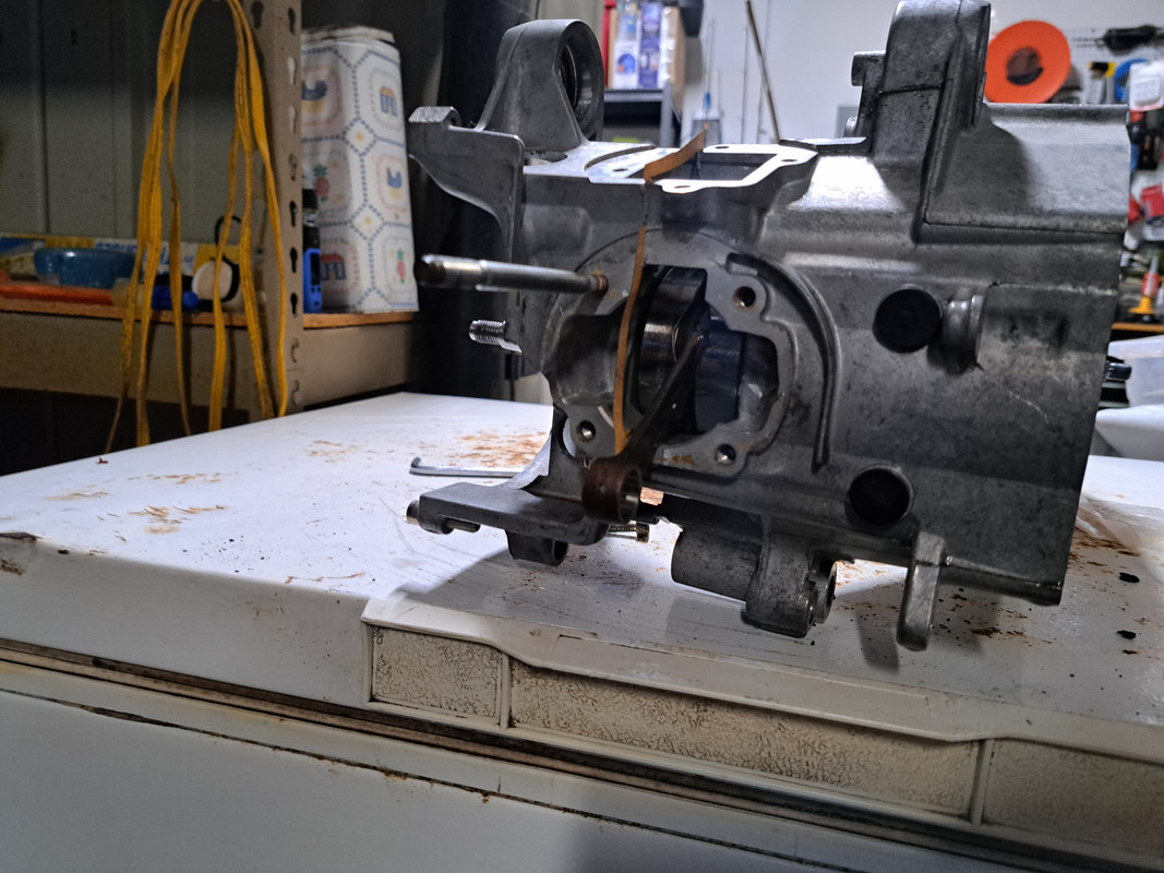

![](https://i.postimg.cc/s2c0pXV7/20220804-191526.jpg) ![](https://i.postimg.cc/NFWNg24q/20220804-191600.jpg) Crank and new seals installed. What a pain but it's done. Though I thought when heating the cases with the bearings put in, I noticed the cage holding the bearings became discolored. They roll nicely with no sound so I should be alright.

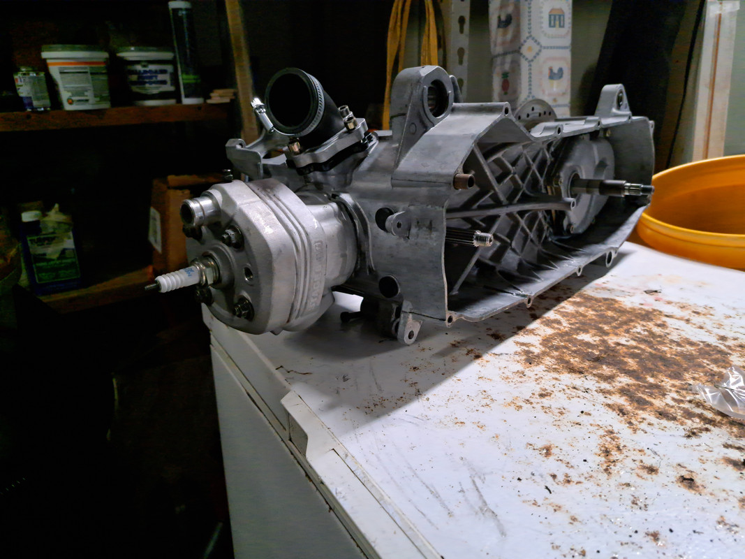

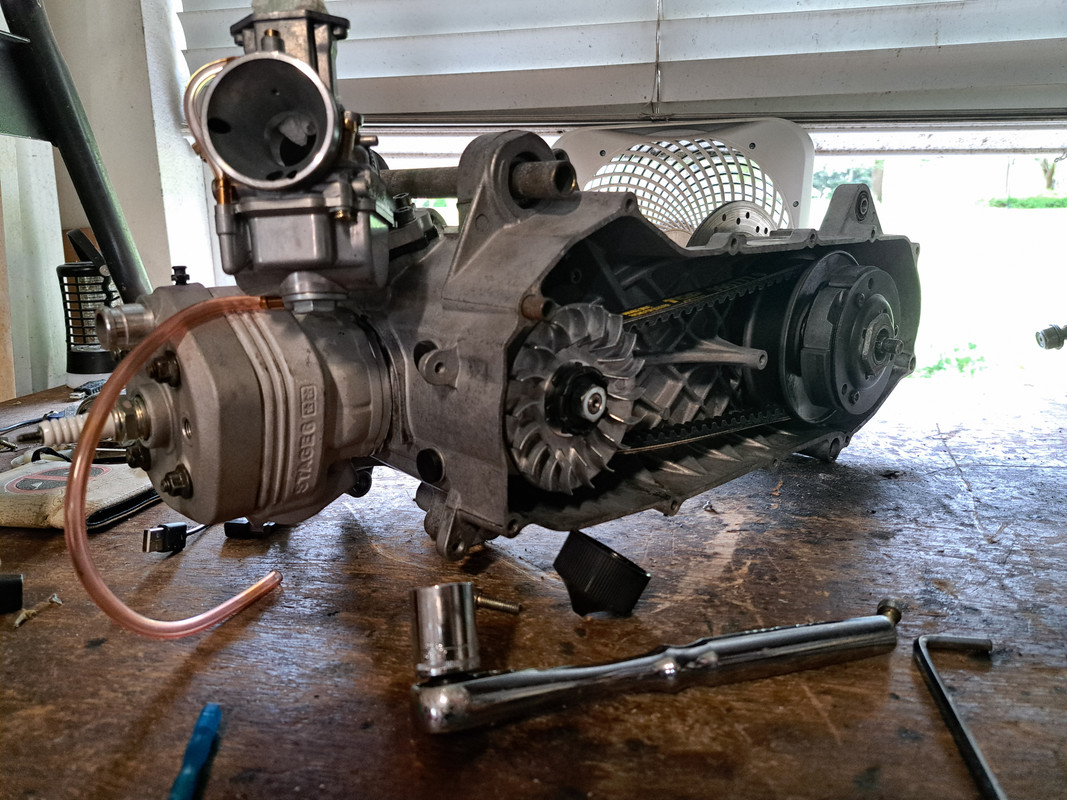

![](https://i.postimg.cc/d1TMPR40/20220814-191103.jpg) Slow progress but its being done. Topend has been installed and squish at .06, 9 range plug. Polini not fitted all the way( figuring out the right way to face it). Will work on cvt next. Gotta install some red clutch springs, pink rear torsion spring and the tp variator kit. Should look nice when it's all said and done.
