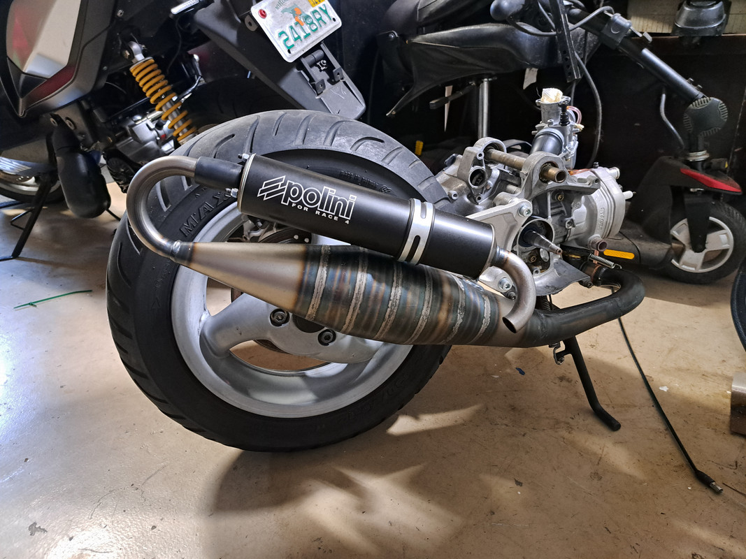

Update. The starter gear moves freely Just had to give it more oomph than before.

 My updates suck. But she's pretty much all there. Need to modify the mounting bracket slightly for the cylinder being moved up. About 20 minutes of Dremel work and should mount easily. Then my first start. Hopefully I can compile a decent enough video of the build (feel like stopping to record progress makes the build time go longer)

Engine is in. Fuel is primed.
And now I have no spark ðŸ˜ðŸ˜ðŸ˜ðŸ˜ I have an mvt millennium coming in the mail tomorrow. Hoping I can give you guys a first start video.
May also need a new kick starter hear as the teeth don't seem to grab the piece on the variator all that consistently.

youtube.com/shorts/RttKxuz18Ns?feature=shareI fixed the spark issue and she idles perfectly 😊 can't wait to do the finishing touches. Add coolant. Fix kick starter assembly (doesn't want to grab now) Fit air box. Connect lower exhaust support Connect cylinder temp sensor. Then I can test the current springs (malossi yellow) and add red if necessary and test the weights and jetting.

Sounds great With that pipe your going to need the red springs . With the race weights in the delta clutch to launch like a rocket .

I also fixed my Kickstarter issue. Gonna upload a quick cold start for you guys as I connected all the coolant lines and worked on my airbox to fit such a tiny spot.
But I need to downjet. I can do half a throttle with no issue. But full throttle will 4 stroke like crazy, so I will try a 120 main jet.
Springs need to be swapped to red as it engages just a hair short. And will need an overhangs belt for the rear pulley to have full travel.

youtu.be/HwxhlGdBbxECold start. Gonna give the ruckus the works then try a new main jet. But you get an idea on how an 85mm rod sounds on a stage6 mk2 cylinder.

Got the intake worked out for the airbox and went for the first run. She definitely hits the pipe running. An before I noticed the speedometer it estimated me to do be doing 50 mph.(don't know how accurate a malaguti speedo is) but I'll take that as a little victory. Temps were near 150 f when I did my 2 wot pulls.
Though I can feel some hesitancy to rev so I do believe a clip or a main jet needs to be adjusted.

youtu.be/AkZPJ-VgxHEHere's an update video for you guys. Changed main jet to 115, and raised the Clip on the needle to clean up the lower end. Sadly after a few wot pulls my polini exhaust gasket failed and created a big leak. I rode it home praying it wouldn't do any cylinder damage and I think I am in the clear. I'm also most likely going to be changing job positions as my current jobs work environment (not the people the fact its a 100 plus degree warehouse) isn't doing good for my skin condition, which after covid. Has caused me to suffer psoriatic arthritis. Making it difficult to move my hands. This is a very upsetting situation as I need my hands to make a living. So I'll be going over a month long process of finding more desk style jobs. Maybe even door dash on a scooter. But will keep you guys updated on this bike and the rs125r hybrid motor.
