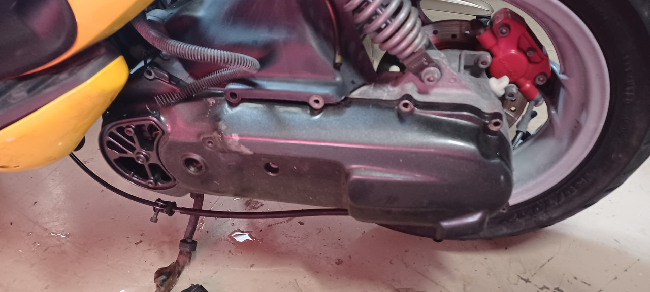

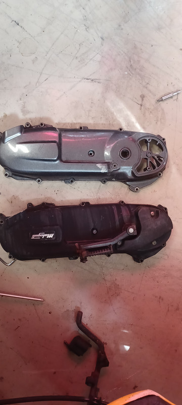

Your case is also different from mine! Mine looks like a top performances cvt cover. I'll snag a photo of these two next to each other when I get to the cvt. I'm slowly working my way to getting all the stock parts off. So far. First install will be cylinder. Then Intake /carb figure out the throttle cable situation to see if I can use the stock throttle (is the stock throttle a quick throttle? There's almost nooooooo play from 0 to full throttle on this thing) Then exhaust and cvt (gotta wait for springs and ordered a kart airbox just incase the stock airbox idea doesn't work as I am on the boat of keeping it left alone for any future build. I do have stage 6 orange springs and a delta sitting here at home (but the 122mm pulley and delta are at my mother's house that I forget I left there) But. If I can get the scooter started. I can fine tune during the week. Im very excited. And definitely appreciate the pics of your f12 sir. I am quite jealous of the cool logo over the cvt.

The side case was the same as yours originally but I swapped it for a Yamaha neos one I had lying around.. I’m looking forward to following the build !

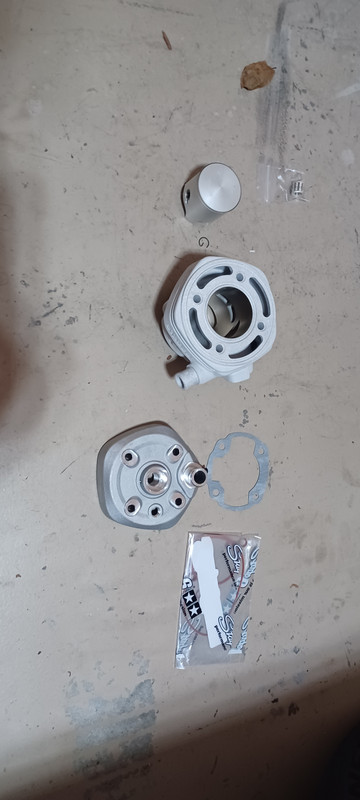

Sad and small update. I got an air-cooled cylinder ðŸ˜ðŸ˜ðŸ˜ this is what I get for getting a little sick last few days and not checking the cylinder.
But we solved the problem and just ended up going for a stage6 mk2 racing.
Honestly I deal with Burke Kellermann on Facebook and he helps me out with anything I need. Hopefully the cylinder will be here by Tuesday So I will just install the intake. Carb and cvt parts when I can today.

![](https://i.postimg.cc/cJVvPYm3/20220612-093101.jpg) ![](https://i.postimg.cc/xjGXFXbk/20220612-093225.jpg) Tpr does seem to be the same. The intake for the fan is even swappable lol
