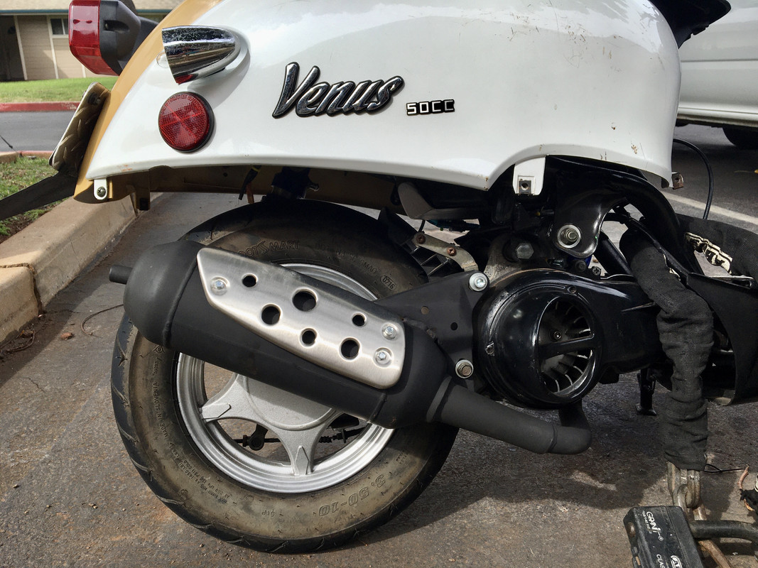

Well, I brought the scooter outta the shed after 2 plus years. Brought the beast home from the in-laws. The HOA I live with is strict on loud exhaust, and so is the state of Hawaii. My goal is to make a reasonably quiet, fast moped with the cylinder I got currently.

Took off my custom PG Long, & Swapped to a Aerox 100 technigas silent pro, and didn’t make any other changes

Post by mauibird on Nov 23, 2020 23:55:36 GMT -5
Took her out, hit 60 at 8750 rpm’s. Definitely quieter, than the PG LONG. It ran well, pulled hard. Carb seems pretty close tuning wise. I Let her cool down , retorqued the head bolts, and checked front belt travel. I’ had at least a quarter inch left to go on the pulley, so I upped the variator weights to 45 grams and now I’m hittin 69.7 mph ( on gps) at 8450 rpm’s. My temps are way down compared to the pg pipe. WOT stayed cool, mid throttle got a little warm, so I’ll drop the needle clip next time I go out. I also bought that polini curved air box., to see if I can get that to fit and quiet things down more. There is a lot of sound coming out the carb.
Post by mauibird on Nov 23, 2020 23:58:32 GMT -5
For reference: with the PG pipe, max speed was at 79.3, @ just under 10,000 rpm’s. So I’m definitely happy with the results.

Post by mauibird on Nov 24, 2020 0:27:04 GMT -5
Zuma 100cc Tecnigas Silent Pro
