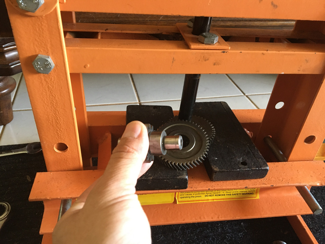

Post by mauibird on Dec 9, 2020 18:16:40 GMT -5
Pressed off Polaris gear

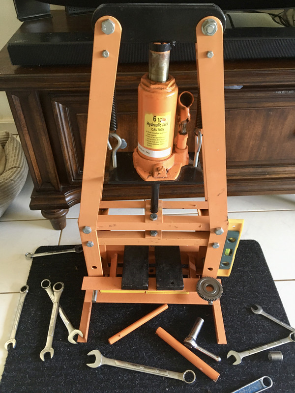

Post by mauibird on Dec 9, 2020 18:17:40 GMT -5
Harbor Freight 6 ton tabletop shop press

Post by 808ministroke on Dec 9, 2020 20:39:53 GMT -5
Super glad you posted that gear pressing video as I am send to embark on my own gear adventures I've used to press for pressing in-and-out Conrad's of a crankshaft but never gears yet If you don't mind can you shed some light on exactly step-by-step what you did to remove the old gear before pressing on the new one,? Again bro great build really enjoy it and I'm actually excited to see how this ratio works out for you Aloha.

Post by mauibird on Dec 10, 2020 12:02:30 GMT -5
Super glad you posted that gear pressing video as I am send to embark on my own gear adventures I've used to press for pressing in-and-out Conrad's of a crankshaft but never gears yet If you don't mind can you shed some light on exactly step-by-step what you did to remove the old gear before pressing on the new one,? Again bro great build really enjoy it and I'm actually excited to see how this ratio works out for you Aloha. You literally just press the gear out, it only goes one way, just as easy as the video I posted just opposite... good luck!
