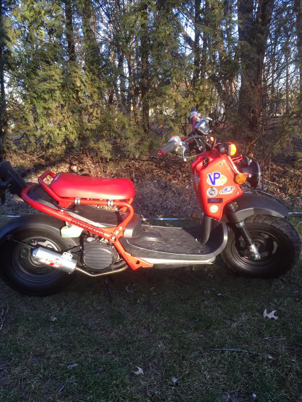

Post by Beets on Feb 4, 2019 20:26:49 GMT -5
Latest pic after new bars and seat lowered
Post by lilpinny on Feb 4, 2019 21:25:41 GMT -5
You’d gain a ton of speed if you got rid of all the weight. The floorboard and the center stand are boat anchors.
