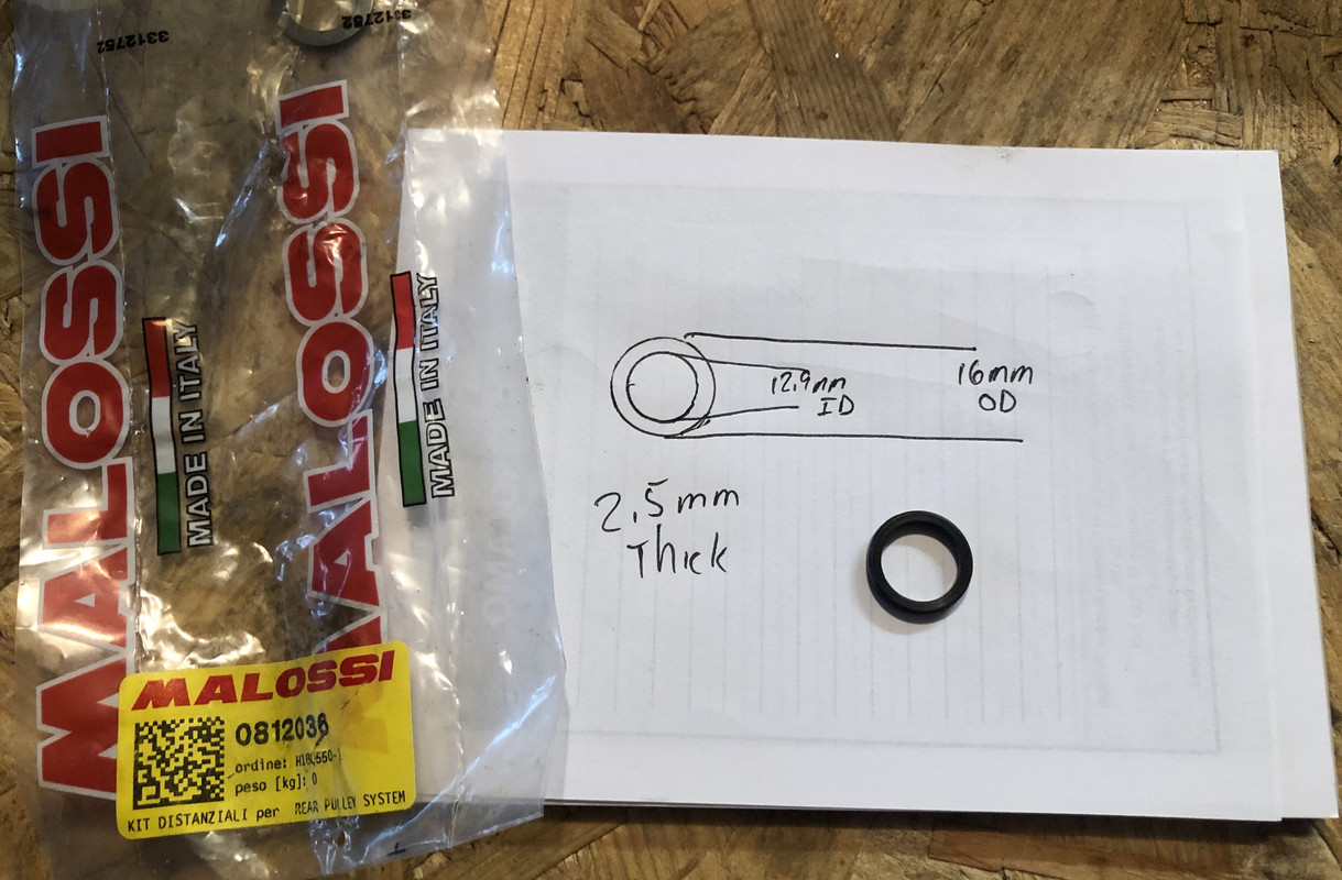

Post by ryan_ott on Oct 27, 2019 10:17:33 GMT -5
The Malossi shim kit is perfect if you happen to be ordering other parts throw one in the cart. The idea is just to keep the pulley from contacting the transmission cover. The dimensions are: 16mm OD 12.9mm ID 2.5mm thick ![](https://i.postimg.cc/4yCTYSds/AB944-B49-DE0-B-49-E8-A8-D3-1620065302-BC.jpg) ![](https://i.postimg.cc/NF1vmk9T/C2762419-CFC4-45-AB-B1-F2-51-B6-FE0-B1-BC0.jpg) image url host
Post by Zino on Oct 27, 2019 12:45:48 GMT -5
Thanks The pictures helped alot I was going to shim out from the transmission case and that did not seem right Being up close to the bearing seal .
