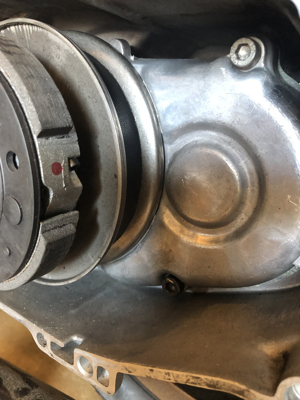

I got the 750mm belt today and also tried a 751mm I found and they are both too short to use this 122mm pulley. The vendor I picked up the TD from offered a $25 credit to help discover the proper belt length and offered to send me a 757mm for free. Hopefully that’ll be the ticket but I may still need more length. The 757mm was found on early Aerox from my search and is tough to come across in the states for some reason. My next choice may be a 764mm. 750mm Polini
Post by benji on Mar 9, 2019 22:00:31 GMT -5
I have 2 predictions;
1: the belt will probably be the 764mm or longer. 2: the belt will be so long it will take some tuning to make it sit right in the OEM vario.
Have you tried going wider?
Post by ryan_ott on Mar 9, 2019 22:11:20 GMT -5
Maybe but I’m doing the hard part and the next guy can pick up the $75 pulley and a belt and call it good.
I’m running a Polini variator which when I originally installed it took some effort. Nothing is ever bolt on and go. I think the757 is stock Aerox lengthand the 764 is a longer for stock. Kind of the difference between a 738 OEM and a 750 on the Zuma. I’ll do some more research before I commit to a free belt.
