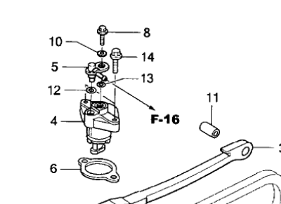

Post by dankhill on Nov 15, 2019 8:38:49 GMT -5
![](https://i.postimg.cc/sgLrkwGd/06-cam-chain-tensioner-diagram.png) So do I just need part #4 on this diagram, or do I need the whole fam damnily (#s 4,5,8,10,12,13,14)?
Post by Happypancake! on Nov 15, 2019 8:46:29 GMT -5
While thing. I may have one. I’ll check later today.
Post by Happypancake! on Nov 15, 2019 8:46:45 GMT -5
Whole

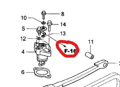

Post by dankhill on Nov 15, 2019 14:31:07 GMT -5
![](https://i.postimg.cc/cLb6hL6B/06-cam-chain-tensioner-diagram-LI.jpg) Where does this connect to? ![](https://i.postimg.cc/Y93HXdbB/05-metro-cyl-head-cover-LI.jpg) Does it go in the reed valve? I plan on plugging/blocking that off for my new intake... Or - does it just intake from atmosphere?
Post by Happypancake! on Nov 15, 2019 15:13:08 GMT -5
Top one: tube to a small filter
Bottom: cap / plug. It’s just the pair valve . Not needed.

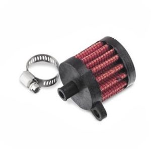

Post by dankhill on Nov 15, 2019 16:01:36 GMT -5
![](https://i.postimg.cc/Mp3cYMwd/Filter-Small.jpg) One of these bad boys?
Post by Happypancake! on Nov 15, 2019 16:24:25 GMT -5
![](https://i.postimg.cc/Mp3cYMwd/Filter-Small.jpg) One of these bad boys? yup

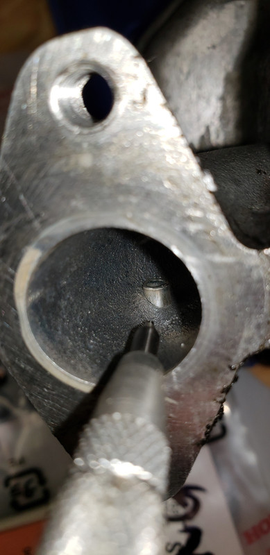

No worries! The whole kit and caboodle is only $74 (including the shock mount bushing located in the transmission case). Pics below \/ ![](https://i.postimg.cc/wvSyK7jg/20191114-181017.jpg) ![](https://i.postimg.cc/9fkzTrTZ/20191114-181023.jpg)

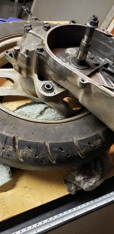

Post by dankhill on Nov 18, 2019 21:19:43 GMT -5
![](https://i.postimg.cc/bvS7H8J3/20191118-201400.jpg) Crankshaft assembly and misc gaskets came in today!
